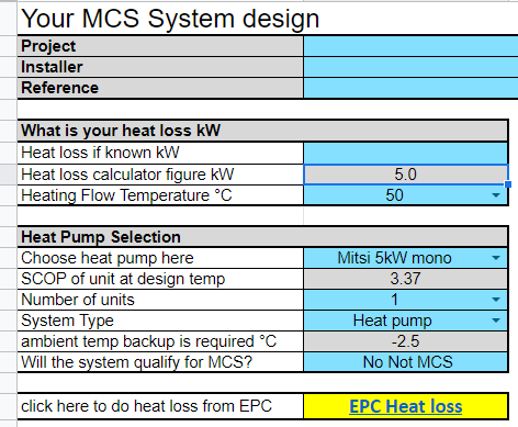

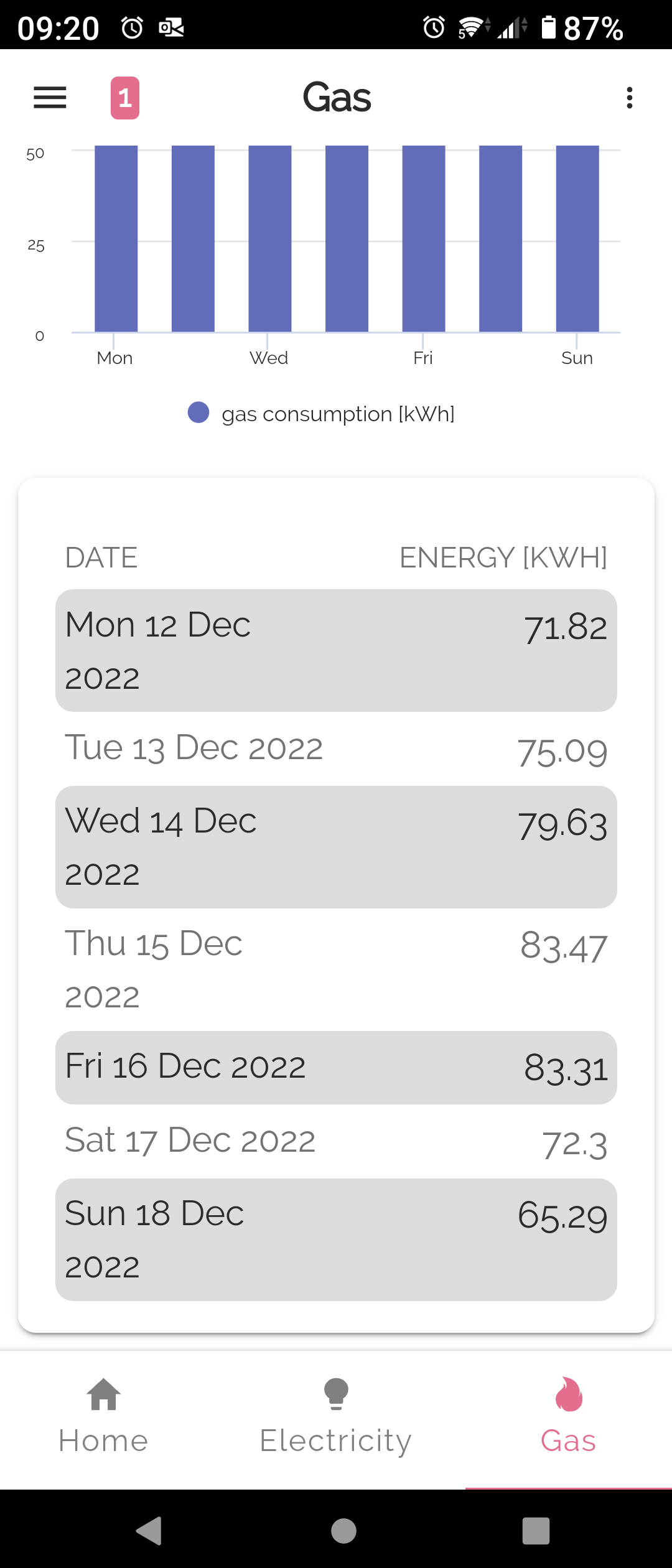

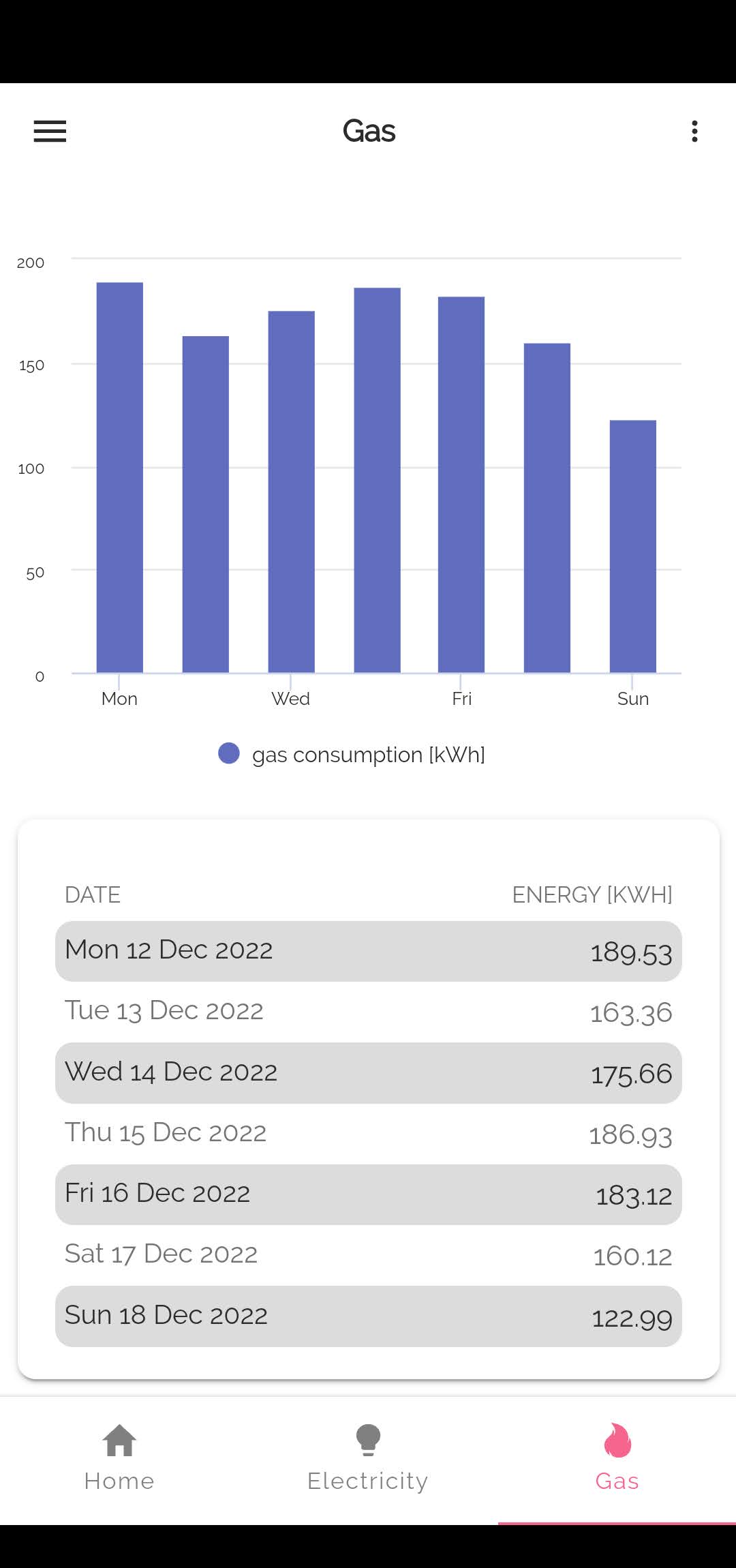

Bashers Posted February 16, 2023 Posted February 16, 2023 I've been looking at a heat pump and sizing it based on the actual gas used to heat my house. Am i being stupid and this is real world data irrelevant as suggested by the heat loss calculator floating around? I've filled out as best i can, and over estimated the dreaded over-garage ensuite thats built to air change standards from the mid 16th century, not sure why they bothered with the window, but i digress. Its suggesting i need 5.3Kw per hour every hour during the coldest times. My actual usage during the coldest days of 2022 were 83Kw/day, or 3.45Kw/h If most installers are using the vastly rounding up figures before adding to the sheet, then overestimated figures on these sheets, then adding a pinch of salt and upgrading to the next bigger ASHP, i'd be on a totally unneccessary 12kw heat pump, whereas the 5kw unit, "flat out" would just about cut it.
JohnMo Posted February 16, 2023 Posted February 16, 2023 Your not comparing apples with apples. Your daily usage is measured in kWh and is affected by the outside temperature, if it is warmer than -2.5 outside your heat losses will be lower - so less gas used. Your gas consumption also incudes DHW. The spreadsheet is calculating the heat power required on the coldest day -2.5, expressed in kW. So if the outside temp was at -2.5 for 24 hrs, you would require a heat input power of 5kW to keep a stable temp inside, so you would use 120kWh of energy that day
Bashers Posted February 16, 2023 Author Posted February 16, 2023 (theres no hot water in the calculation or the gas usage as thats on a seperate standalone water heat pump.) i believe am comparing correctly. the google sheet shows me what the house (possibly) loses in one hour, 5kw, on the coldest day the gas usage is what is used to correct that heat loss in 24 hours, 83kw, including inefficiences, on the coldest day when we had -10° so 83 kw divided by 24 gives me 3.45kw per hour does it not.
SteamyTea Posted February 16, 2023 Posted February 16, 2023 (edited) W is power, a joule per second. The joule is the SI unit of energy and can be converted to Wh by multiplying by 0.0002777778 A kWh is 1000 [the k] multiplied by W [watt] multiplied by time in hours [h]. I think you are getting confused with kW and kWh. There is no kW/h, or kW per hour. On 16/02/2023 at 09:59, Bashers said: 83 kw divided by 24 gives me 3.45kw per hour does it not. Expand No it gives a power of: 83 [kWh] / 24 [h] = 3.5 kW (to 1 decimal place) That is the power that the heater is giving out, on average, for 24 hours. kWh / h the h [hours] cancel out to leave the kW, the power. Edited February 16, 2023 by SteamyTea
JohnMo Posted February 16, 2023 Posted February 16, 2023 Leaving aside the units being all messed up - if you need a 3kW or 6 kW ASHP at -2.5 you most likely end up with the same unit, once you start looking the actual performance at low temps, as not all manufactures rate their units the same, some will say the unit is 6kW, but at -7 only produces 3kW other will say 6kW but produce 6kW at -7.
