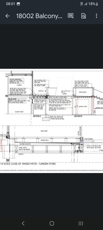

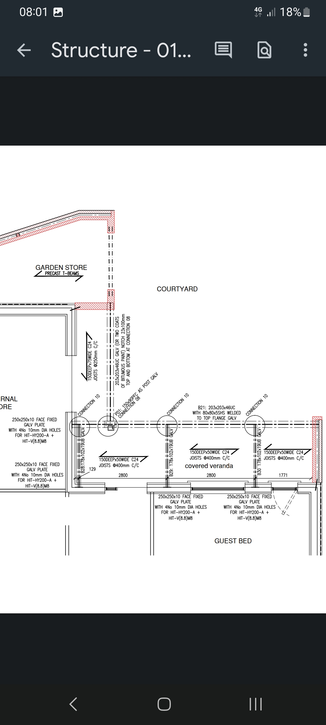

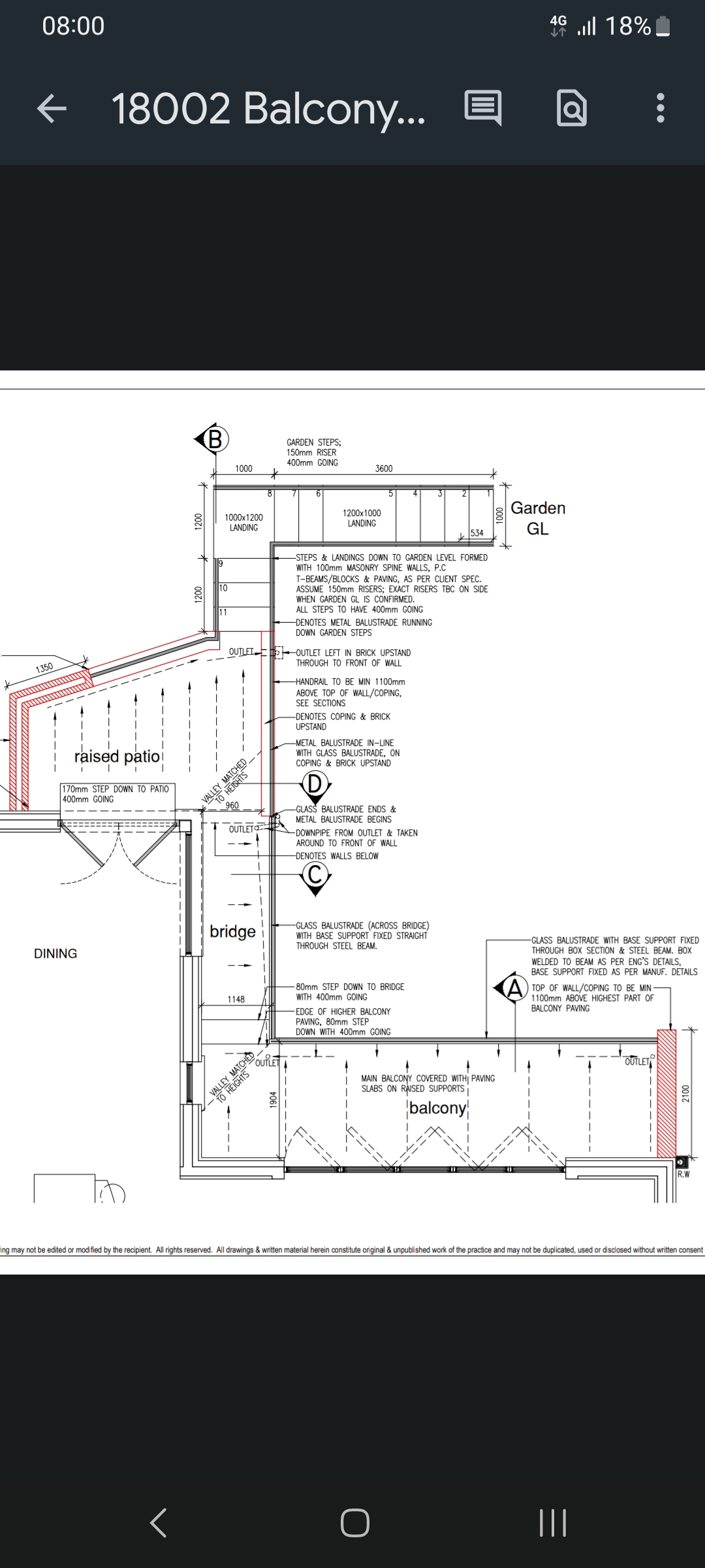

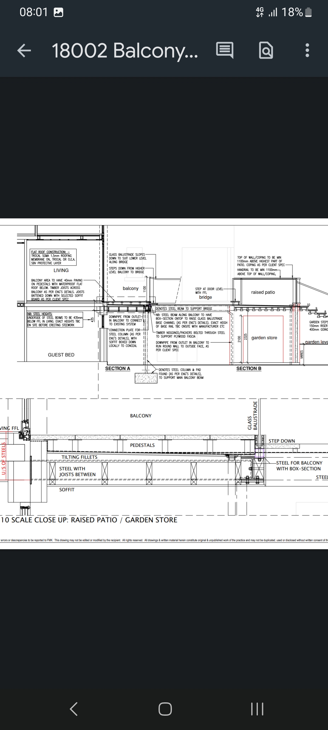

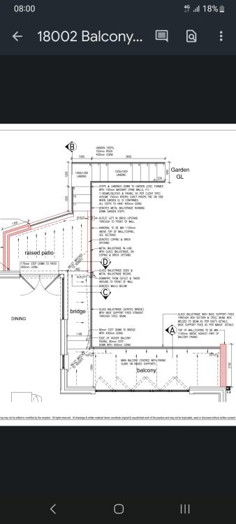

Conor Posted February 14, 2023 Share Posted February 14, 2023 My SE has specified 150x50mm C24 joists for our balcony. I can't find any treated C24 timber locally, I'm sure I could get it as a custom order from a mill, but I've neither the time nor money. I can't find a definitive strength difference or loading table to compare C16 vs C24... and I've not heard back from the SE. Is there any general rule I can follow when substituting C16 for C24? I can get 200x50mm C16 no bother.... Thanks Link to comment Share on other sites More sharing options...

Gus Potter Posted February 14, 2023 Share Posted February 14, 2023 11 hours ago, Conor said: My SE has specified 150x50mm C24 joists for our balcony. Good question here @Conor Lot's of good info from other members. 2 hours ago, Conor said: Just got a quote back from Haldane fisher (lbm) for a one off, special order of C24 treated 6x2s... Comes in exactly the same price as their c16. Same stuff, different stamp???!!!! Make no mistake here folks if the mill start forging stamps or anyone they are in deep trouble if caught.. and they will be. With a bit of experience you can tell the difference between C16 and C24 pretty quicky The same price is probably more due to price point and stocking levels. C24 is denser.. has more cellulose and less air. I can see how folk may think they are buying the same thing just with a different stamp. For a while you had to pay more for S355 steel than S275.. but the same steel meet the requirement for strength and ductility in both grades.. so the same material could often be dual certified but with the different stamps.. S355 commanding a premium... cynisism developed! But there is definitly a difference between C16 and C24 that you can pick up on as a lay person. 2 hours ago, saveasteading said: They will either simply change the input to their design programme, or look at span tables. Sometimes its not that simple as the connections stop working. If you take a Simpson Strong Tie connection the declared capacity is often based on C24.. reduce that to C16 and the connection can then fail at the nails. 11 hours ago, Conor said: for our balcony. Please be careful here.. especially if it has any form of cantilever.. If you want what about posting a few drawings and you'll maybe get some targeted advice? Link to comment Share on other sites More sharing options...
Conor Posted February 15, 2023 Author Share Posted February 15, 2023 11 hours ago, Gus Potter said: Please be careful here.. especially if it has any form of cantilever.. If you want what about posting a few drawings and you'll maybe get some targeted advice? When I say balcony, it's actually a beast that's going to drain the last bit of cash we have out of us!!! I'm getting the C24 and not deviating from the drawings... after all they cost me £1500. It's all essential as we've no access to the garden from our ground floor, and I eliminated the cheaper option of an exposed timber balcony a long time ago. Link to comment Share on other sites More sharing options...
