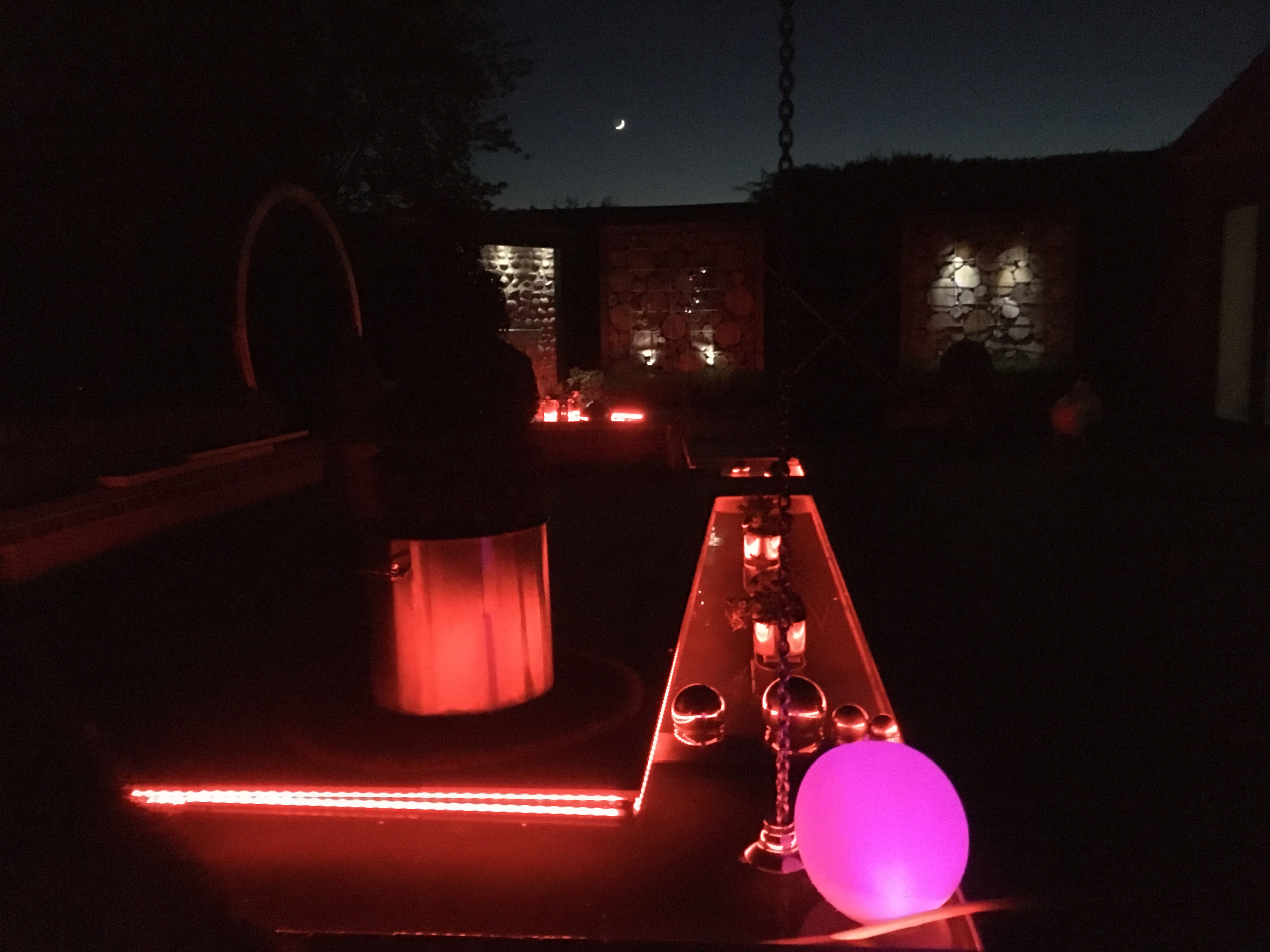

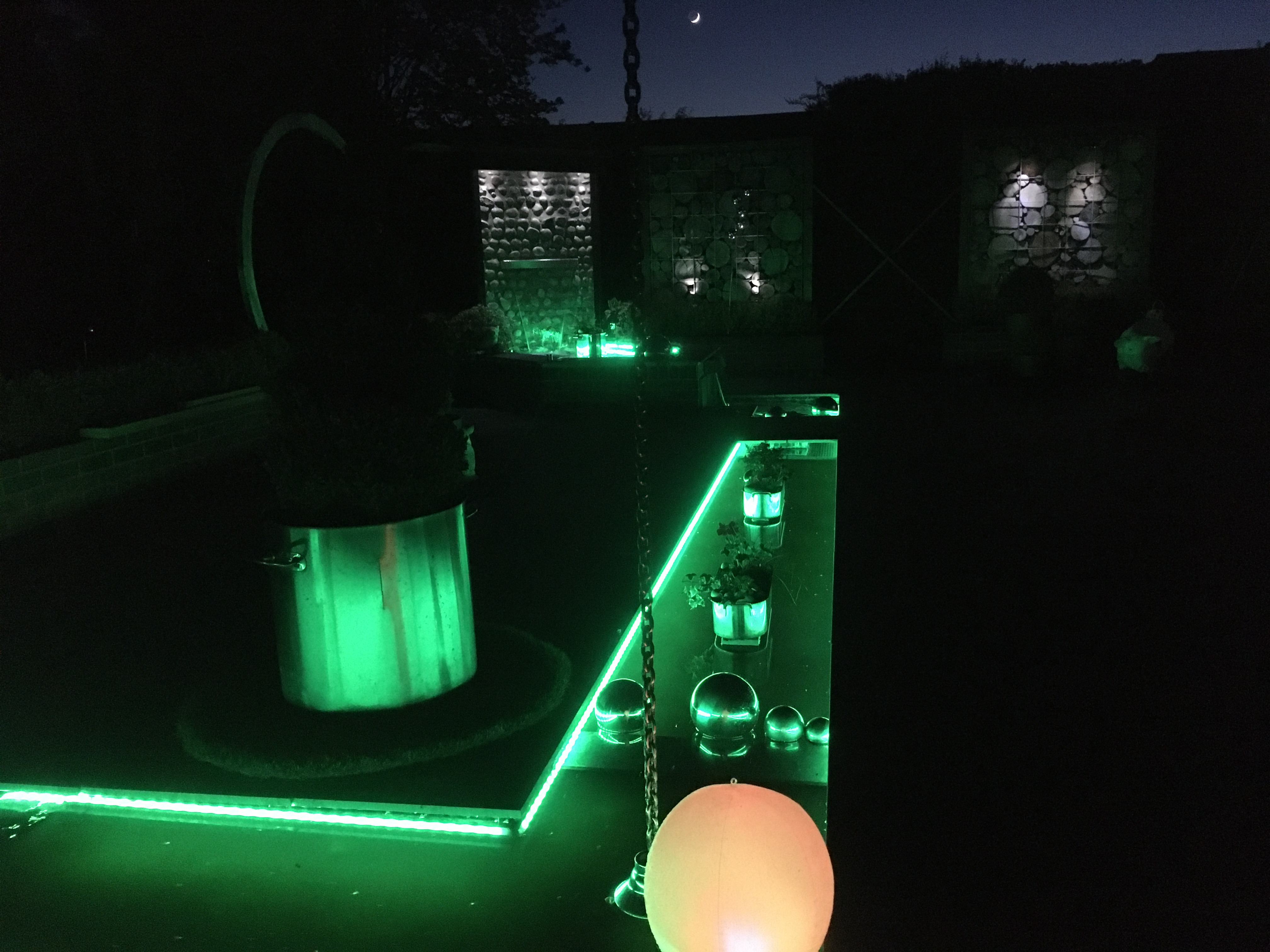

Canski Posted February 14, 2023 Share Posted February 14, 2023 I used these for some garden LED's they make them to measure and are very helpful. https://taylorlighting.co.uk Link to comment Share on other sites More sharing options...
