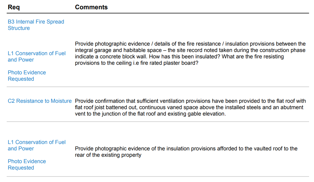

  1. 1 ) B3/L1: Fire resistance/insulation from garage to habitable space (kitchen) : Is there any minimum requirements of fire/insulation (REI30/min. k/m2w) here? or will thermoblock/plasterboard be sufficient. With regards to this insulation / fire protection ... Will the BCO be expecting the insulation/fire protection to be on the "inside" of the property. i.e. to prevent the spread of a fire FROM the garage to the house. or the other way. FROM the house into the garage? If I do as planned. it would only add protection of a fire in the garage TO the house?

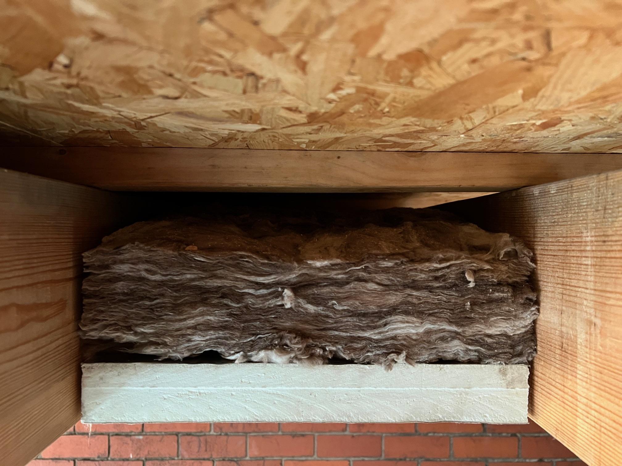

  2. 1 ) B3/L1: So I will need to insulate more. Rockwool suggests 120mm mineral wool to achieve 0.3W/m2K in this construction to get BCO to sign off. 3) 100mm PIR was installed. The ceiling has 100mm PIR and also 120mm rock wool: My problem is, that I dont have any photos, specifically in the vaulted section (I asked the Mrs to take pictures of this) … and now I am plastered painted/finished core cutting for me could be messy not knowing where the rafters are etc. I only need photos.
  3. Hi all, I have had recent final inspection notice from Building Control: I have 4 topics listed to resolve before April 10th. (Only 3 below, but one was windows to first floor - new windows are to be installed soon) A few Questions for the forum... 1 ) B3/L1: Fire resistance/insulation from garage to habitable space (kitchen) : Is there any minimum requirements of fire/insulation (REI30/min. k/m2w) here? or will thermoblock/plasterboard be sufficient. 2) C2 - I will send pictures of the abutment vents 3) 100mm PIR was installed. (no photos specifically to this part of the roof) Will need to remove some tiles ... Any and all help would be greatly appreciated!

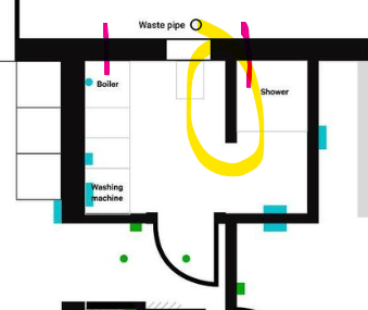

  5. I asked and there is a stud wall encapsulating the shower... They deemed this as "a second" room. At the point I had not installed ANY fans. Only I was to install ONE. This generated the conversation... "Well, you need two" Good point on the more powerful option ... I will ask next time (If not already insstalled)
  6. Hi All, BC have paid me a visit and told me I need to have two external extractor fans in my utility. (Section F) Although, I do not understand why (nor agree with it). I will install the two fans as per the guidance. However! How can I power the two from the same light switch, ceiling rose / isolator switch? I planned the first one as per the attached drawing. However can I simply add a second in the same format i.e. in parallel ... or would they need to be "in series" somehow. (Creditdiydoctor.org.uk) Any guidance would be appreciated. A

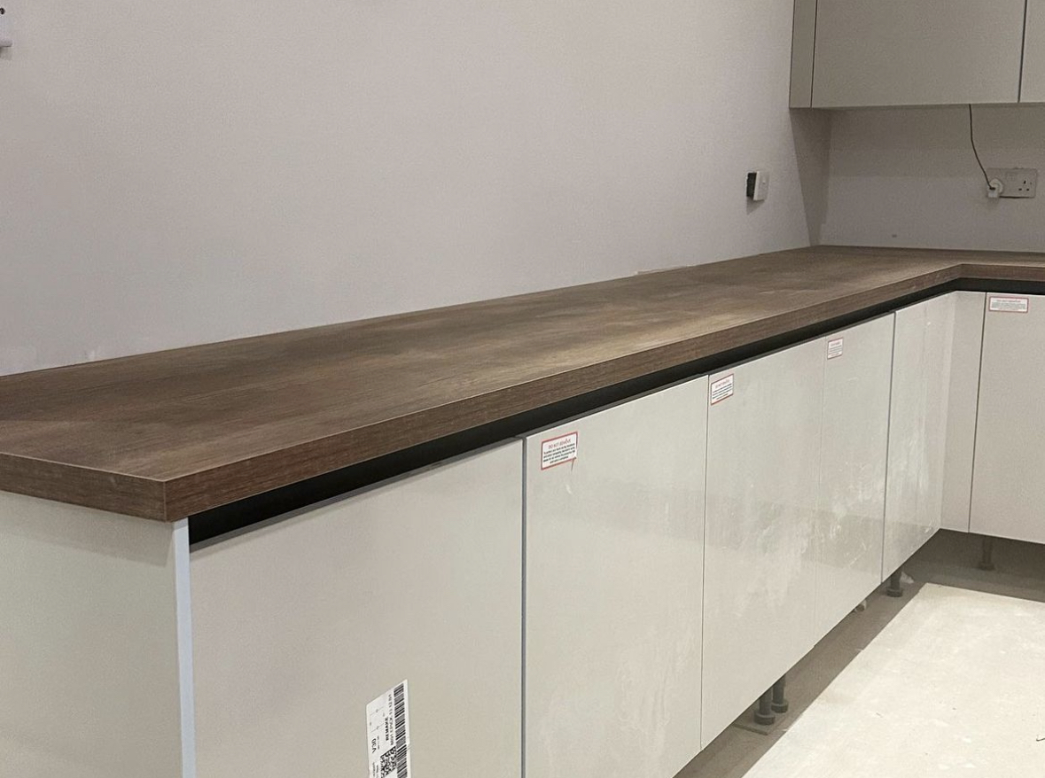

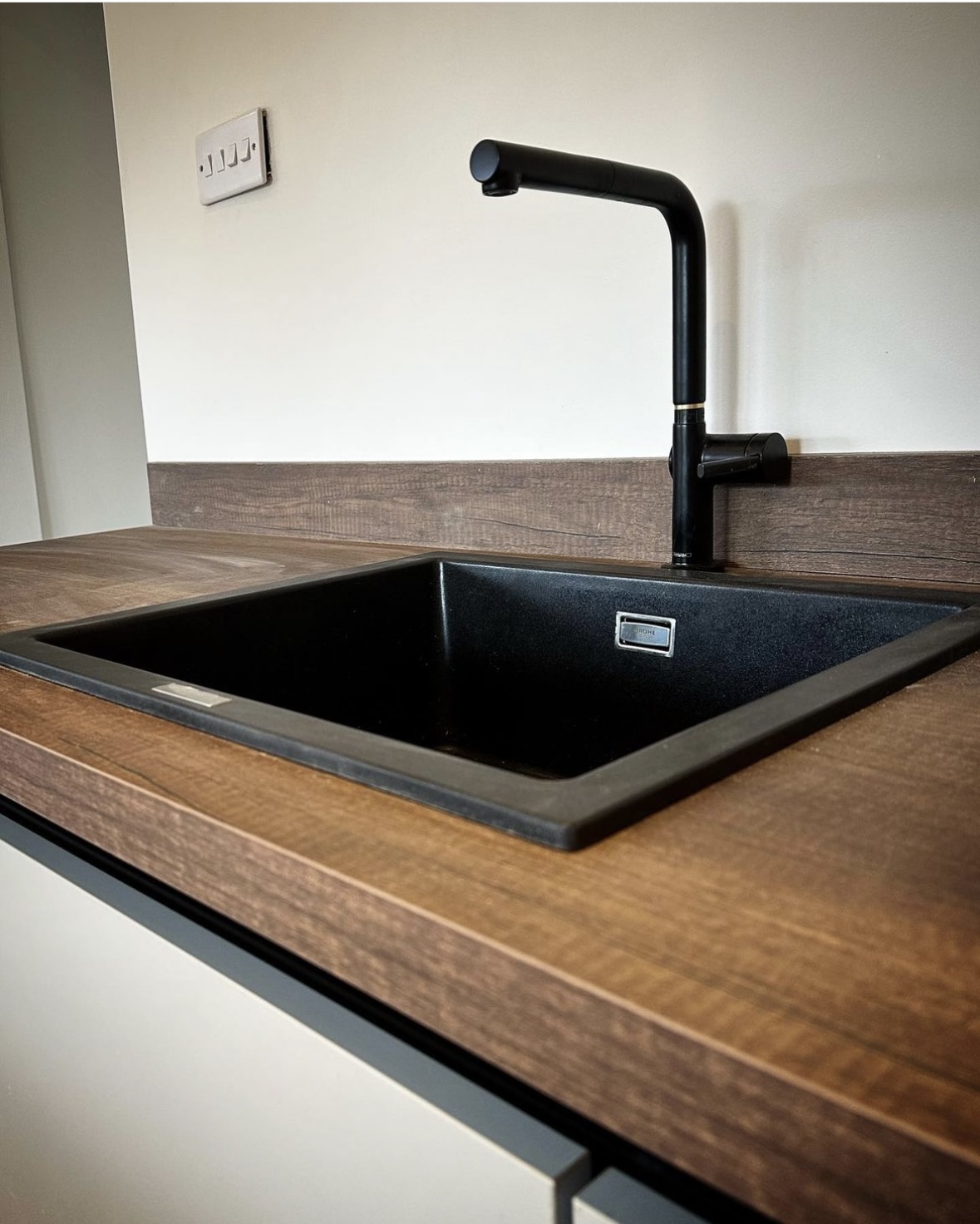

  8. I had a go at routing / fitting worktop together. (all the underside of the front edge is routed out with an aluminium channel ready for the next lot of Philips Hue Light strips. Then making a cut out for sink / taps. Not plumbed in yet, only for the pics. I need to take the work top off a few more times yet for other stuff.

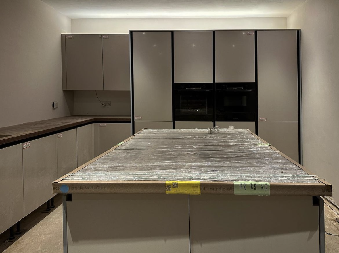

  10. Hey! One consideration I had over looked after buying an "AEG Moon" (not built , however) for a kitchen island. BR informed me it needed to be extracted externally at min. 60 L/s - Check BR Part F - Ventilation.
