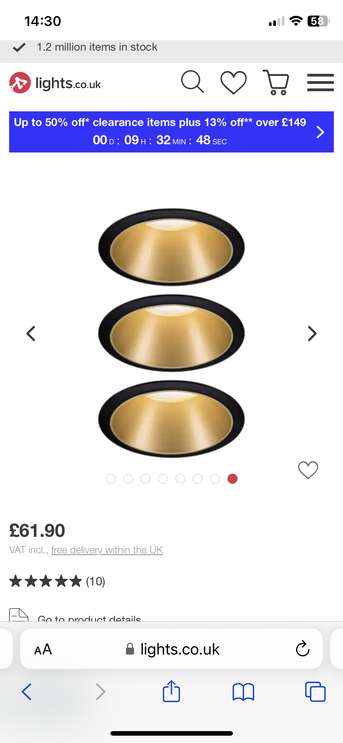

Pocster Posted February 12, 2023 Posted February 12, 2023 Recessed lights I always think of these SWMBO though has been looking at these . As the light is recessed further would they create more of a cone of light and less effective in a large room ?

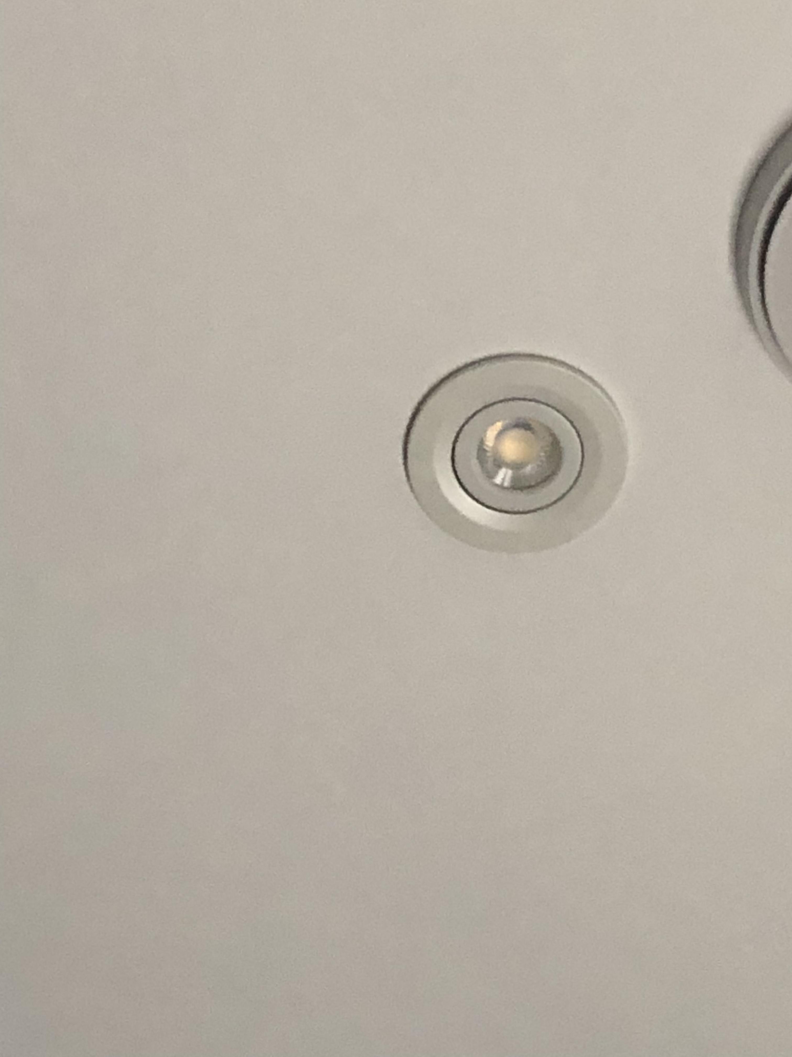

Pocster Posted February 12, 2023 Author Posted February 12, 2023 5 minutes ago, ToughButterCup said: My other half is a little photophobic: she can't stand glare. The light from surface-mounted LEDs almost always cause her slight physical pain. So all our LEDS are recessed about 30mm. There is no more a 'cone' of light with those as with surface mounts: but there is absolutely no glare. In terms of lumen output, I'm not sure if there's a difference between recessed or surface mounted lights. We worked on 5000 lumen in the kitchen and office, a good deal less elsewhere. Yeah we have the ‘normal ‘ recessed in the bedroom ; 1st photo . Without dimming it’s so blinding it actually hurts my eyes . Can’t see what I’m doing in bed .
Pocster Posted February 12, 2023 Author Posted February 12, 2023 Just noticed that those swmbo ones have some funny hold for dimming action . So no good as need to link dimming to ha . Will find something similar .
