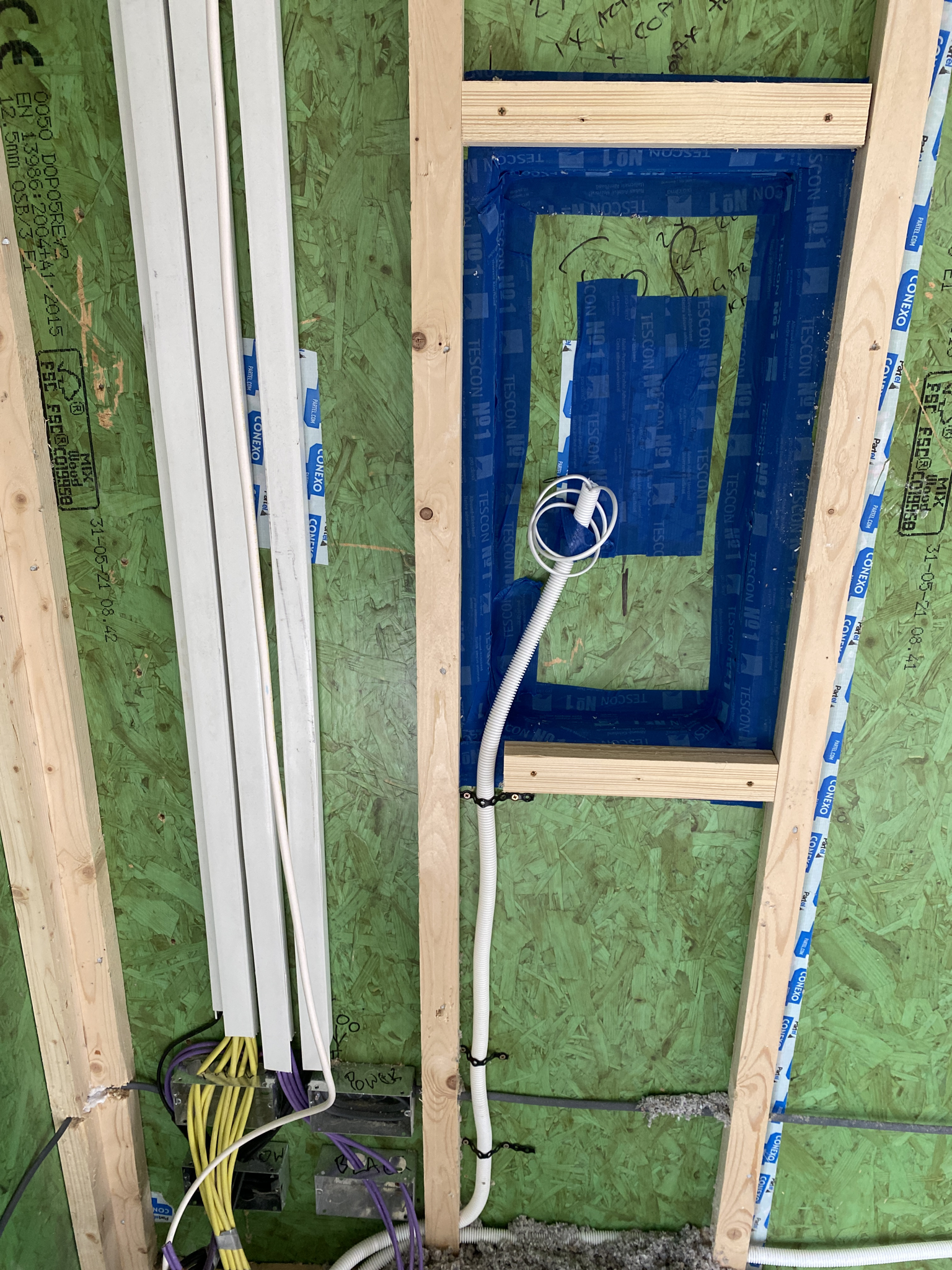

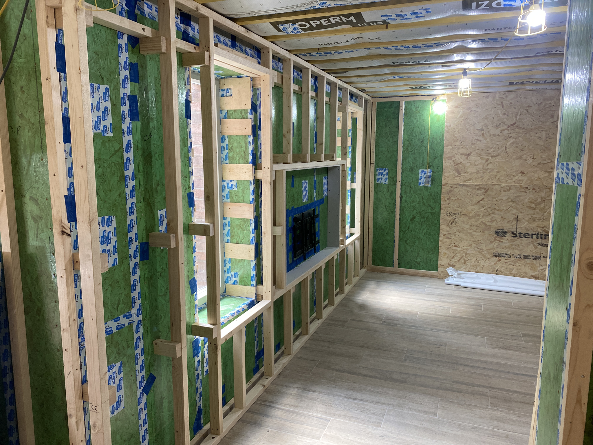

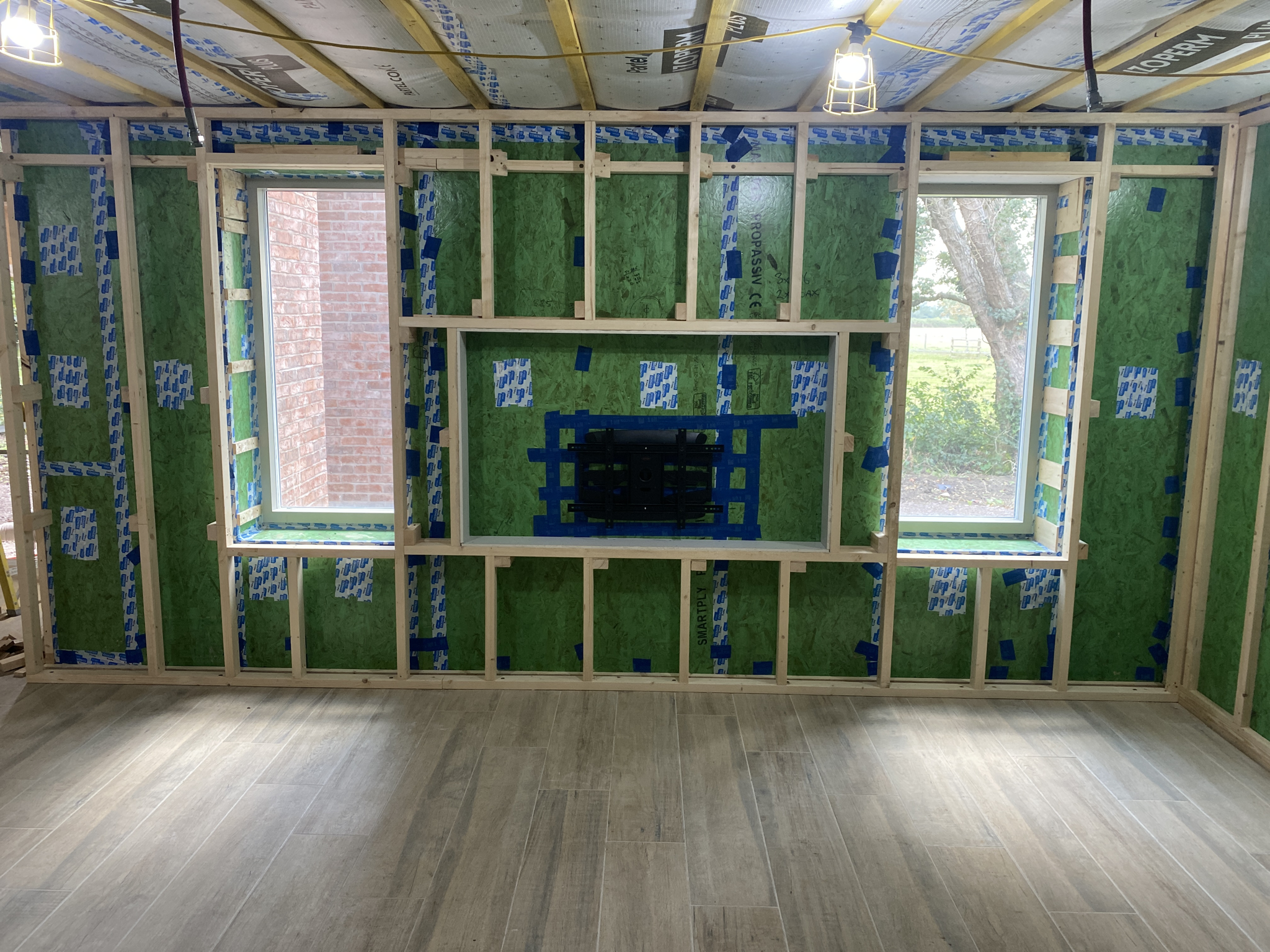

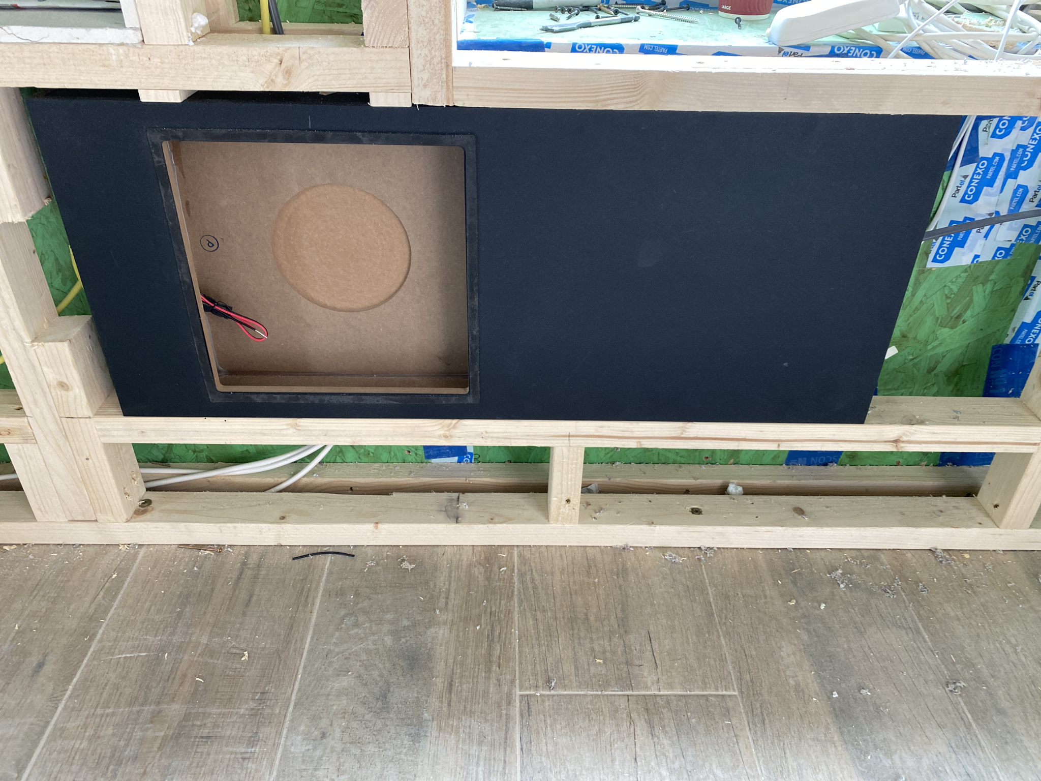

Nickfromwales Posted February 11, 2023 Posted February 11, 2023 57 minutes ago, steveoelliott said: Have you got any pictures? Wall stud framed and TV bracket mounted. Lower studs were cut and altered to fit the sub box hidden enclosures. And rear wall was cut and recessed to allow flush fitting speakers in the TF of the house. Left and right sub boxes installed. Nice. The two sub boxes are where the two locator holes are. Centre in between those, and FL and FR are either side of TV recess. Atmos in the ceilings and away we go. This is for my current clients MBC TF PH build and we’re doing turnkey, so included a cinema room. Because why wouldn’t you if you could? 👍👌😎. 2

steveoelliott Posted February 11, 2023 Author Posted February 11, 2023 5 minutes ago, Nickfromwales said: Wall stud framed and TV bracket mounted. Lower studs were cut and altered to fit the sub box hidden enclosures. And rear wall was cut and recessed to allow flush fitting speakers in the TF of the house. Left and right sub boxes installed. Nice. The two sub boxes are where the two locator holes are. Centre in between those, and FL and FR are either side of TV recess. Atmos in the ceilings and away we go. This is for my current clients MBC TF PH build and we’re doing turnkey, so included a cinema room. Because why wouldn’t you if you could? 👍👌😎. Looks sweet! I’m envious. So the vesa mount here us screwed to ply I presume? Looks like it.

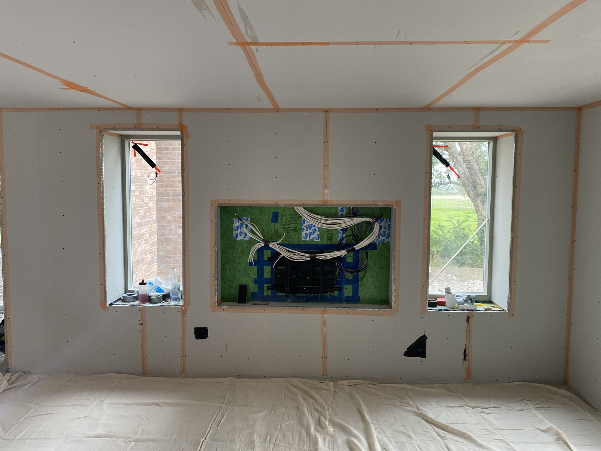

Nickfromwales Posted February 11, 2023 Posted February 11, 2023 (edited) 13 minutes ago, steveoelliott said: Looks sweet! I’m envious. So the vesa mount here us screwed to ply I presume? Looks like it. I cut into the green AT plywood and inserted pieces of 5"x2" where the TV bracket needed the most strength. I then put the off-cuts back in, screwed them to the timbers, and AT taped everything back up. That's an opening that is to take a 65" TV with a 6mm shadow gap all around, when the TV is pushed in flush to the wall ( after cabling up ). Should look the Dachshunds danglies when done. Should sound awesome too. Ignore the bunch of white cables, they're for the various cinema / living / dining / kitchen and landscape lighting, controlled via Quinetic WiFi + RF receivers which are to be hidden up inside the TV wall ( so I can access them for service / replacement etc ). Seemed a good place to put them as the TV can be pulled in / out with ease on that lovely German bracket Edited February 11, 2023 by Nickfromwales I can't spell after one beer ffs 1
