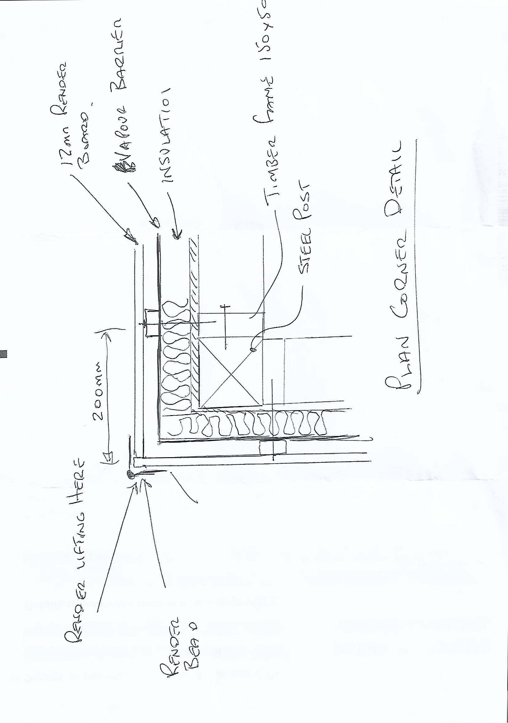

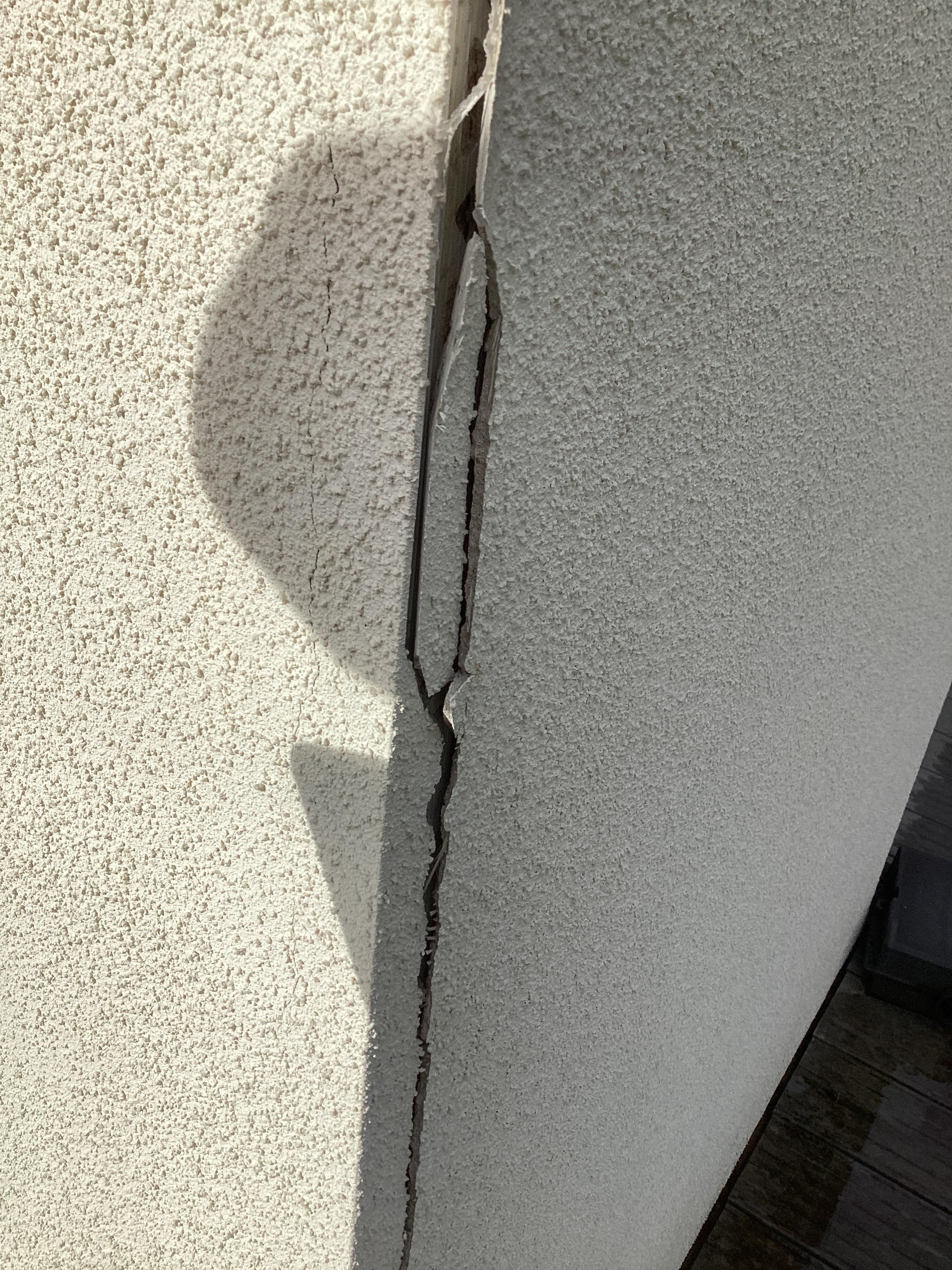

Rich123 Posted February 11, 2023 Share Posted February 11, 2023 (edited) I’ve had my extension rendered for around 2 years. One corner on the front has badly cracked around the corner bead and the render has lifted off by about 4 mm over an are around 200 mm . The render is applied on to a render board which is a magply external BBA board. The thin coat is the Johnson high silicone 1.5 . First issue , Johnson’s advise that the magply isn’t an approved base and therefore thats why the render has lifted, but it’s ok everywhere else . They approve the knauf external board , which is a similar product , cement based board. Second issue , when the board was installed the corner was not battened due to the detail at the corner with a post , therefore the board over sales the batten by about 200 mm , which seemed solid at the time. I’m thinking this may be the issue causing differentIal movement at the joint ? 3. So I can remove the corner panel and replace it with the approved knauf board in that location. I will then batten the corner and reinforce it to stabilise it, but the render will need to be repaired and re sprayed leaving a joint line . Luckily it’s beside a door opening so only about 800 mm either side of the corner, but I’m concerned at cracking between the new and existing render as I will need a joint vertically above the door head about 400 mm. Any thoughts on the above would be appreciated Edited February 11, 2023 by Rich123 Link to comment Share on other sites More sharing options...

Nickfromwales Posted February 11, 2023 Share Posted February 11, 2023 It doesn't look like the mesh is continuously evident, and possibly that the mesh didn't get wrapped around the corner ( in both directions ). The mesh is obvious at the bottom of the pic, but then is not visible / evident from the middle and top ( you can see the broken fibres where the mesh defo was ). What ar the manufacturers guidelines / installation practices regarding mesh at corners / where mesh stops and starts? eg overlap etc. Also consider bonding Conpacfoam or Marmox to the steel, and then bonding AND mechanically fixing it the the timbers. This will give a very solid substrate for the following layers of build up. The floating timbers will be the cause for sure, and there would have been nothing stopping them making a timber L section to cap the external angle and allow opposing fixings for the boards. Just laziness on the installers behalf here I'm afraid vs manufacturers responsibilities ( unless they show this as a permissible detail? ). Link to comment Share on other sites More sharing options...

ADLIan Posted February 11, 2023 Share Posted February 11, 2023 Problem is that magply is not a ‘cement’ board it is based on magnesium oxide. Problems were identified with these ‘MgO’ boards several years ago including not being compatible with some render systems. Several warranty providers, including LABC and NHBC, banned their use. 1 Link to comment Share on other sites More sharing options...

JoeBano Posted February 12, 2023 Share Posted February 12, 2023 That’s poor fixing on the concrete board. Should have been fixed on the corner 150mm spacing with stainless screws. Even a batten horizontally would have been better instead of vertical. I disagree with all the concrete board being the same, I’ve used many different brands some snap with a knife some you need a diamond disc some snap when you look at them. Just poor install not the products. Weber are snakes but still the best product on the market Link to comment Share on other sites More sharing options...
