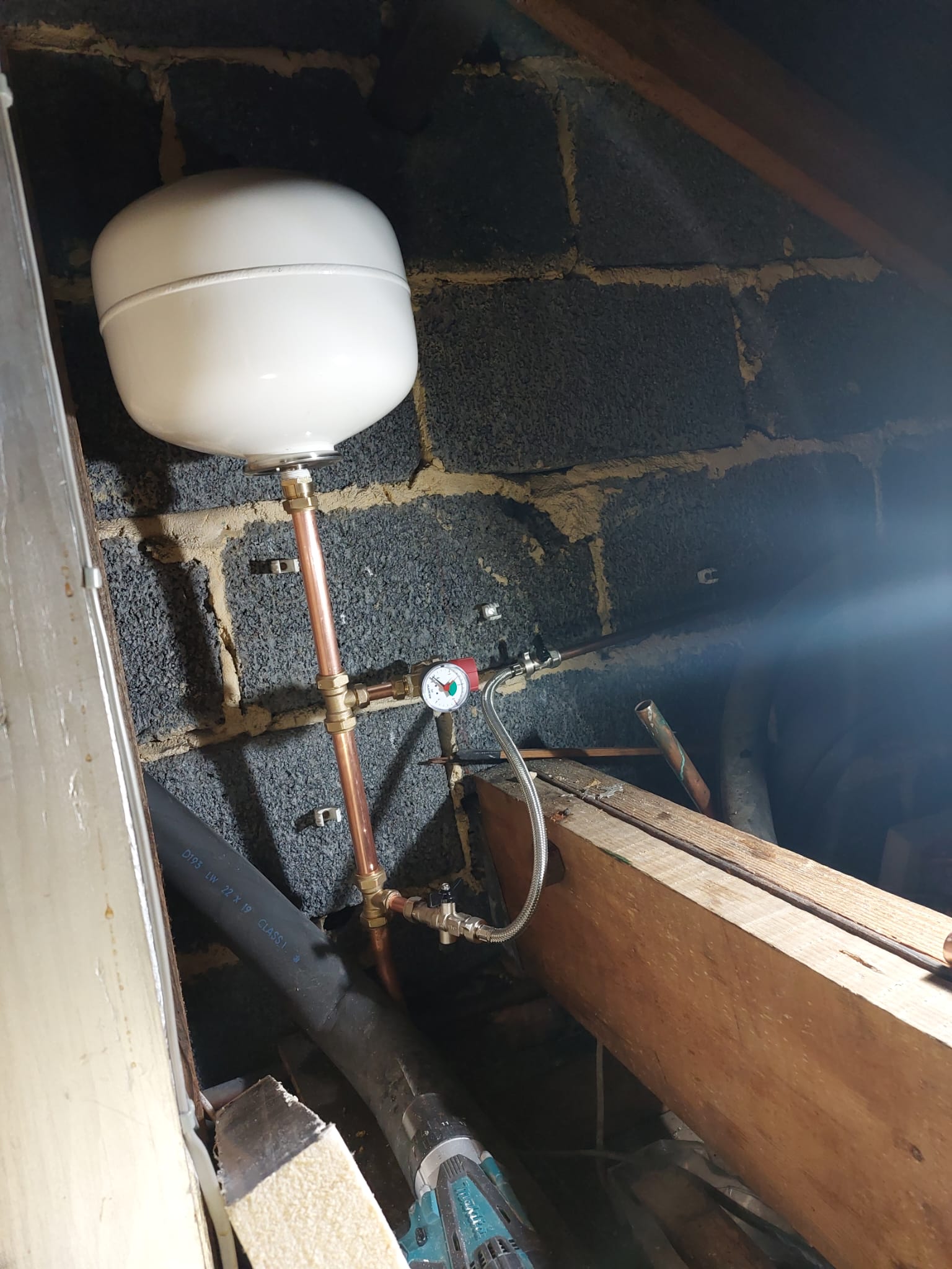

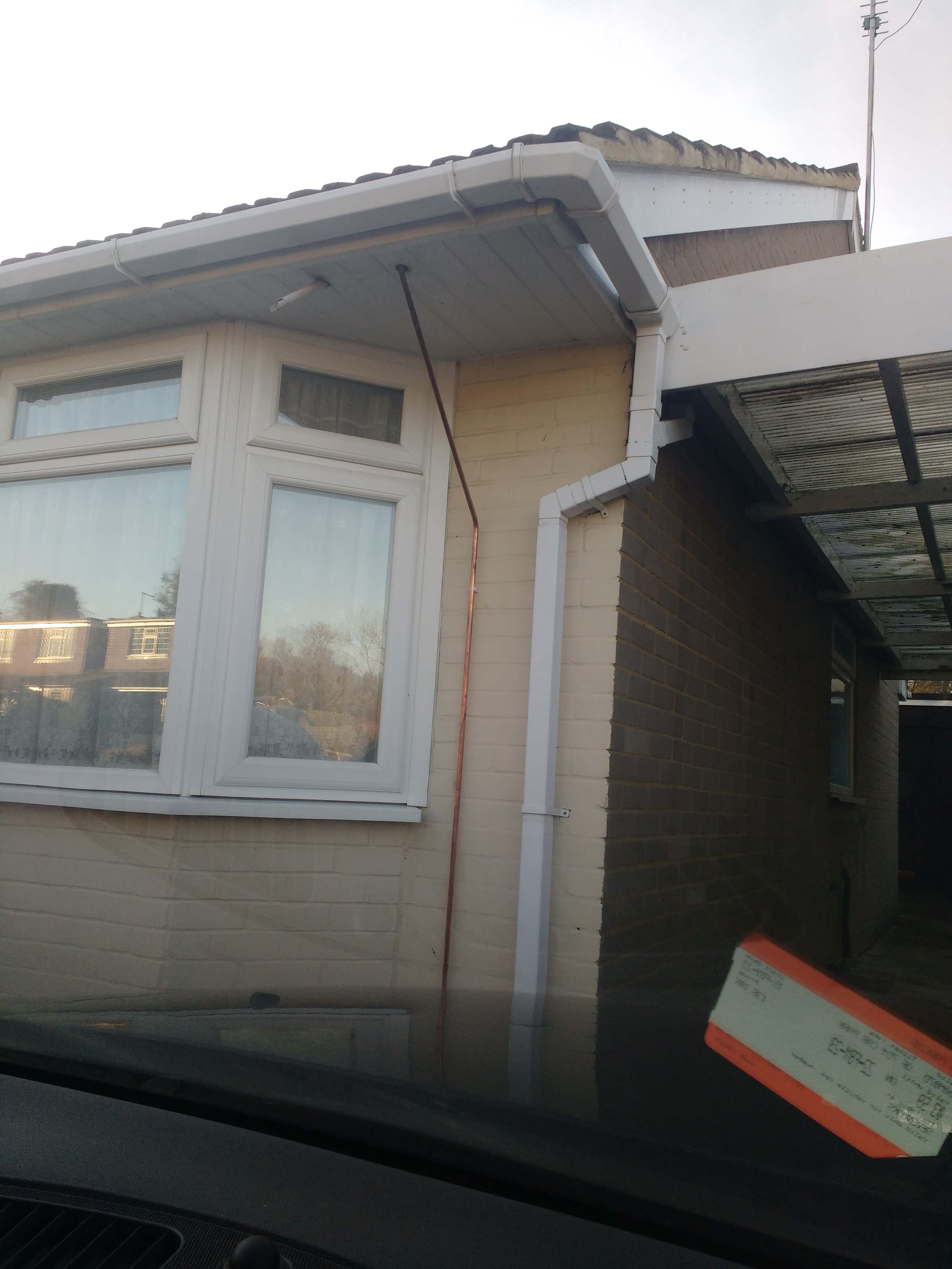

Onoff Posted February 19, 2023 Share Posted February 19, 2023 On 11/02/2023 at 09:53, Nickfromwales said: There are decent fitters out there and you just need to keep looking You can't beat BG. Look at the tidy job they did on my mum & dad's place: 1 Link to comment Share on other sites More sharing options...
Nickfromwales Posted February 19, 2023 Share Posted February 19, 2023 3 minutes ago, Onoff said: You can't beat BG. Look at the tidy job they did on my mum & dad's place: They did similar near me. They love the old / vulnerable clients the most. They only brought a short steps with them, and left 9m of unsupported gas pipe around the side of the house, which they only clipped at the start and the end of the run as they couldn't reach any more of it. They also converted to a combi boiler but failed to realise he was classed as infirm and that they had left him with a risk of scalding via the non-thermostatic shower he used off the bath taps. Absolute wankers. That gas pipe is shocking!! Right in front of an openable window FFS. Get the tossers back to sort it? Link to comment Share on other sites More sharing options...
Onoff Posted February 19, 2023 Share Posted February 19, 2023 17 minutes ago, Nickfromwales said: They did similar near me. They love the old / vulnerable clients the most. They only brought a short steps with them, and left 9m of unsupported gas pipe around the side of the house, which they only clipped at the start and the end of the run as they couldn't reach any more of it. They also converted to a combi boiler but failed to realise he was classed as infirm and that they had left him with a risk of scalding via the non-thermostatic shower he used off the bath taps. Absolute wankers. That gas pipe is shocking!! Right in front of an openable window FFS. Get the tossers back to sort it? The best bit it Dad was a BG pensioner, one of their own you might say. They took the header tank out and replaced with a small pressure vessel to make a sealed system. Link to comment Share on other sites More sharing options...
Nickfromwales Posted February 19, 2023 Share Posted February 19, 2023 Looks like a potable vessel, vs a red heating one? Is it also completely supported by the pipework?! Link to comment Share on other sites More sharing options...
Onoff Posted February 19, 2023 Share Posted February 19, 2023 16 minutes ago, Nickfromwales said: Looks like a potable vessel, vs a red heating one? Is it also completely supported by the pipework?! Haven't looked closely, my brother sent it to me. It's on the CH. Link to comment Share on other sites More sharing options...
Nickfromwales Posted February 19, 2023 Share Posted February 19, 2023 11 minutes ago, Onoff said: Haven't looked closely, my brother sent it to me. It's on the CH. I'm assuming there is a reason that potable are white and heating vessels are red...... I'm also assuming that clip manufacturers stay in business by plumbers buying clips from them and then using them Link to comment Share on other sites More sharing options...
Onoff Posted February 20, 2023 Share Posted February 20, 2023 (edited) Could that pipe be taken out through the gable end then empty into the car port gutter maybe? Then is that something I could do legitimately? Edited February 20, 2023 by Onoff Link to comment Share on other sites More sharing options...
Marvin Posted February 20, 2023 Share Posted February 20, 2023 17 hours ago, Onoff said: You can't beat BG. Look at the tidy job they did on my mum & dad's place: That's one of the worst I've seen! Have I led a sheltered life? Link to comment Share on other sites More sharing options...
