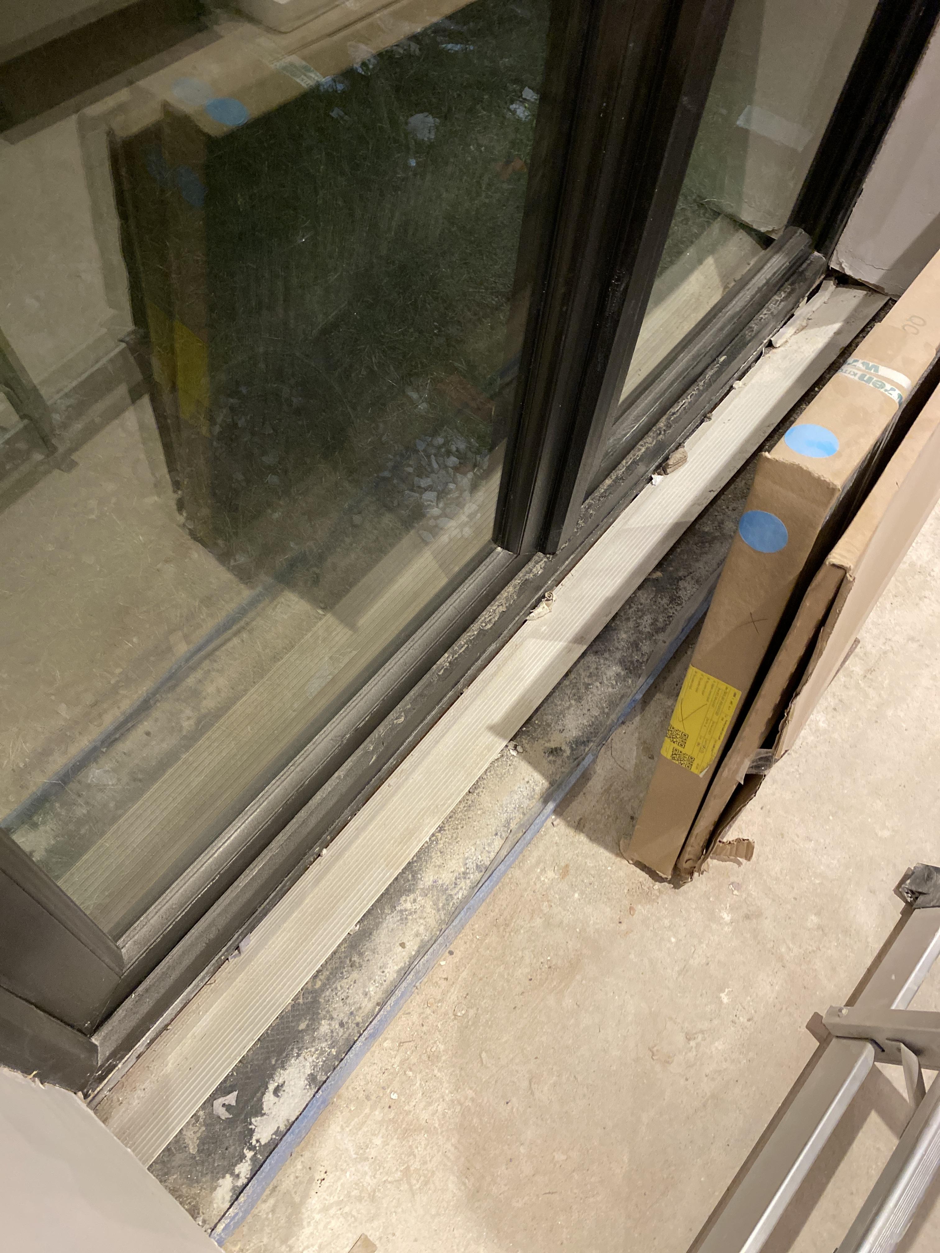

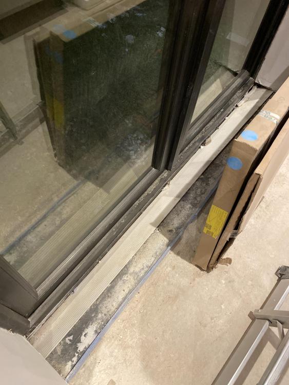

AdamL Posted February 8, 2023 Share Posted February 8, 2023 (edited) Hi All, Adam here, New to the forum. Currently undertaking a small extension in Manchester ("currently = past 2.5 years") Hope to find some BC answers / ask some silly questions! I specifically need some immediate advise/threads which include detail "external door thresholds for block-cavity-brick" construction junction drawings / detail A Edited February 8, 2023 by AdamL Link to comment Share on other sites More sharing options...

MikeGrahamT21 Posted February 8, 2023 Share Posted February 8, 2023 14 years and counting! lol Heres a detail i've found: https://polyfoamxps.co.uk/wp-content/uploads/10-Bel-DPC-Wall-susp-fl-junc-detail-showing-PF-at-door-threshold-Option-1.pdf 1 1 Link to comment Share on other sites More sharing options...
AdamL Posted February 9, 2023 Author Share Posted February 9, 2023 (edited) Thank you all for the warm welcome! 18 hours ago, MikeGrahamT21 said: 14 years and counting! lol Heres a detail i've found: https://polyfoamxps.co.uk/wp-content/uploads/10-Bel-DPC-Wall-susp-fl-junc-detail-showing-PF-at-door-threshold-Option-1.pdf This looks v similar to what I have (thanks again) However where there is the (3) Polyfoam. I have a cavity (yes, i can push some polyfoam/similar in the cavity. Currently there is only a "cavity closer" placed to cover the gap. As the door is fitted to the external brick leaf and screed are is poured only to the internal block leaf there is NO strength over the ~80mm cavity. My concern here is the strenght of the flooring in that section if you stand on it... it would likely cave in after a short time / be a problem with the flooring finish Edited February 9, 2023 by AdamL Link to comment Share on other sites More sharing options...
MikeGrahamT21 Posted February 9, 2023 Share Posted February 9, 2023 Hi Adam, for over the cavity take a look at compacfoam at Green Building Store, in fact I think someone was selling some on here in the marketplace. 1 Link to comment Share on other sites More sharing options...
AdamL Posted February 14, 2023 Author Share Posted February 14, 2023 On 09/02/2023 at 16:40, MikeGrahamT21 said: Hi Adam, for over the cavity take a look at compacfoam at Green Building Store, in fact I think someone was selling some on here in the marketplace. Looks like the right product, thank you. I suppose I would need a very strong mechanical fixing ... somehow!? Link to comment Share on other sites More sharing options...
MikeGrahamT21 Posted February 14, 2023 Share Posted February 14, 2023 53 minutes ago, AdamL said: Looks like the right product, thank you. I suppose I would need a very strong mechanical fixing ... somehow!? I got a sample of this stuff ages ago and it’s rather crazy, you can screw into it like timber. you should be able to fix it to the inner leaf, either with metal screw and washer, or you could use a shortish plastic external wall insulation fixing like these: https://www.toolstation.com/fischer-dipk-insulation-render-fixing/p42435?utm_source=googleshopping&utm_medium=feed&utm_campaign=googleshoppingfeed&mkwid=_dm&pcrid=&pkw=&pmt=&gclid=CjwKCAiA_6yfBhBNEiwAkmXy5wOfdWzUTcYgnzaAqhy3S3hBgsFY4-7cYfyyzzq_fauWaT1pXgvM9RoCTeQQAvD_BwE&gclsrc=aw.ds you may well need to look for a smaller pack size tho!! 😂 1 Link to comment Share on other sites More sharing options...
AdamL Posted February 15, 2023 Author Share Posted February 15, 2023 17 hours ago, MikeGrahamT21 said: you may well need to look for a smaller pack size tho!! 😂 Hmm, yes 200 fixings might be a little overkill (or very secure) My problem is if I push the 75mm compaqfoam into the 80mm cavity I can't get a fixing and an impact driver in the gap (gap would only be ~5mm) I guess i'll have to put a batten/brackets "underneath" for the compaqfoam to sit on top of ... should give enough support 🤞 Link to comment Share on other sites More sharing options...
MikeGrahamT21 Posted February 15, 2023 Share Posted February 15, 2023 Ahh i get what you mean, i thought you were floating this over the top to get rid of both the gap and the thermal bridge from the internal blockwork. How about something a little bit like this: https://www.ebay.co.uk/itm/175408005770 1 Link to comment Share on other sites More sharing options...
