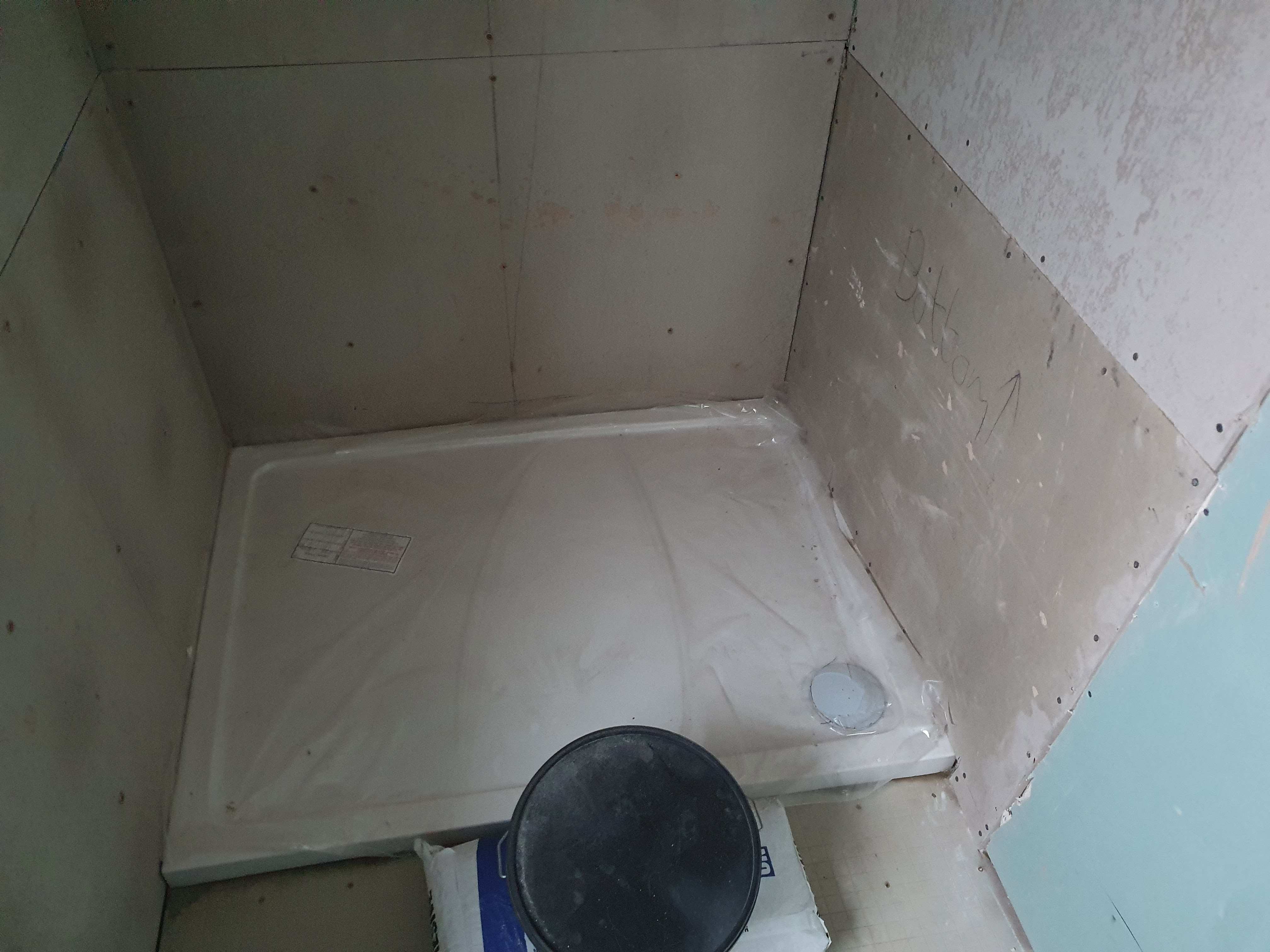

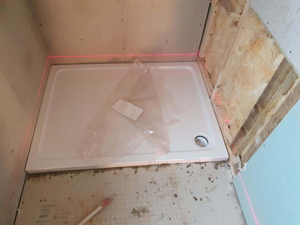

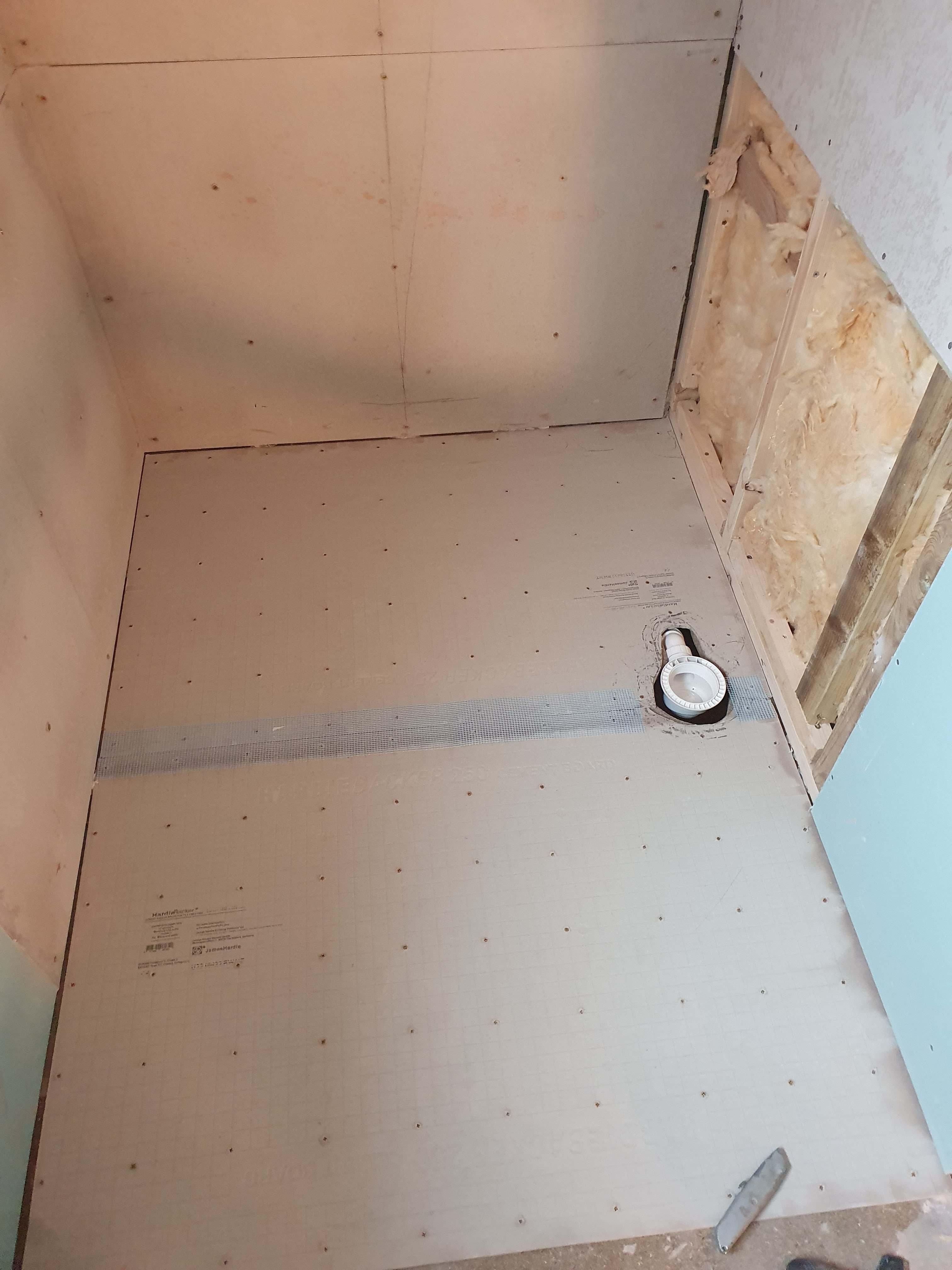

Moonshine Posted February 3, 2023 Share Posted February 3, 2023 (edited) I am going round in circles about fitting these damn shower trays, basically i have 22mm caberdek and going to fit a shower tray on it (the instructions just say 8mm mortar above it to bed into, other people i have spoken to say i need 6mm of hardie backer above the chipboard first (screwed down) Go on then do your worst to how does BH think a shower tray should go down? (not in this case the walls are fibre cement and i will be adding a tanking layer to it, and a seal tape at the joint to the tray) Edited February 3, 2023 by Moonshine Link to comment Share on other sites More sharing options...

Moonshine Posted February 4, 2023 Author Share Posted February 4, 2023 Decided to go 6mm tile backer screwed down, then sand and cement as per the instructions. Surprisingly it went o.k (glass lifters were a saviour!!!) though need to test water through it Link to comment Share on other sites More sharing options...
