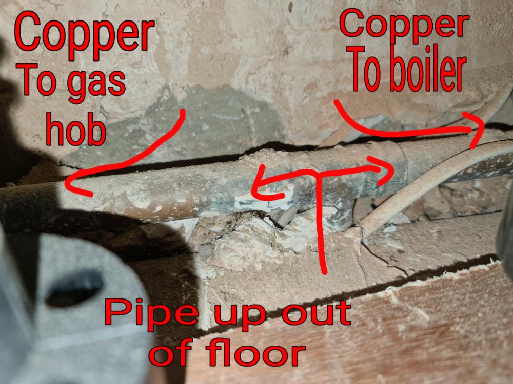

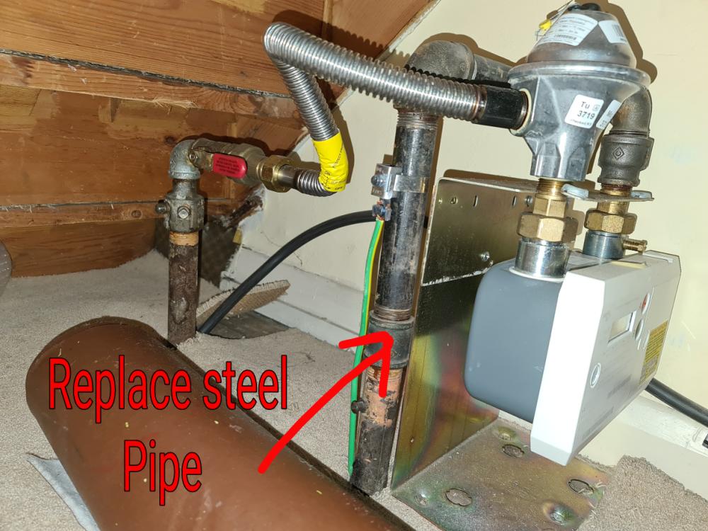

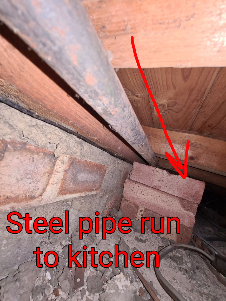

DaveAF Posted January 31, 2023 Posted January 31, 2023 (edited) Hello. Our gas boiler insurer no longer covers our terraced home heating system because the gas pipe running from our meter to the kitchen is steel. It runs under our wooden ground floor and its length is about 15 feet with another couple of feet for the angled bits around the meter. Would having this steel pipework replaced with copper be very expensive? Our house is a 1930s terraced build. Please see the pictures. The last picture shows the gas pioework where it enters the kitchen and splits to the gas hob and the boiler. We have an option not to replace the pipe and get insurance with another insurer who dosent exclude steel pipework. The difference between the 2 insurers policies is £170 and £565. Any thoughts are very welcome. Thanks David Edited January 31, 2023 by DaveAF Missing information

DaveAF Posted February 1, 2023 Author Posted February 1, 2023 42 minutes ago, dpmiller said: so this isn't really insurance, it's boiler breakdown cover and they want to make some money out of you? I guess so. But they haven't offered to change the pipe to copper for us "for a price" . Our system just failed their eligibility check. Would changing the pipe from steel to copper be very expensive?

DaveAF Posted February 1, 2023 Author Posted February 1, 2023 19 hours ago, Conor said: What does the insurance cover and do you need it? It covers breakdown of our boiler and its controls. The boiler is 15 years old and has been maintained since year 1 by british gas. Our basic level british gas insurance quote for this year had gone up to £565 and Homeserves quote was for about £170. The boiler inspection revealed the steel pipe from the meter to the kitchen. Copper pipes after the kitchen. Would it be expensive to replace the steel with copper?
DaveAF Posted February 1, 2023 Author Posted February 1, 2023 7 minutes ago, andyscotland said: Presumably you have the bells and whistles policy that covers leaks etc from the pipework as well as the boiler itself? And presumably the existing provider will still cover the boiler/controls/radiators etc if it breaks down, they're just saying if the steel pipe fails they won't fix that? And there's no particular reason to think the steel pipe will fail now - there's no obvious corrosion or damage - the insurer has just made a blanket change to their terms? If all that is correct, I would personally probably just stay on the current policy and accept that length of pipe is not covered. If it does fail, you will have to get it repaired / replaced at your cost - but that would probably not be much different to the cost of doing that now. And my gut feel (not a gas plumber, perhaps steel pipes are riskier than I assume) is that is probably quite unlikely anyway, if there's no history of issues. Seems to me there's 3 possible scenarios: * You pay now to replace it to keep it insured, your brand new copper pipe is very unlikely to need insurance work in the near future, so might as well not be insured. * You leave it, nothing happens, no cost. * You leave it, it fails in future, cost to repair/replace when it happens probably not that different to what it would cost now. The only one of those that costs you more is upgrading the pipe now, for no real benefit. And it likewise doesn't seem worth paying £400 a year more for a policy just to cover that length of pipe. I would put some money in a savings account and deal with it if it becomes a problem, or when you're doing other work e.g. changing flooring / decorating (making good could be a big part of the cost if you do it as a standalone job). The boiler and controls passed inspection. Unfortunately they say that as they've found a steel pipe in the system, the entire system, boiler, controls and all are not covered.

DaveAF Posted February 1, 2023 Author Posted February 1, 2023 9 minutes ago, andyscotland said: Ah, your post crossed with mine. So are they refusing cover at all unless you get it upgraded? Or would they be willing to offer a policy with that excluded? I imagine it will depend on what access is like under the floor (can it be done from the crawl space or do the floorboards have to come up) and how much making good is needed. As well as where you are and how much a plumber near you wants the work. Probably hard to advise without seeing it. Understood. New kitchen put in last year so the wife doesn't like the idea of half of that being dismantled anyway. So far Homeserve have been pretty useless, it took 3 appointments to get a plumber on site for the first boiler and system inspection but I suppose they might be very busy. They have yet to call me about Monday's failed inspection and when they do thats when I find out if I can change to a boiler cover only insurance policy and not cover the pipes. Thanks for your observations.
