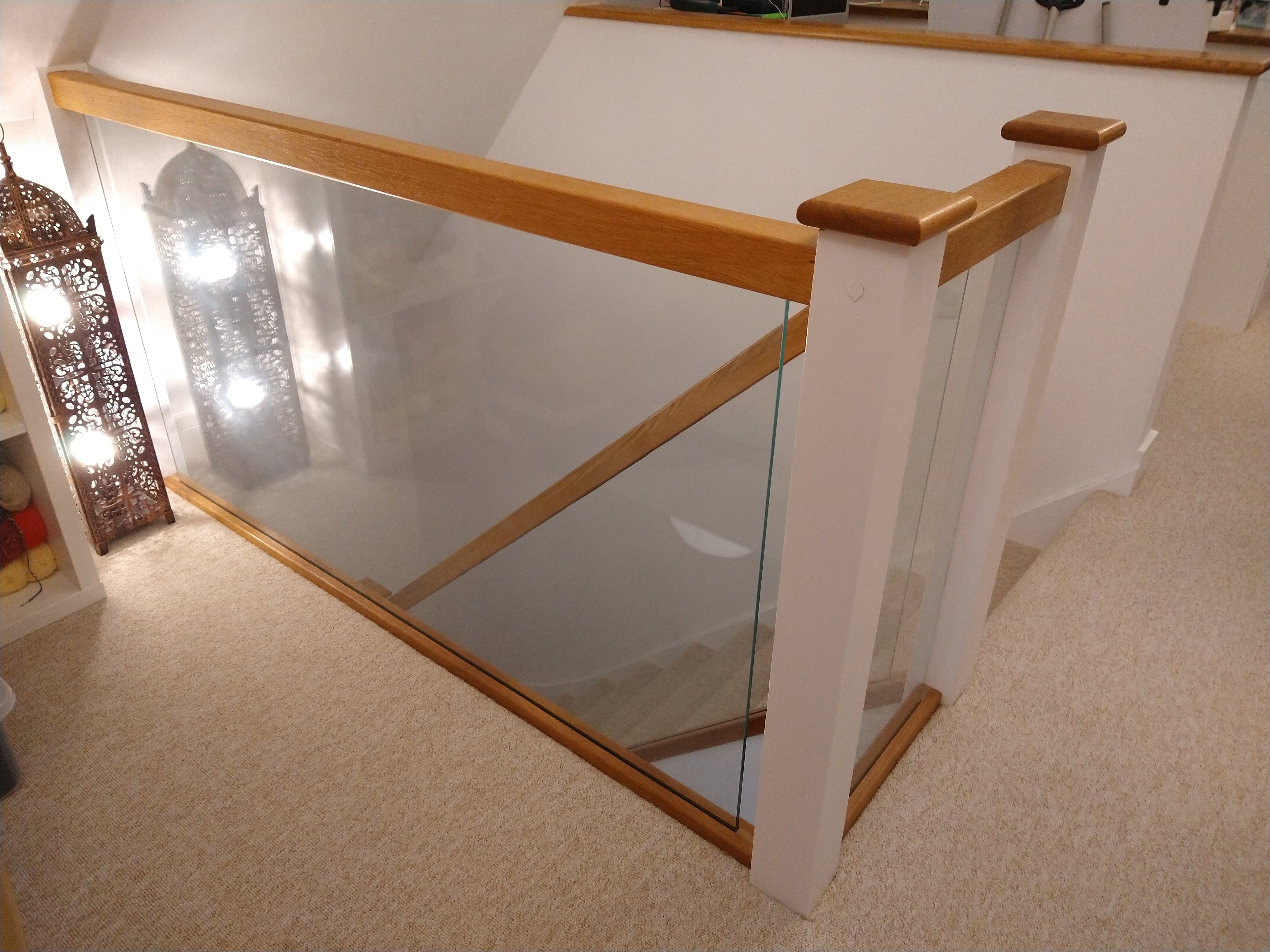

Radian Posted January 29, 2023 Share Posted January 29, 2023 Ah, it's only a crawl space! Storage with a view I guess? I wanted an unfussy glass balustrade so got channels routed into some Oak for the base and handrails. The glass was slid up into the handrail then dropped down into the base rail. Gravity and a rubber gap filer does the rest. Link to comment Share on other sites More sharing options...
Temp Posted January 29, 2023 Share Posted January 29, 2023 3 hours ago, Radian said: Ah, it's only a crawl space! Storage with a view I guess? I wanted an unfussy glass balustrade so got channels routed into some Oak for the base and handrails. The glass was slid up into the handrail then dropped down into the base rail. Gravity and a rubber gap filer does the rest. Ours are similar to these. The glass slots into grooves. Building Control may want to see standards marks (sometimes still called kite marks) on every pane. Link to comment Share on other sites More sharing options...
Radian Posted January 29, 2023 Share Posted January 29, 2023 3 minutes ago, Temp said: Ours are similar to these. The glass slots into grooves. Building Control may want to see standards marks (sometimes still called kite marks) on every pane. Yes, BCO wanted to see those but didn't comment on the securing method. Probably not acceptable in an earthquake zone but if the building accelerates fast enough to jump these out it's going to be the least of your worries. Link to comment Share on other sites More sharing options...
