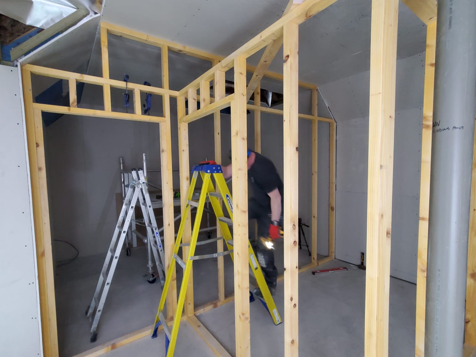

saveasteading Posted January 27, 2023 Posted January 27, 2023 Progress photos. I am seriously impressed with this workmanship, for our complete beginners. 2
Dave Jones Posted January 27, 2023 Posted January 27, 2023 you need more noggins. where the two doors meet nowhere to screw the plasterboard also will be no room for archivtrave either. Same at the slopes on the veiling that will need noggins.
twice round the block Posted January 27, 2023 Posted January 27, 2023 Where your yellow steps are in the door way. I'm afraid to say that frame is 100mm to far into the corner, and to try and do a finish as it is, will not be very pretty with BOTH frames. Hold two bits of plaster board into the corner, then imagine two bits of architrave stuck in there as well. I know you have the linings to go in yet but you don't have enough free play. Just my view point, please don't take it as a criticism 😍
ProDave Posted January 27, 2023 Posted January 27, 2023 6 minutes ago, twice round the block said: Where your yellow steps are in the door way. I'm afraid to say that frame is 100mm to far into the corner, and to try and do a finish as it is, will not be very pretty with BOTH frames. Hold two bits of plaster board into the corner, then imagine two bits of architrave stuck in there as well. I know you have the linings to go in yet but you don't have enough free play. Just my view point, please don't take it as a criticism 😍 Yes I agree with that. Unless the door opening is way over size and you are expecting a lot of packing for the door liner? At the moment you have 47mm less 12mm for plasterboard so 35mm, plus say 20mm for a door liner and say 10mm for packing that's 65mm to fit typically 70mm architrave, so you WILL be trimming it down and it may look rubbish.
saveasteading Posted January 27, 2023 Author Posted January 27, 2023 Thanks I will pass these comments to the team. Joinery isn't my thing. It may be that there are constraints on the door positions as we have the constraints of the geometry and the need for disabled movement space. Or maybe we need to change it as suggested. There is only 1/4 done, so they are learning all the way. Any advice on the tools to buy for door hanging? There are over 20 so it is worth getting the right stuff.

saveasteading Posted January 28, 2023 Author Posted January 28, 2023 Thanks again. All the advice cut and pasted to the site team who are also grateful. First responses is that the doors have to be where they are, and will be without architraves if necessary. The approved design first makes the rooms work as intended, but also must show clear space and access for disabled access. A Scottish rule, and a good one, so that an ageing occupant (or other need) can live on one level. I am wondering if we should have diagonals next to door hanging studs, or if the double stud plus dwang (noggin) suffices. The intended doors are rather heavy.
ProDave Posted January 28, 2023 Posted January 28, 2023 53 minutes ago, saveasteading said: First responses is that the doors have to be where they are, and will be without architraves if necessary. The approved design first makes the rooms work as intended, but also must show clear space and access for disabled access. A Scottish rule, and a good one, so that an ageing occupant (or other need) can live on one level. If your door positions are that tight that you can't move it over 50mm to make the architrave work, then you must be stretching every mm of the access space requirements? Not that I have ever known them measure for compliance.
Dave Jones Posted January 28, 2023 Posted January 28, 2023 1 hour ago, saveasteading said: Thanks again. All the advice cut and pasted to the site team who are also grateful. First responses is that the doors have to be where they are, and will be without architraves if necessary. The approved design first makes the rooms work as intended, but also must show clear space and access for disabled access. A Scottish rule, and a good one, so that an ageing occupant (or other need) can live on one level. I am wondering if we should have diagonals next to door hanging studs, or if the double stud plus dwang (noggin) suffices. The intended doors are rather heavy. nah thats tosh. moving the door into the correct position so it can be architraved is nowt to do with disabled regs. jockish regs allow for 775 doors when approached head on. lets see how they get on fixing the door linings.
saveasteading Posted January 28, 2023 Author Posted January 28, 2023 2 hours ago, ProDave said: Not that I have ever known them measure for compliance. No I don't think I would measure, as long as it looks reasonable. But we'd like to comply and somebody has calculated these distances as appropriate. If I'm ever in a wheelchair I'll be glad of the ramped entrance, level ground floor (which required some cute design) wide enough doors and general space. I don't think there are any minimum standards in England and longer. The site team will be looking at your helpful comments soon, but are on other priorities today. Does an architrave have any purpose other than aesthetics and covering the plaster edge? Balance is to be preferred of course.
ProDave Posted January 28, 2023 Posted January 28, 2023 17 minutes ago, saveasteading said: No I don't think I would measure, as long as it looks reasonable. But we'd like to comply and somebody has calculated these distances as appropriate. If I'm ever in a wheelchair I'll be glad of the ramped entrance, level ground floor (which required some cute design) wide enough doors and general space. I am not disputing they are generally sensible, just curious how you appear to be complying only just with little room for a minor alteration. A floorplan might explain it? 1
saveasteading Posted January 28, 2023 Author Posted January 28, 2023 2 hours ago, ProDave said: floorplan might explain it? Can't do that with the tech (or my it skill perhaps) where I am. But it is a steading so is narrow, then has the internal stud and insulation. I'm hoping the team has been studying door construction, as I haven't and have always had experts do it. Eg I have subtly mentioned allowing for floor finishes and linings, and hope it works with door sizes.
