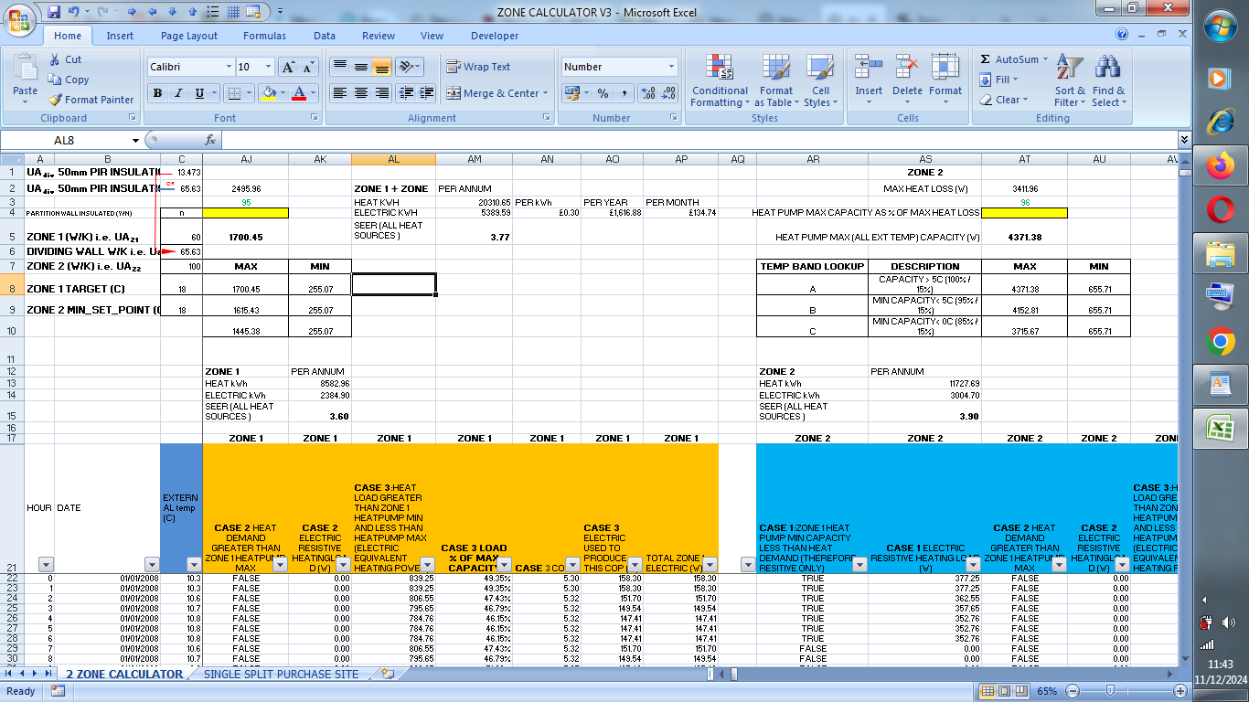

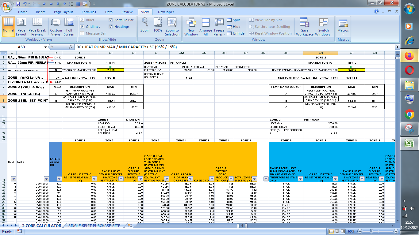

NIMAN Posted December 11, 2024 Share Posted December 11, 2024 On 11/12/2024 at 01:01, Iceverge said: Matching a suitable one for our climate isn't too hard though. Expand Not at all sure about that. For example, all I need do is choose the same Zone 1 / Zone 2 heat pumps (max power at 1700W / 4371 W) and change fabric loss Zone1 W/K from 29 to e.g. 60 and Zone 2 from 149 to e.g. 100 in the hourly quadratic (empirical based) calculator and the combined heat pump /electric heat source SEER drops from 4.22 to 3.77 (image attached). Personally I wouldn't touch any ASHP without a year or 3 of hourly weather data and also having carried out a fabric/airchange Heat Loss Coefficient calculation (W/K) after the refurbishment / extension was built to monitor the actual steady state heat loss over a week or two having heated it to a constant temperature. There are so many horror stories of installer calculated fabric losses / heatpump sizing resulting in SEER of 2 or less to be tempted by another way. The frosting / home automation supplementary heating / cycle limiting aspect also needs to be more fully investigated & implemeted too imho. Link to comment Share on other sites More sharing options...
JohnMo Posted December 11, 2024 Share Posted December 11, 2024 (edited) On 11/12/2024 at 11:49, NIMAN said: SEER of 2 Expand EER/SEER is cooling, CoP/SCoP is for heating. Why would you design a system around 18 Deg house heat temp? Way to cold. On 11/12/2024 at 11:49, NIMAN said: Personally I wouldn't touch any ASHP without a year or 3 of hourly weather data and also having carried out a fabric/airchange Heat Loss Coefficient calculation (W/K) after the refurbishment / extension was built to monitor the actual steady state heat loss over a week or two having heated it to a constant temperature. Expand Suggest you are over thinking the whole thing. Calculation of heat loss is needed, but that isn't difficult. Add 10% for DHW and/or defrosting, which generally occurs between +3 to -3. Design to cover 99.8% of likely outside temperatures. It is unlikely the heat pumps on offer, will exactly match the kW required exactly, so you choose the one one up. Cycling isn't an issue generally and the worst can be fine tuned out. Most issues with A2W revolves around distribution system in house being split into many zones, poorly installed and designed buffers and way to high a design flow temperature. Then home owners ignorant of how to operate and wanting to operate how they did with a gas boiler. Most these issues are not relevant A2A as the equipment and how it runs is factory designed and set, and the home owner cannot mess with it. Edited December 11, 2024 by JohnMo Link to comment Share on other sites More sharing options...
Iceverge Posted December 12, 2024 Share Posted December 12, 2024 On 11/12/2024 at 11:49, NIMAN said: Not at all sure about that. For example, all I need do is choose the same Zone 1 / Zone 2 heat pumps (max power at 1700W / 4371 W) and change fabric loss Zone1 W/K from 29 to e.g. 60 and Zone 2 from 149 to e.g. 100 in the hourly quadratic (empirical based) calculator and the combined heat pump /electric heat source SEER drops from 4.22 to 3.77 (image attached). Personally I wouldn't touch any ASHP without a year or 3 of hourly weather data and also having carried out a fabric/airchange Heat Loss Coefficient calculation (W/K) after the refurbishment / extension was built to monitor the actual steady state heat loss over a week or two having heated it to a constant temperature. There are so many horror stories of installer calculated fabric losses / heatpump sizing resulting in SEER of 2 or less to be tempted by another way. The frosting / home automation supplementary heating / cycle limiting aspect also needs to be more fully investigated & implemeted too imho. Expand Heat pumps can be done badly. There's no doubt about it. No different than any wet heating system. An A2A generally is much less vunerable to a crappy install than an A2W. Running your house on direct electric and monitoring the usage patterns is no bad idea. We did it for a few years and had a really good idea of the house's usage. Calculations tend to run into a big issue once a real house is considered. There's too many variables, or children as I like to call them. Link to comment Share on other sites More sharing options...

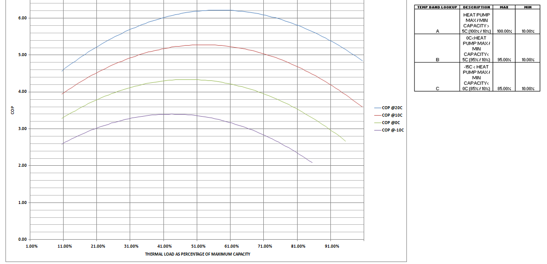

NIMAN Posted December 13, 2024 Share Posted December 13, 2024 For the record, related to this comment: The smallish sample of mini-splits involved in the empirical investigation demonstrated lowest output (at lowest external temprature) at around 10% of maximum output (at the highest external temperature at which that highest output was acheieved) i.e. effectively a fixed amount. My spreadsheet model also, currently, uses this fixed 10% to calculate lowest steady state modulated output. Link to comment Share on other sites More sharing options...
Beelbeebub Posted December 13, 2024 Share Posted December 13, 2024 The point to note about output modulation is that it can be misleading to just think of a fixed % of the. Maximum. This is because the point at which you are likely to need the lowest output is usually when the outside temp is at it's highest Your HP mauly be able to modulate down to 25% of max output but that max output grows as the outside temp increaces So 25% of 5kw at - 5C is 1.25kw But if your output is 8kw at 15C it's 2kw. And your demand at 15C is lower than your demand at -5C. So for the true picture of modulation you need to look at your highest power output at the lowest OAT and your lowest power output at the highest OAT. Link to comment Share on other sites More sharing options...
SteamyTea Posted December 13, 2024 Share Posted December 13, 2024 On 13/12/2024 at 13:08, Beelbeebub said: So for the true picture of modulation you need to look at your highest power output at the lowest OAT and your lowest power output at the highest OAT. Expand Yes, I think that is right. And then you need to cheat the CoP values at the extremes. It all boils down to the energy/power. On 13/12/2024 at 10:09, NIMAN said: % Expand As mentioned, percentages are very misleading. Get the absolute numbers. In statistics, which energy transferred in the biosphere is all about, always ask is it a big, or small number, then ask if it is relevant. Link to comment Share on other sites More sharing options...
