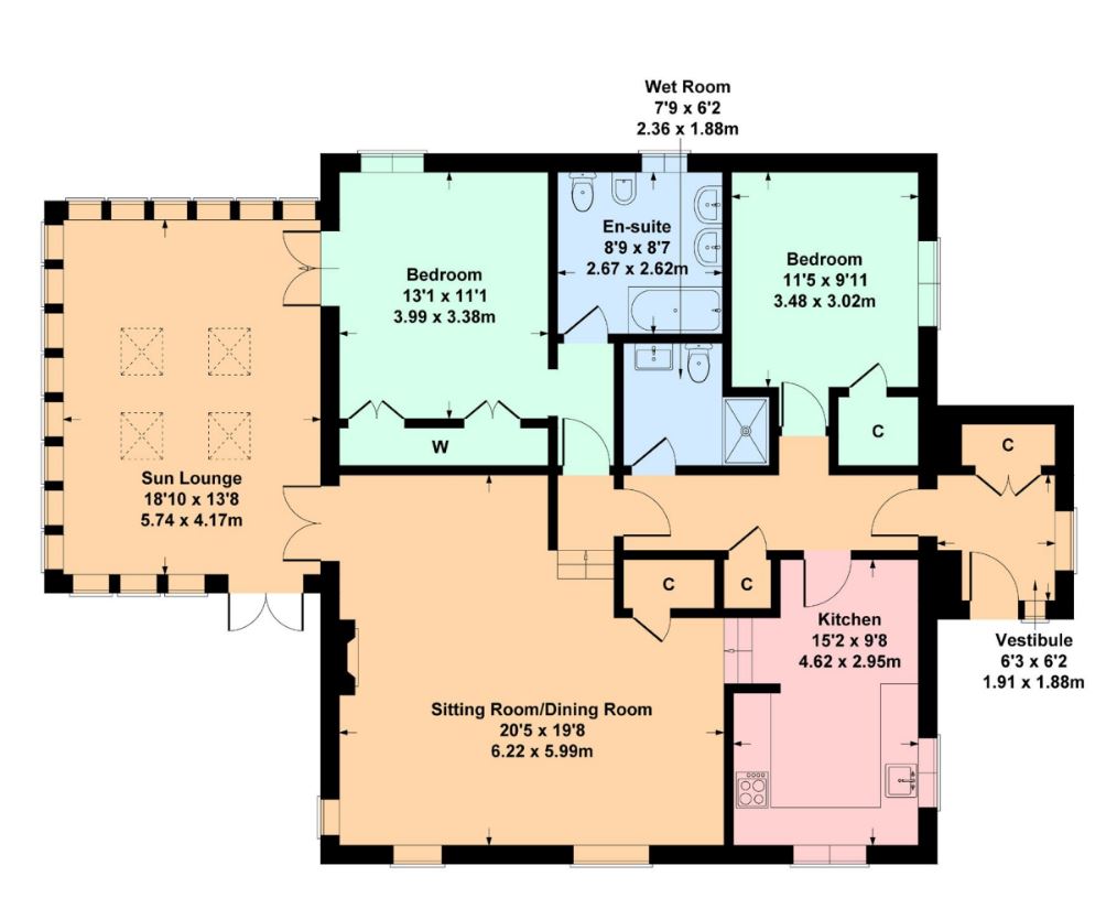

Gill Posted January 22, 2023 Posted January 22, 2023 As I posted in another thread, I've been trying to understand the options I should be considering for space heating and DHW. We have a few small layout changes planned along with refurb our bathroom and shower room so deciding on heating and DHW system seems like the sensible first stage. Would appreciate any input into pros / cons of the various systems I'm thinking about and also any systems that I haven't listed that I should be thinking about. Limitations: No Gas supply Property : Two bed bungalow single storey (decline and die home) Current system : Storage heating (not high heat retention). Electric heaters used for top up. DHW through an immersion tank. Heat Loss : I've had a stab at completing the spreadsheet making assumptions about u values of windows, doors and Air Changes. The monthly figures are eyewatering. The highest actual daily usage we've hit in one day was 96kWh (which included DHW ). This was December when the temps between -3 and -9 consistently. That said, we don't maintain 18 degrees across the whole house. The hall and kitchen have no heating, the shower room has a towel rail we never use, the main bedroom only gets a blast of heat in the exceptionally cold weather. The second bedroom gets the storage heater overnight if WFH the following day. Improvements : I've not factored in up coming improvements on the spreadsheet. All windows will be replaced in the next month that should give approx U value of 1.1. Following on from that, we'll get the cavity walls insulated. I also plan to put in a MHRV system (in our cold roof). Have read mixed thoughts on this but I think i'm sold on the broader benefits of MHRV even homes that cannot achieve great airtightness. Solar seems like a no-brianer - we've got reasonable sized unobstructed south facing roof space and also a smaller south facing garage roof Some of my thinking so far.... Stick with Storage Heaters Pros No plumbing required - Minimal disruption. Economic with ECO 7 tariff Will perform better when we insulate Cons: Delivers heat when we dont need it. The house is empty daytime twice a week at least. May still require top up heating (at peak rate) High Heat Retention models don't come cheap and aside from user reviews on manufacturers web sites, haven't seen real world feedback from anyone that's upgraded to HHR. Bulky / Consuming wall space Require a separate solution for DHW ASHP & Oversized Rads Pros Heat when we want it Plenty info on how to size things correct and tweak for performance Can supply DHW Cons Disruption of installing a wet heating system Oversized Rads consuming wall space Don't see this working with with ECO 7 tarrif ASHP & Underfloor Heating Pros No radiators No cold patch at floor level Can supply hot water Cons Most Costly Option Requires wet heating system Efficiency concerns with suspended flooring Potential need to build up the flooring throughout the house Don't see this working with with ECO 7 tariff A2A Pros Cooling & Heating. Cooling would work well with solar. Placement frees up wall space Cons: No where near as much info available on A2A as ASHP so hard to get a good understanding of pros / cons / suitability Would MHRV system play nice with A2A? Require a separate solution for DHW Don't see this working with with ECO 7 tariff Heat loss calculator - Master.xlsxFetching info...

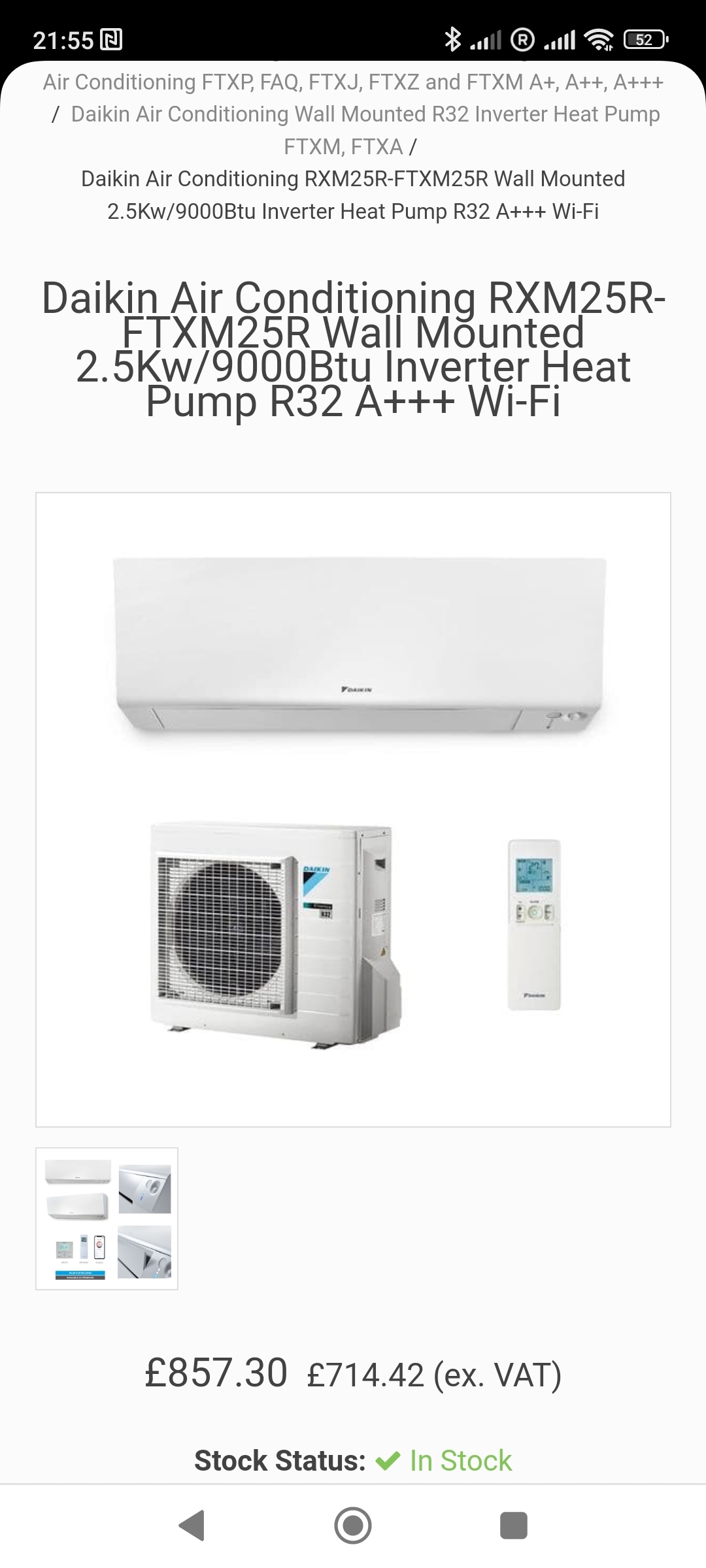

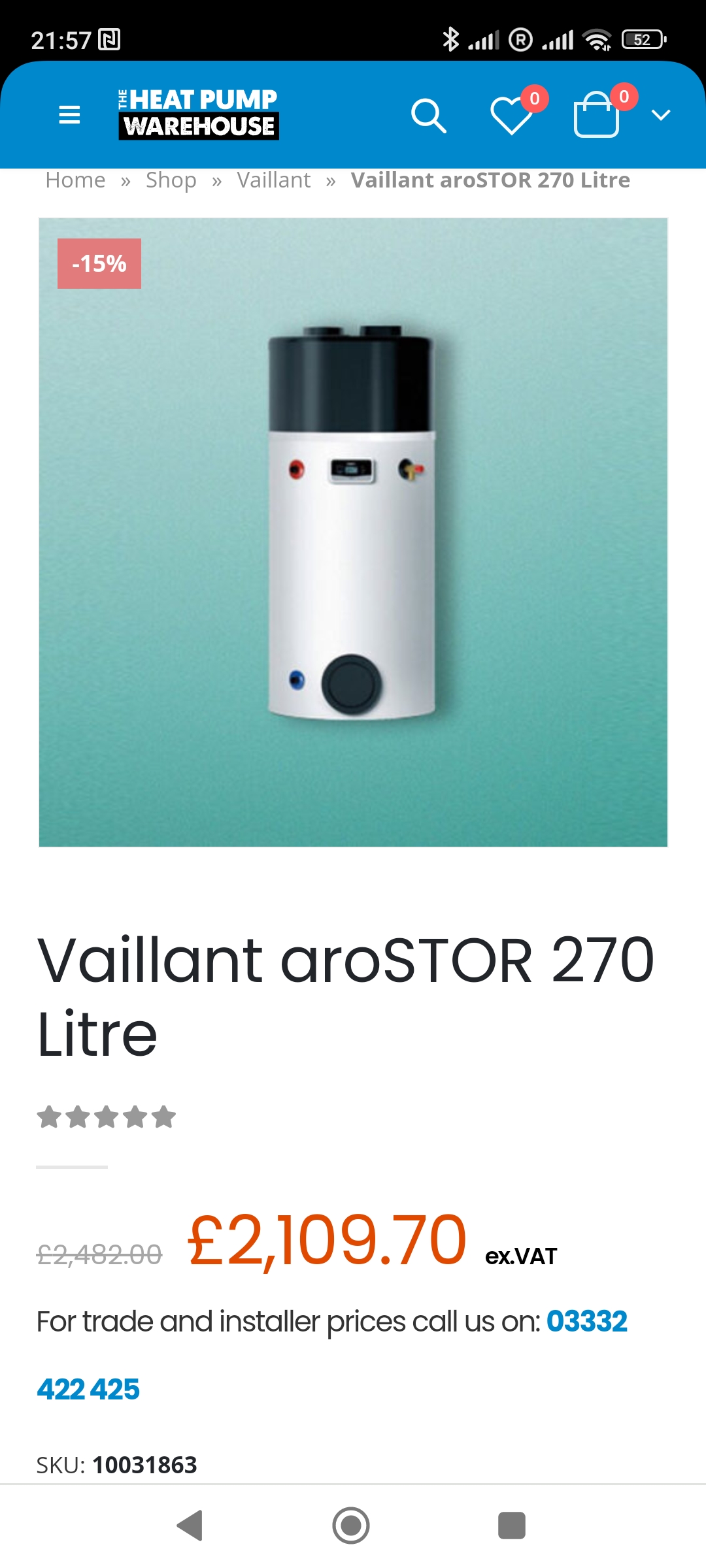

Iceverge Posted January 22, 2023 Posted January 22, 2023 A couple of A2A @ a COP of 4 and an ESHP at a COP of 2.5-3 Bin the MVHR. This will do your heat recovery and ventilation but recover the heat to the DHW rather than air. It should provide a cheap to install system especially in a bungalow. ASHP beating running costs. Fast response heating with control from your phone built in. Free cooling in summer along with the PV. Plenty of fresh air. Put the rest of the cash into airtightness and insulation and you'll have a very warm and cheap to run house.

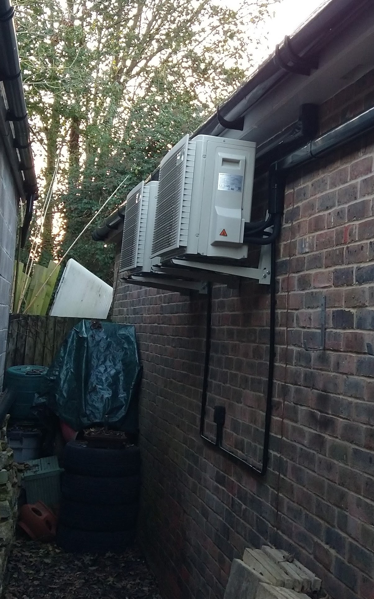

crispy_wafer Posted January 23, 2023 Posted January 23, 2023 On 22/01/2023 at 16:56, Gill said: A2A Pros Cooling & Heating. Cooling would work well with solar. Placement frees up wall space Expand Another here who's having A2A installed upstairs (bedrooms) in our build. Whilst we have no plasterboard in situ and good access to loft and spaces, 2 ducted systems, and a wall mounted unit going in. Still thinking on what to do downstairs though, both for my pocket (Install, and monthly running costs), ease of use, least amount of faff, etc etc.
Iceverge Posted January 23, 2023 Posted January 23, 2023 On 23/01/2023 at 09:48, Gill said: I assume it should not be housed in a cold loft given it's recovering heat. Cost wise, it looks like a very attractive option. Does it partner up well with PV or would a 2nd system be required to act as a thermal store? Expand It slots in instead of your hot water cylinder. It is a 270L unvented cylinder with a built in heat pump. It extracts air from the wet rooms in the house. As they will be at ~20deg you will get very good heat pump performance. Some units have a built in PV setting to take solar input to an immersion. Beware of the units you buy however as some need regular anode servicing. The downside is that you will be drawing in cold air through the vents in the windows/walls and any cracks in the building. Given that you will need holes in the house anyway it makes airtightness less critical than wil MVHR. This air will need to be heated up with another heat source. @Thedreamer uses a solid fuel stove but an A2A unit would work well too. As I understand it multi split systems are not as good as multiple single units. @Hanksy has some mitsubishi units if you search their posts.
Iceverge Posted January 23, 2023 Posted January 23, 2023 On 23/01/2023 at 09:48, Gill said: Expand I reckon an ESHP in either of the cupboards between the sitting room and kitchen provided that works in with your existing plumbing. Then 2* small A2A units in both of the bedrooms. And a slightly larger one in the sitting room. Keep external units away from bedroom windows for noise.
Gill Posted January 23, 2023 Author Posted January 23, 2023 Thanks folks for all the input / advise. Some more questions and a few answers . On 23/01/2023 at 11:05, crispy_wafer said: 2 ducted systems, and a wall mounted unit going in Expand Curious - Is ducted system the same as the multi split system? All new territory / terminology for me at the moment. On 23/01/2023 at 11:57, Iceverge said: It is a 270L unvented cylinder with a built in heat pump. It extracts air from the wet rooms in the house Expand So potentially a direct replacement for our immersion system and header tank ? We use a shower pump for pressure - I assume I could continue to use that with the UVC? On 23/01/2023 at 11:57, Iceverge said: Some units have a built in PV setting to take solar input to an immersion. Beware of the units you buy however as some need regular anode servicing Expand Solid advice - no one likes ongoing maintenance costs ! On 23/01/2023 at 11:57, Iceverge said: The downside is that you will be drawing in cold air through the vents in the windows/walls and any cracks in the building. Given that you will need holes in the house anyway it makes airtightness less critical than wil MVHR. Expand I'm wondering how this will work as we improve the air tightness. The window replacements that will be fitted next month will have no trickle vents. If we were to achieve improved airtightness, would condensation become an issue ? On 23/01/2023 at 11:57, Iceverge said: @Hanksy has some mitsubishi units if you search their posts. Expand Some interesting reading in there on COP in the colder months. On 23/01/2023 at 12:02, Iceverge said: I reckon an ESHP in either of the cupboards between the sitting room and kitchen provided that works in with your existing plumbing. Expand The cupboard in the kitchen currently houses our immersion tank so that would tie in with existing plumbing. If i went A2A, are there any benefits to doing the ESHP at the same time? Would be good to phase improvements but not if it incurs additional cost. On 23/01/2023 at 12:02, Iceverge said: Keep external units away from bedroom windows for noise. Expand Positioning wise - is it one external to one internal ? Similar positioning advise to ASHP, then the more sheltered and the warmer the location the better the performance? The bedroom side of the house is south facing but is also close to neighbors with not a huge amount of space to the boundary - would need to have the units very close to the house in that area. The opposite side (living room external ) has a lot more space but is a bit more exposed and doesn't get nearly as much sunshine. Front external of the house doesn't get much light in the summer and frost can stay there all day.
Iceverge Posted January 23, 2023 Posted January 23, 2023 On 23/01/2023 at 19:41, Gill said: So potentially a direct replacement for our immersion system and header tank ? Expand Yes, it is an unvented system so will require a pressure vessel too. Check your current plumbing is capable of mains pressure. On 23/01/2023 at 19:41, Gill said: We use a shower pump for pressure - I assume I could continue to use that with the UV Expand You can dispense with this as you'll have mains pressure hot water, a vastly superior experience. On 23/01/2023 at 19:41, Gill said: Solid advice - no one likes ongoing maintenance co Expand Disclaimer, I've never used one, rather learned here about them. I like the theory however. A search of the term "ESHP" should point you in the right direction. You might fall in to G3 regs which technically require an annual check AFAIK. On 23/01/2023 at 19:41, Gill said: If i went A2A, are there any benefits to doing the ESHP at the same time? Would be good to phase improvements but not if it incurs additional cost. Expand Stand alone systems. No interdependence. On 23/01/2023 at 19:41, Gill said: Positioning wise - is it one external to one internal Expand It depends, a multi split is one external to many internal. A simple split unit is one for one. More knowledgeable folk than me could point to the advantages/disadvantages of siteing close to the indoor unit. A warm location for an external unit is a bit mute given the enormous volume of air they move, so long as the fan isn't constantly fighting the prevailing wind or in a tiny alcove that will become refrigerated by the external unit you'll be ok. 1

crispy_wafer Posted January 23, 2023 Posted January 23, 2023 On 23/01/2023 at 19:41, Gill said: Thanks folks for all the input / advise. Some more questions and a few answers . Curious - Is ducted system the same as the multi split system? All new territory / terminology for me at the moment. Expand Yes, ducted just means the warm/cool air is delivered to the room via pipework and is sent into the room by grills or circular diffusers in the ceiling (normally), rather than physical units sat on the floor, high up, or ceiling mounted. The bits that do the work are suspended in the loft. Can be a multisplit, or non multisplit depending on how you want the system. In my case I have a multisplit going in Costing about 5,500 all in, which I think is in the right sort of ballpark, not cheap, but I'm doing this once and if it means the build takes a couple of months longer then so be it. 1
Thedreamer Posted January 23, 2023 Posted January 23, 2023 On 23/01/2023 at 21:45, Gill said: Thanks @Thedreamer Would be great to get some general info on your system setup... refurb or new build, pv hook up, ongoing maintenance, what was involved in your installation (more relevant if a replacement system but I'll take any info on offer), happy with running costs? In general how's the system working for you - anything you'd change if you were doing it again? It's all very high level questions but hopefully I'll get a bit more time to read up and ask some more specific questions. Expand We are a slightly higher building reg self build on Skye. Nothing fancy, just a modest three bedroom 138m2 completed in 2020. Our installation consists of three extraction points in our en-suite, bathroom and utility this goes into a metal ducting into a mini air source heat pump on top of a cylinder. It takes that air and heats our domestic water (not heating) and blows cold air outside. It also extracts moisture through a pipe to the outside to help with humidity. It was quite cheap to install and is cheap to run. It's very consistent in the energy usage as it's not trying to take cold winter air outside like an external heat pump therefore always achieves a very higher cop. Points to consider: sound proofing - our sits in a cupboard in the utility room. No noise in the house, but when working its slightly louder than a fridge freezer. We have it on anti vibration mat. We also used flexible ducting just before it goes into the unit. Get one with a good quality tank, some have anodes which require maintenance. A better quality one, such as a Joule cylinder does not. Mostly importantly, as its sucking internal air into the system and this will pull cold air from outside. We manage this by having lots of south facing glazing which heats the house for about six months of the year and allows for a bit of this free energy to be sucked up into the system. In the winter we rely on a centrally placed wood burner. Having access to free wood means that I can heat the house, with a few sticks and also the heat from the stove goes into the system. I am in an unique situation and if I did not have endless wood it might not be so attractive. That's not say it can't work efficiently in other circumstances. With the £400 rebate and further expected £200 rebate as a non gas customer, we will have no energy bills for ten months. I don't have any solar panels at the moment, but might get some fitted in the future. Here's my blog if you want to see pictures of the set-up. 1 1
Radian Posted January 23, 2023 Posted January 23, 2023 On 23/01/2023 at 21:51, crispy_wafer said: In my case I have a multisplit going in Costing about 5,500 all in, which I think is in the right sort of ballpark, not cheap, but I'm doing this once and if it means the build takes a couple of months longer then so be it. Expand Comparable, I'd say, to the real cost of installing a fossil fuel boiler and multiple radiators - especially if not on mains gas. On 23/01/2023 at 19:41, Gill said: Positioning wise - is it one external to one internal ? Expand There are two main issues that I can think of. Obviously if there's only one outdoor compressor unit, then the indoor units can only cool or heat together. Less obvious perhaps is that the simultaneous heating/cooling capacity will be lower and all indoor units will go idle during defrosting mode. Neither of these is a show stopper but having one-to-one indoor outdoor units doesn't add a huge premium when most of the cost is in the indoor units. Here's the two outdoor units that provide us with a total of 7kW of heating for around 1.5kW of electricity. Quite a bit smaller than an ASHP and more practical to hang on a wall. 1 1
