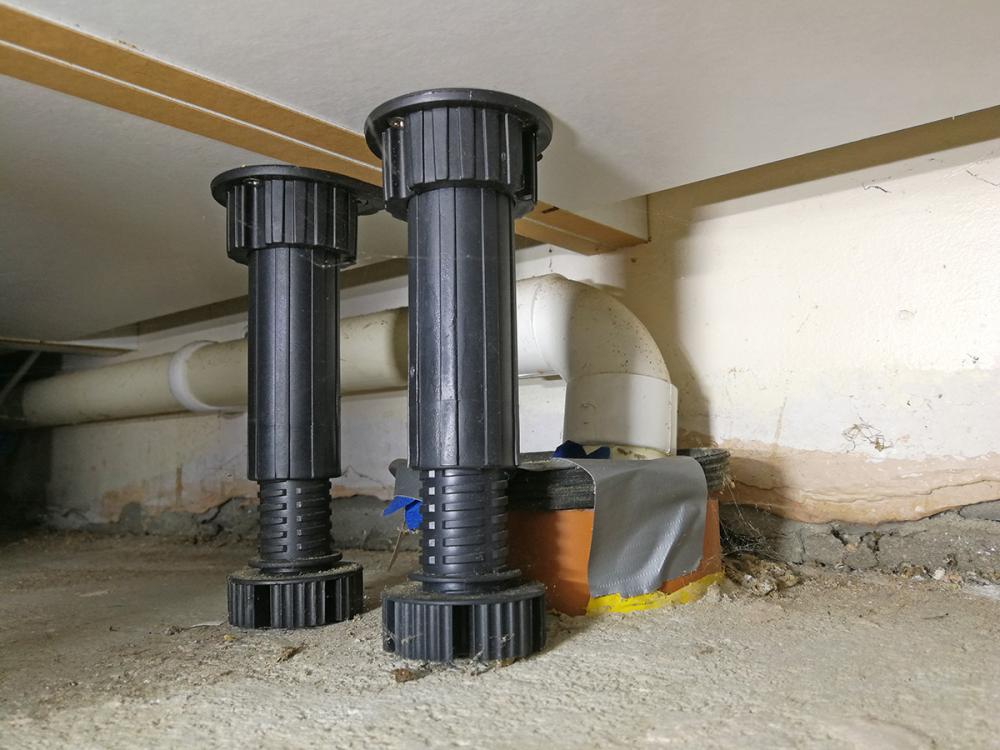

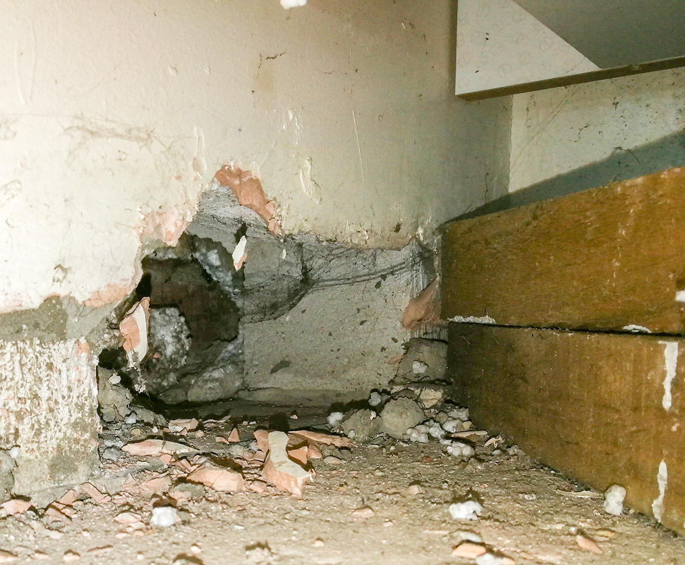

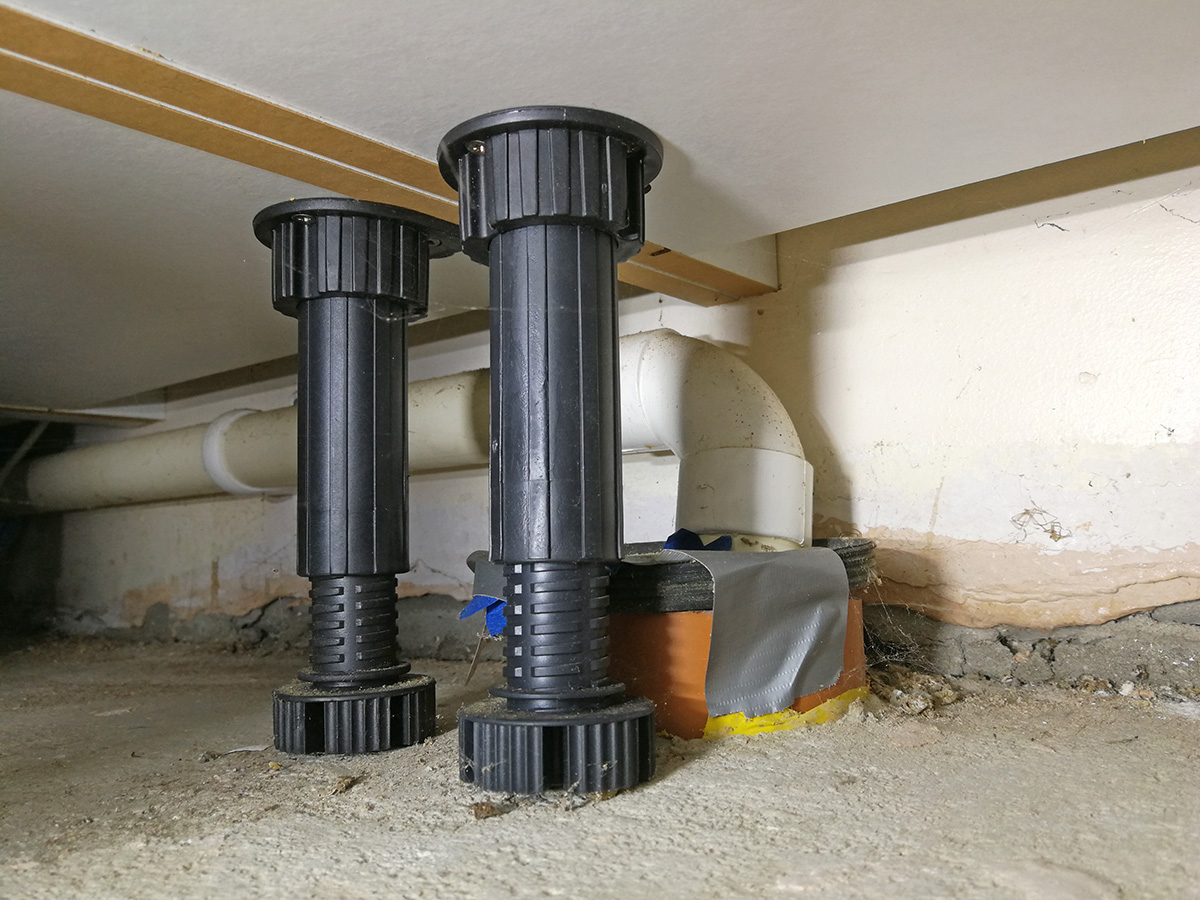

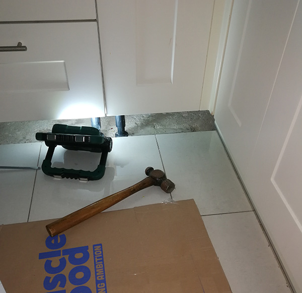

Sparrowhawk Posted January 21, 2023 Posted January 21, 2023 It's draughty at foot level in the kitchen so I took the kick boards off. There were a couple of bits of wood piled up in the corner which I hooked out with a hammer. On the outside there is an air brick at this point (single clay brick size) so I was expecting something. But perhaps an airbrick with a grille that I could tape over. This is an all-electric kitchen, no gas appliances. The bottom of the hole has plastic sheet on it (damp proof course?). I tapped the top of the hole with a hammer. The top is thin plaster. It's taller than it looks. How am I going to seal this up? It's behind a corner fitted unit. Lying on the floor it takes my outstretched arm plus a 15" hammer to reach the closest edge of the hole. I can't take the bottom out of the kitchen unit as the fixings holding the carcass together are on the outside butting up to the neighbouring units. Is cutting an access hatch in the bottom/back of the kitchen cupboard the only way? And then the best approach to cut PIR board to fit and tape the edges? Bonus question: is this how the sink waste is meant to be secured into the drain?
ProDave Posted January 21, 2023 Posted January 21, 2023 I would empty the contents of an expanding foam gun into that hole. No that's not how you connect a drain but that will be equally awkward to fit properly with the units in place.

ProDave Posted January 21, 2023 Posted January 21, 2023 I wonder if you could do it from outside through the holes in the air brick? At worst case enlarge say 2 of them, one at each end with a drill to get the gun nozzle through Might help to have an observer inside directing the squirting. (having typed that I could see how that could go wrong......) 1

Redbeard Posted January 21, 2023 Posted January 21, 2023 The problem with using a long extension tube is that it slows the flow very significantly, so the tendency (on full pressure) to blow in and 'stick' is lost, and you get a lot of falling back out. Could you not open out more on the outside, weasel a bit of board over the hole on the inside, then fill back towards the outside before finishing with brick or whatever the external skin is? As far as the drain connection goes I wonder (if you could let off the bracket on the horizontal run) whether you could get a 110mm stop-end, drill a hole in it and shorten the 'pipe end' so that you can slot it up onto the 40mm waste, then down into the rubber of the socket end. Then a finger-full of silicone to seal, if you feel the need to seal.

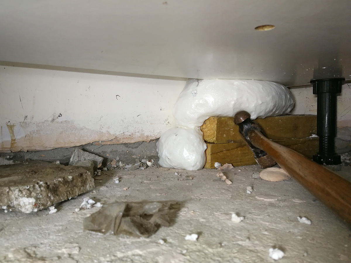

Sparrowhawk Posted January 29, 2023 Author Posted January 29, 2023 The deed is done I had to wait until the weather warmed up to be above the "min 5C" temperature for the foam, and used a disposable Soudal can as the straw it came with was small enough to fit through the air brick holes without drilling them out. It took the whole can to get it to seal this plus back to the airbrick so I imagine the cavity has a bit of fill too. 4
Sparrowhawk Posted January 30, 2023 Author Posted January 30, 2023 Hard to measure the impact as it's warmer outside this morning than yesterday so is the 2C difference due to that or no hole in the wall, but the lack of air movement in the kitchen is noticeable.
