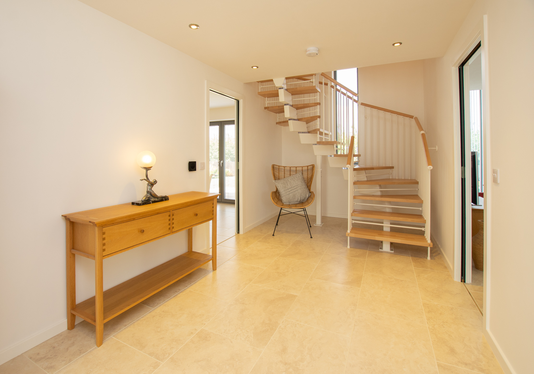

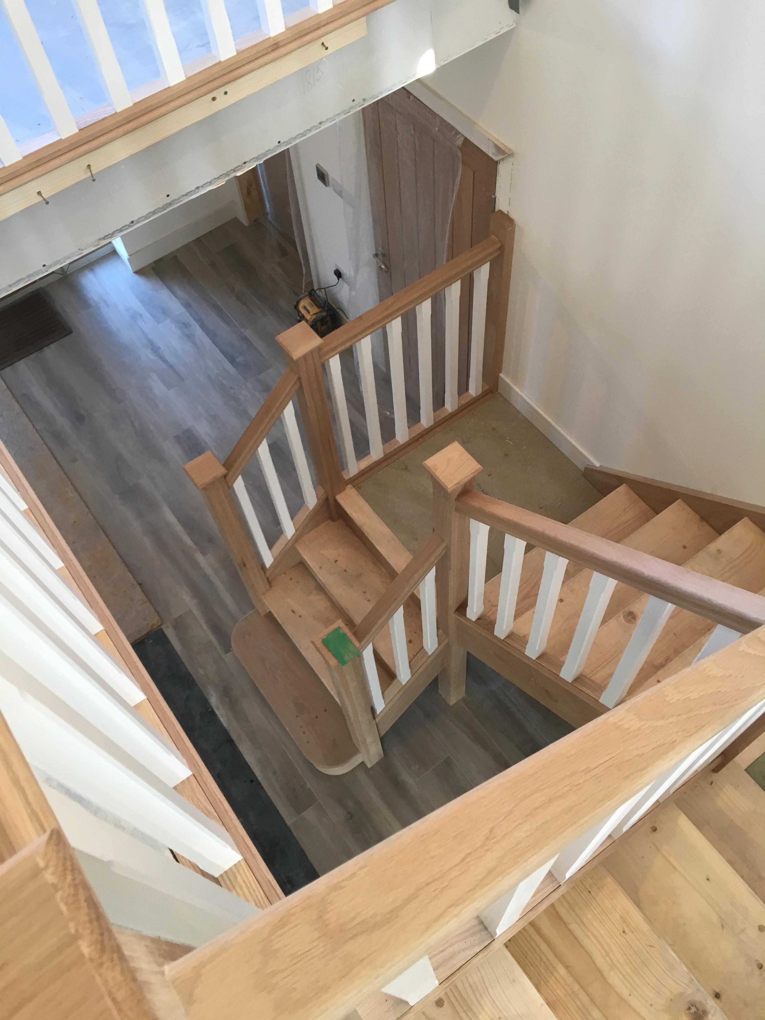

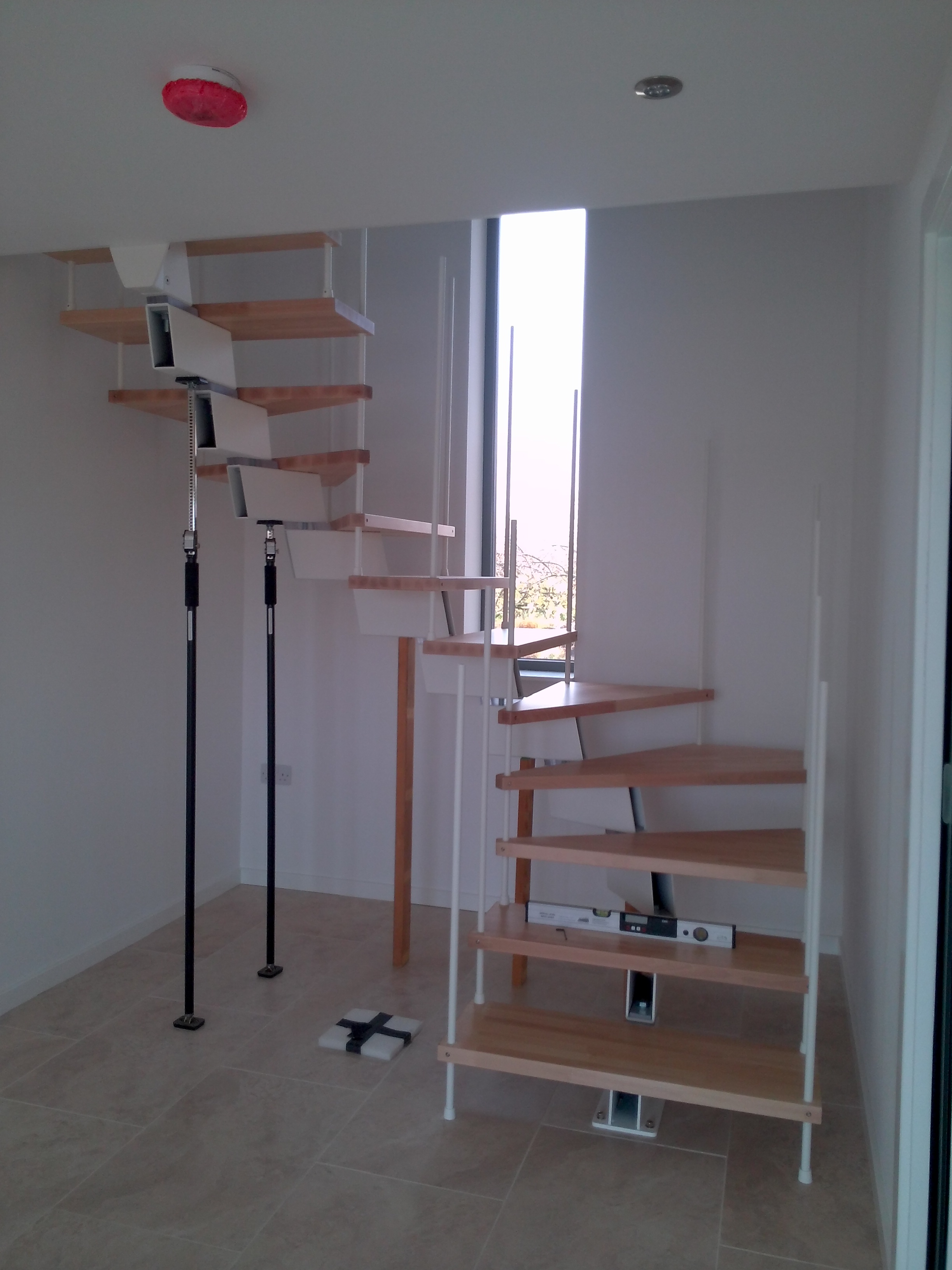

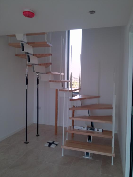

I installed both sets of my stairs having never done them before. Took me a day to get the main stairs in (kite winder) and then a couple more doors mincing to get the rail and spindles etc done.
Took me a week of mincing to do my spiral staircase.
I am sure if you got stuck, posted up the problem, with pictures, within a few hours you would have 5 right answers.
Just do it.
If all goes Pete Tong, call the manufacturers and ask them, just make sure they know what you do for a living.
I did our previous build stairs
I’m certainly no joiner
But the trick is to get them measured by the people who are making them
I just installed a stairbox staircase, straight run, quarter landing, winder, straight run. Took about 4 hours to install (no spindles or handrails yet -tbc) would have been quicker but the staircase was quite a tight fit in the space! Solid and no issues really whilst fitting
Our kit contained what seemed to be a million bits and took ages to fit, but we liked it when it was done. I live in a bungalow now.
