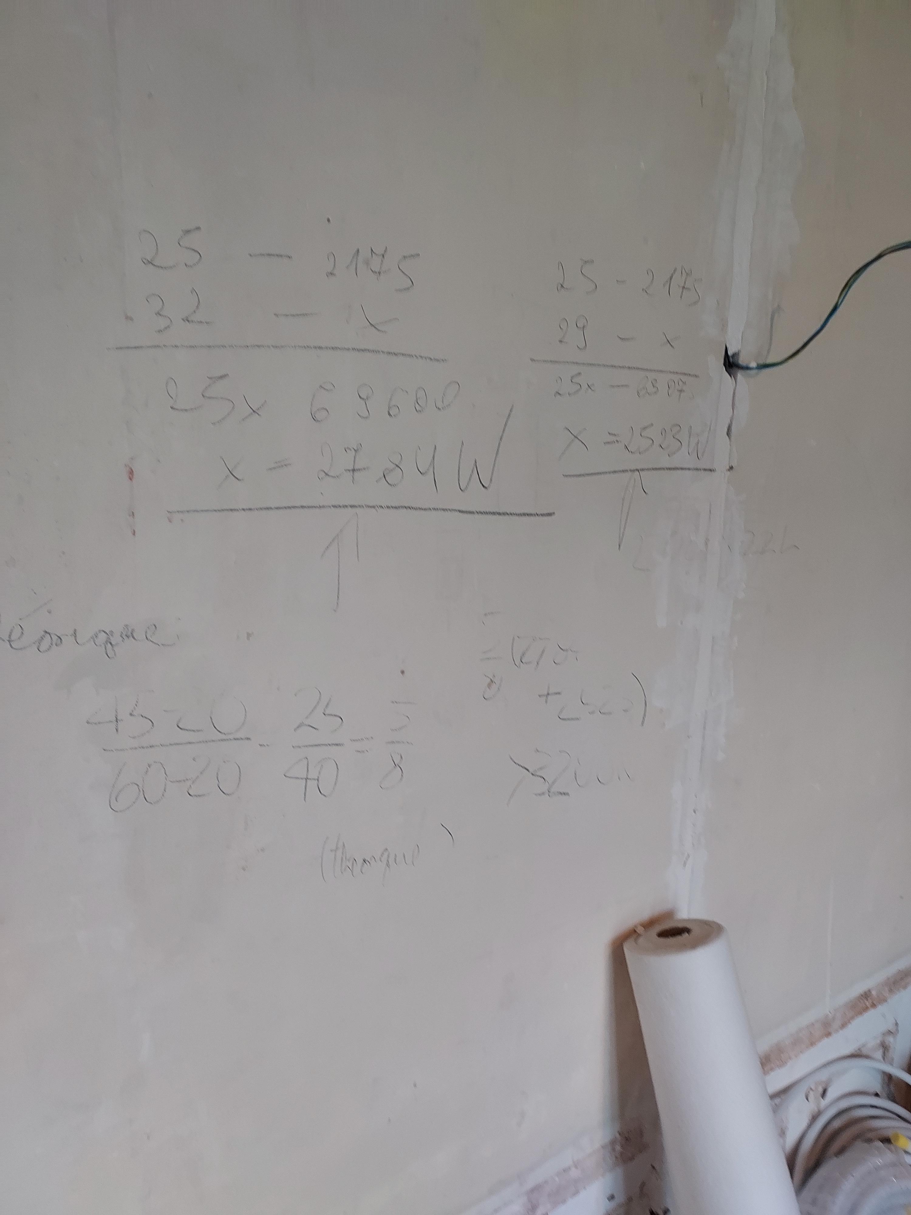

Garald Posted January 17, 2023 Author Posted January 17, 2023 The existing radiators were used by previous owners (at high temperature) to heat the room back when it was not insulated. If the contractor's tables give us the right figures for their power, then our on-the-spot calculations of their power in low temperature (see below) show that they are brutally overdimensioned (by a factor of more than 3 when it's -2C outside). So, I shouldn't really be concerned, should I? TL;DR: benches on radiators muffle their power, but do not waste energy.
SteamyTea Posted January 17, 2023 Posted January 17, 2023 On 17/01/2023 at 15:45, Garald said: Expand Reminds me of A Beautiful Mind. What you been drawing on the windows, Feynman Diagrams?
Garald Posted January 17, 2023 Author Posted January 17, 2023 On 17/01/2023 at 16:42, SteamyTea said: Reminds me of A Beautiful Mind. What you been drawing on the windows, Feynman Diagrams? Expand Hah! I'm a mathematician, not a physicist...
SteamyTea Posted January 17, 2023 Posted January 17, 2023 On 17/01/2023 at 16:45, Garald said: Hah! I'm a mathematician, not a physicist... Expand It shows mate. Had a debate with @Adsibob that mathematics is not science as he claimed.
Garald Posted January 17, 2023 Author Posted January 17, 2023 On 17/01/2023 at 16:47, SteamyTea said: It shows mate. Expand :(. Too little physical intuition? The physics I took in Uni mostly taught me that I should learn more about Fourier analysis and Hilbert spaces - an invaluable life lesson, but not strictly speaking one in physics. On 17/01/2023 at 16:47, SteamyTea said: Had a debate with @Adsibob that mathematics is not science as he claimed. Expand I'd say it's not a science in English (neither are the social sciences), because of the strong Baconian associations of the word. It's Wissenschaft, however, though so are many other things. In French, Spanish,... - it's an issue of definition. I'm happy to let maths be their own thing.
