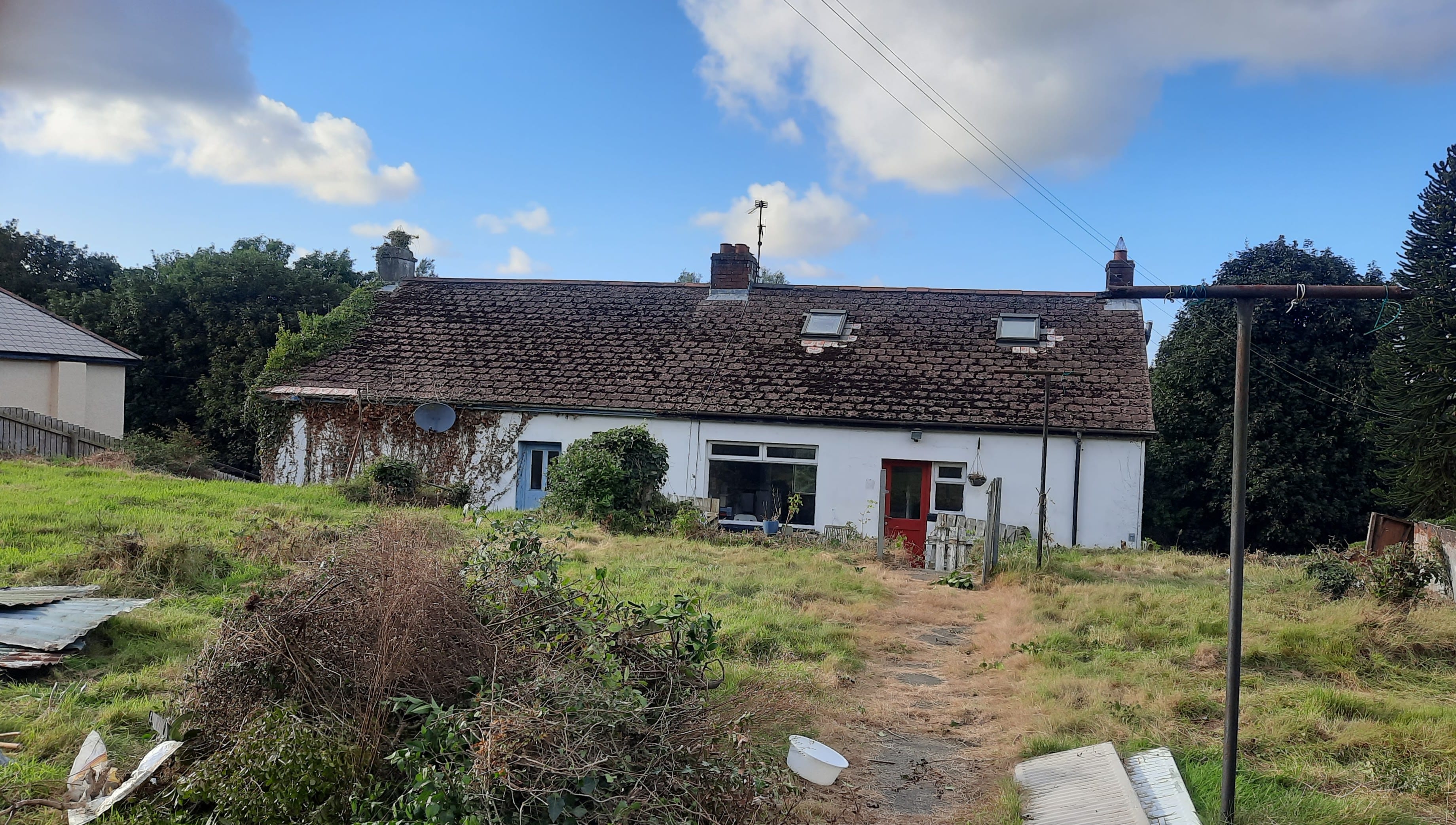

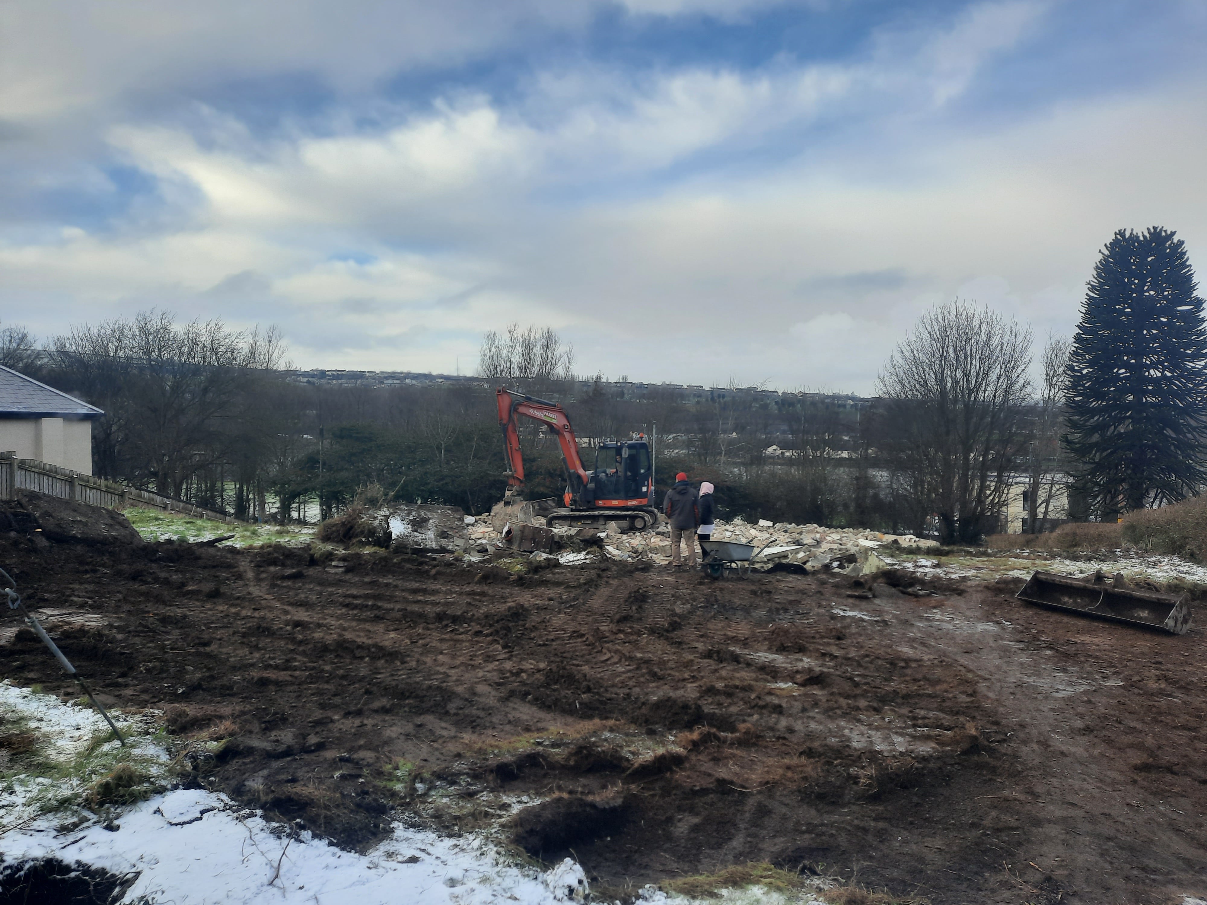

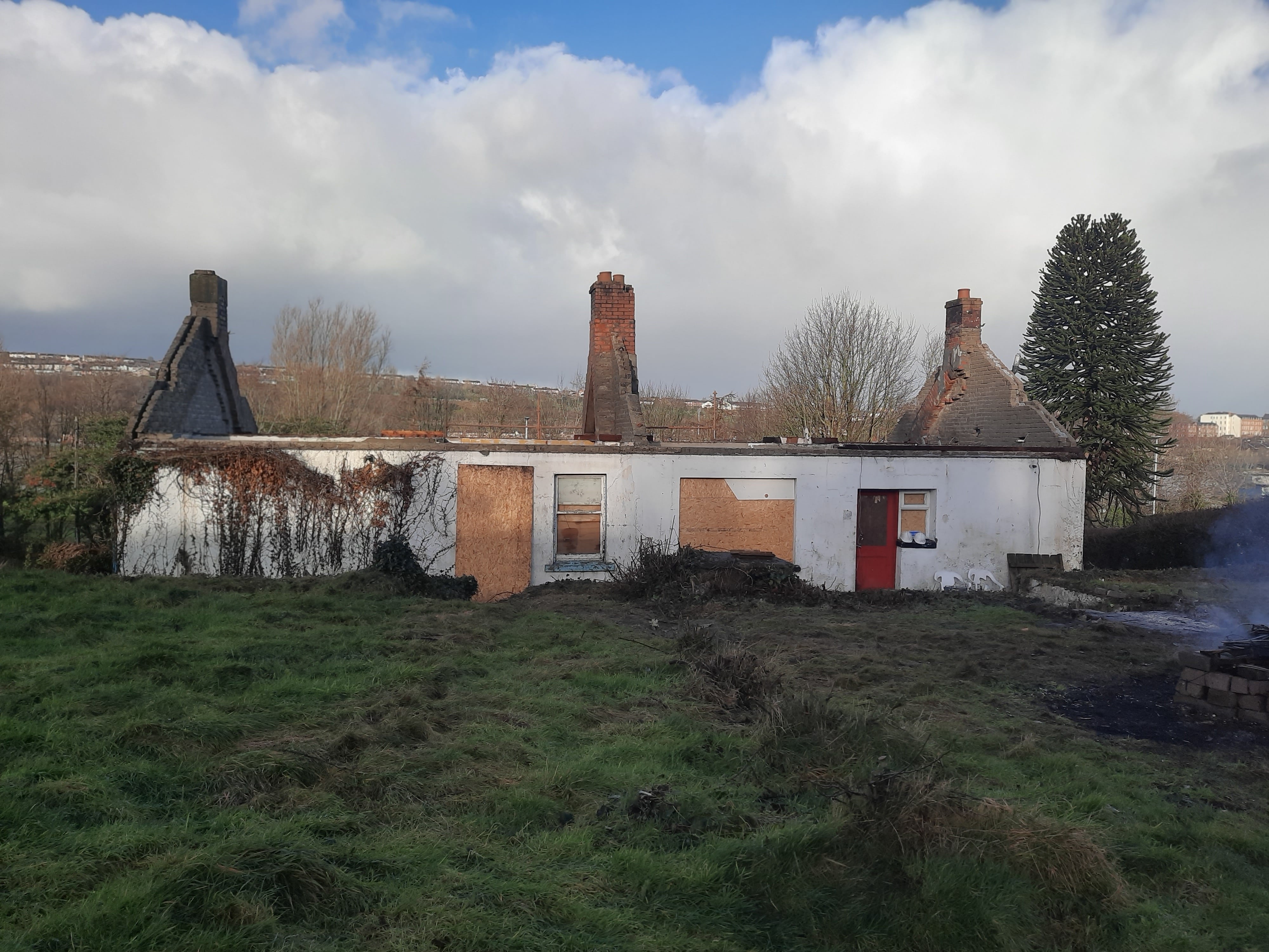

Edit to add the requested pics,the last one is obviously from today. Wood etc was stripped before it was tumbled, I had it boarded over christmas because I was concerned a child could get in.
The last pic was at the end when the discussion was re the fill and considering levelling up the garden at the front. Up to now you would need a rope on your back when using a lawnmower. The old driveway was to the front left but you would need a tractor to get up it. Total clutch wrecker.
I will try and pull some footage too.
