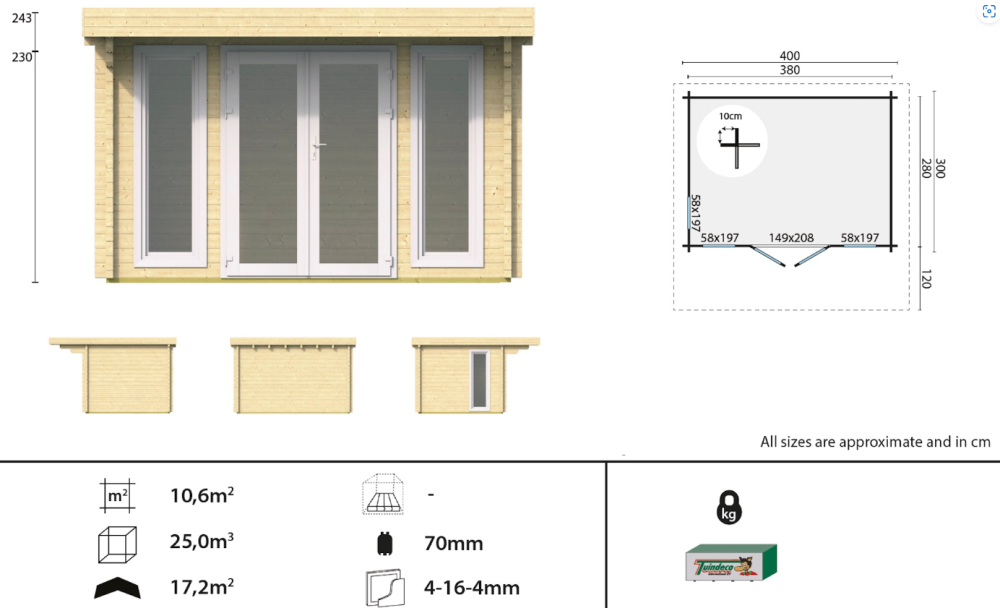

Iceverge Posted January 9, 2023 Share Posted January 9, 2023 Ok I think I know where you're at. You've bought something like the below off the shelf. It needs a base and a roof and you're planning on a thermal upgrade to boot? Link to comment Share on other sites More sharing options...

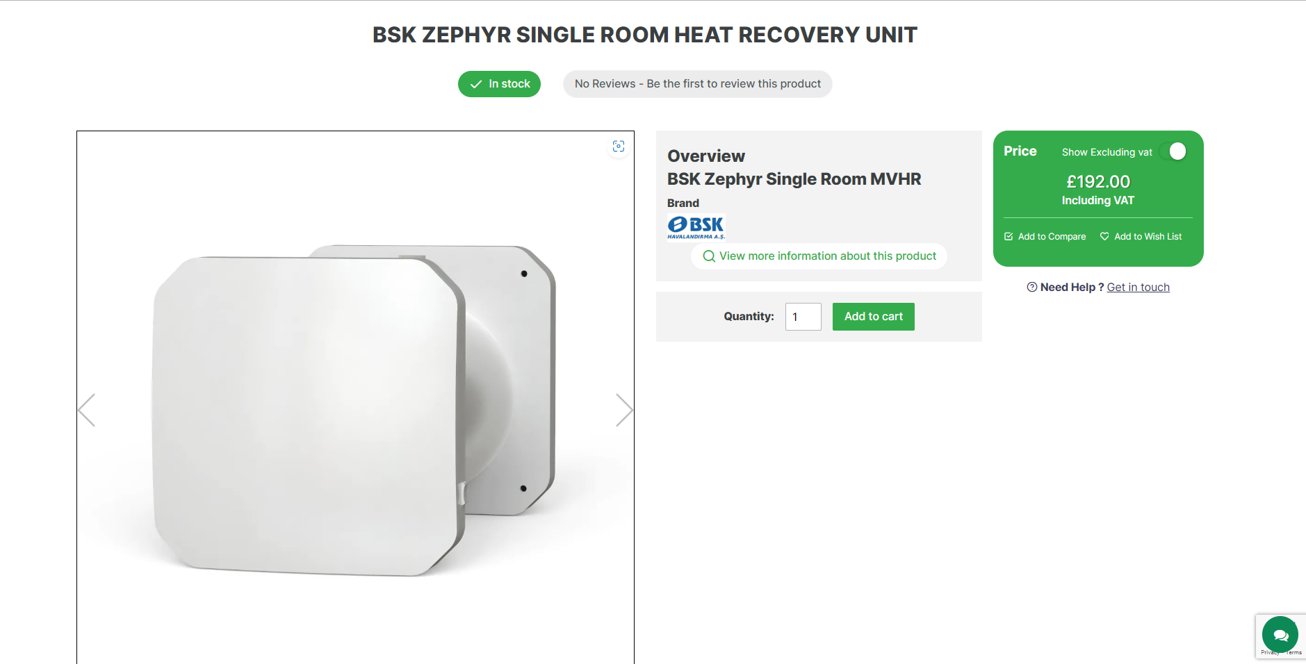

JohnMo Posted January 9, 2023 Author Share Posted January 9, 2023 Thanks for the suggestions, never thought about chicken wire. Fair bit of tree shading until mid afternoon, and about 5m by just under 4m footprint, double glazed windows. The MVHR unit looks a good choice. Link to comment Share on other sites More sharing options...
JohnMo Posted January 9, 2023 Author Share Posted January 9, 2023 43 minutes ago, Iceverge said: think I know where you're at That's almost the same as ours. 31 minutes ago, SteamyTea said: Why not A2AHP That was the original plan, but managed to pick up a new ASHP that will do this and the house, for very little money. Link to comment Share on other sites More sharing options...

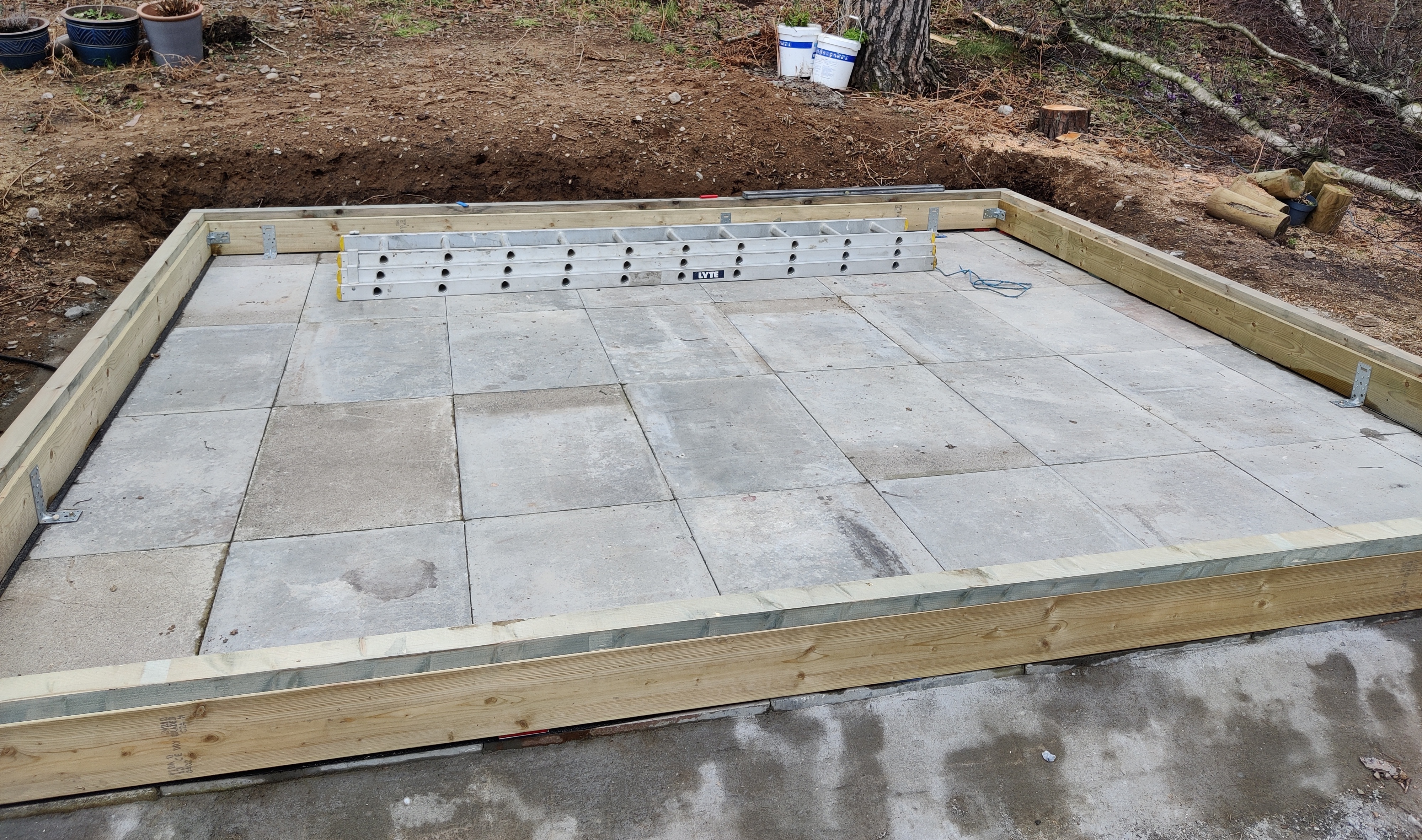

JohnMo Posted March 19, 2023 Author Share Posted March 19, 2023 Now started the build. Base formed with 3x2 council slabs on concrete. Asked for the bases to be flat and level, overall it not, there is 12mm run off over about 4m. Compensated so far with shims. So above the base to form a space for floor insulation, floor and an overhang for decking have built a frame using 2x 170mm X 45mm timber. This is under the floor framing that came with the kit. Floor buildup will be as follows. DPM, 100mm EPS100, 50mm EPS100, slip membrane, 2x layers of 9mm OSB, glued and screwed with staggered joints, 50mm battens at 400mm centers, infilled with 50mm UFH EPS mouldings, with UFH pipes at 115mm centres. This will be overlayed with tongue and groove flooring. Overall there will be 200mm of EPS 100 insulation in the floor. Walls next Link to comment Share on other sites More sharing options...
Iceverge Posted March 19, 2023 Share Posted March 19, 2023 47 minutes ago, JohnMo said: DPM, 100mm EPS100, 50mm EPS100, slip membrane, 2x layers of 9mm OSB, glued and screwed with staggered joints, 50mm battens at 400mm centers, infilled with 50mm UFH EPS mouldings, with UFH pipes at 115mm centres. This will be overlayed with tongue and groove flooring. Overall there will be 200mm of EPS 100 insulation in the floor. Interesting. Please keep us updated with pics. Have you considered moving the DPM above one layer of EPS to prevent it getting punctured? How do you plan to run the UFH? Link to comment Share on other sites More sharing options...
JohnMo Posted March 19, 2023 Author Share Posted March 19, 2023 1 hour ago, Iceverge said: Have you considered moving the DPM above one layer of EPS to prevent it getting punctured? Good suggestion, just move the 50mm to the bottom, then dpm. 1 hour ago, Iceverge said: How do you plan to run the UFH? Running pipes in this https://www.thefloorheatingwarehouse.co.uk/product/thermrite-joisted-floor-insulation-panel-3-grooves-at-115mm-centres/ Simple 2 port manifold, https://underfloorheating1.co.uk/product/premium-2-port-underfloor-heating-manifold?/?utm_source=googleads&utm_medium=paid&utm_campaign=performance-max&gclid=CjwKCAjw5dqgBhBNEiwA7PryaEz_YJ3XV-YLCC8pyi_QoZP6WTWi1QF9p9tlzNyb1WMcRo0CyNccYRoCibkQAvD_BwE Two loops of around 50m, driven by ASHP, giving heating and cooling. Link to comment Share on other sites More sharing options...

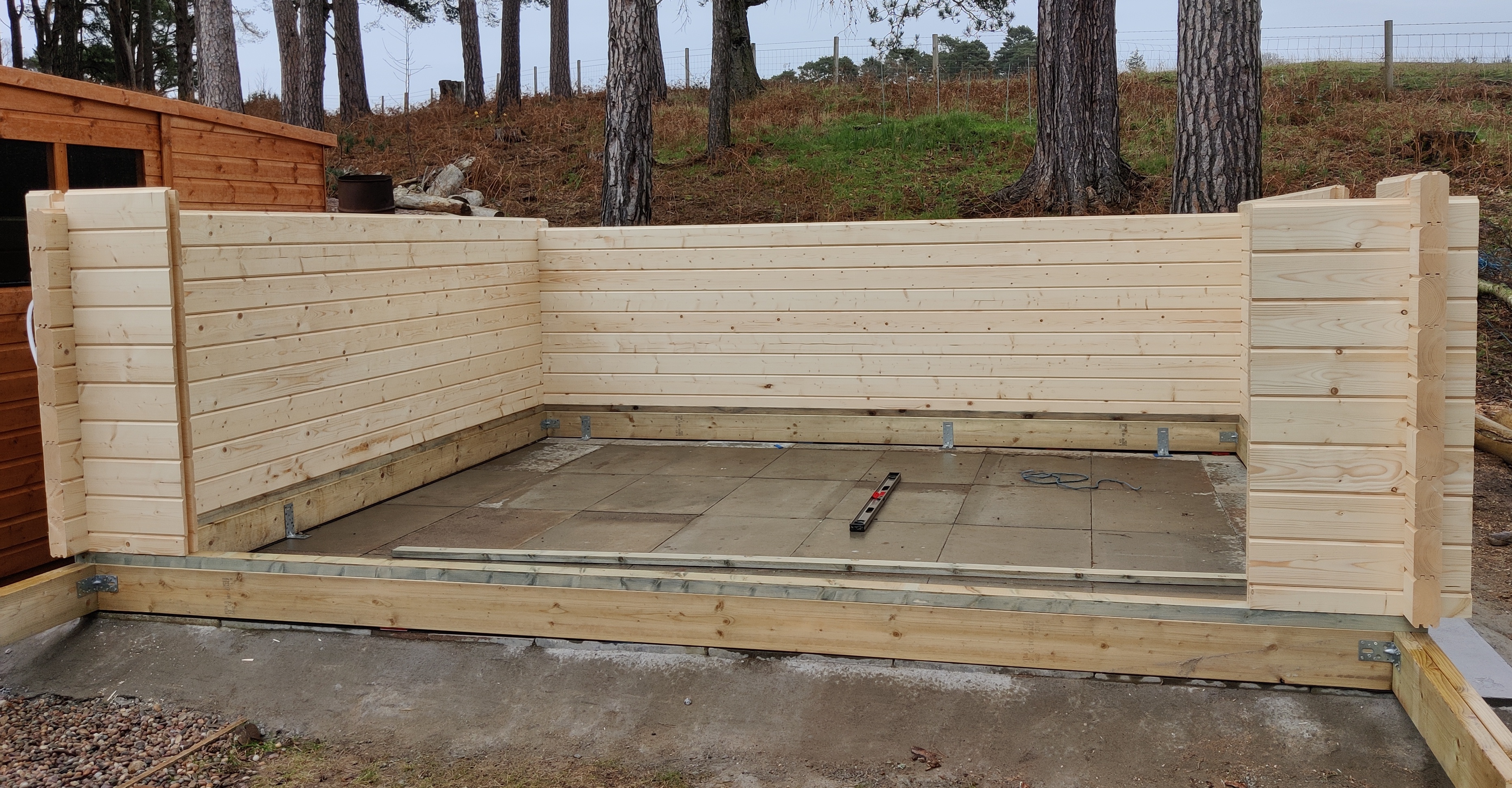

JohnMo Posted March 20, 2023 Author Share Posted March 20, 2023 Some progress today before the rain. 2 Link to comment Share on other sites More sharing options...

Iceverge Posted March 20, 2023 Share Posted March 20, 2023 Seems a shame to cover up all that lovely wood with insulation now! I assume the boards at the base will disappear once the concrete has cured further? Link to comment Share on other sites More sharing options...
JohnMo Posted March 21, 2023 Author Share Posted March 21, 2023 7 hours ago, Iceverge said: I assume the boards at the base will disappear once the concrete has cured further The boards at the base are there for ever. That is the base frame the cabin sits on and will be filled with insulation inside and form the floor. The bits at the front will never be seen as there will be a cantilevered small deck with a step hiding it. 1 Link to comment Share on other sites More sharing options...

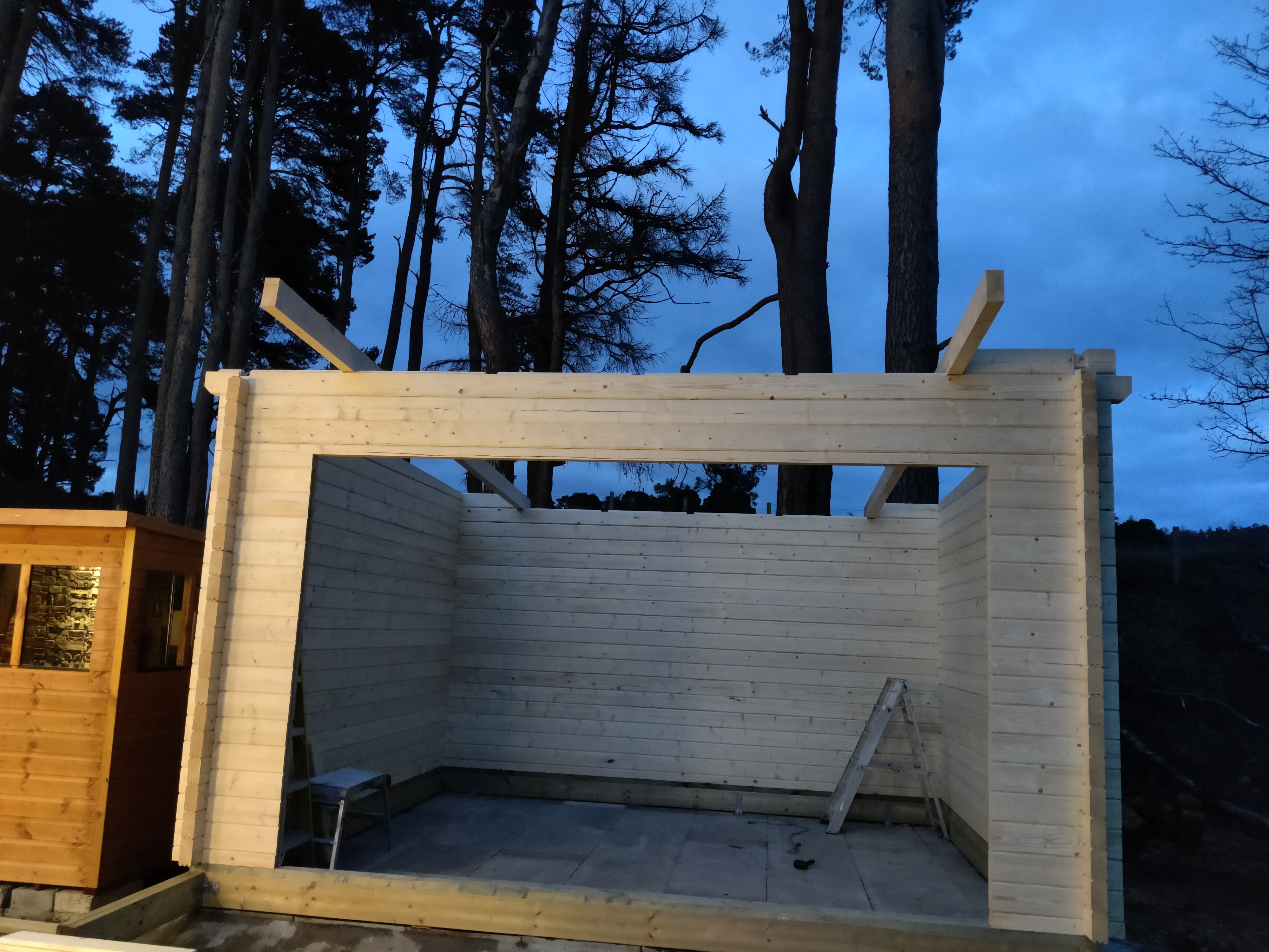

JohnMo Posted March 21, 2023 Author Share Posted March 21, 2023 Day 2 progress. Stripped walls down to board level 3 (removing about 7 layers) as one of the logs was twisted and caused a big run off at one corner. Built the walls back up and now at roof level. Used the twisted logs at the higher levels, bit of a faff but all good. 1 Link to comment Share on other sites More sharing options...
