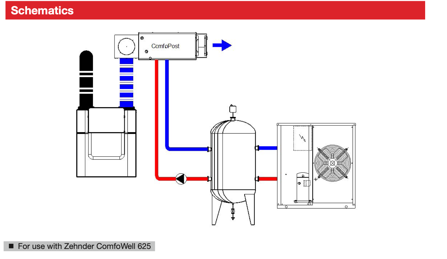

BartW Posted January 4, 2023 Posted January 4, 2023 Hi, I am having the Q350 and Comfo Post delivered for our self build, and while the schematics seem plain and simple: I wonder how to best connect and control the Comfo Post here. The heating system will be driven by ASHP (Vaillant Aero Therm Plus with UniTower) with a cooling option (resistor). How do I best control the flow through the ComfoPost: - as it happens I am siting a UFH manifold in the loft right next to where this unit is going. Could it be a good idea to either tap into the supply pipe to the manifold - or perhaps add a separate zone / port to the manifold and run off of that? The downside is that if this local manifold gets no call for heat "pump operation" there would be no flow at all regardless of whether the zone be open. The benefit of the latter would be ability to open and close the circuit. Also the loop would be super short and would run through a pump that would be fairly local there. Or I could leave this port "always open" and assume that when I run heating, I would automatically have demand for additional heat through the vents. In reverse, i.e. for cold air the same would happen with cold air being added in. Otherwise, how would one logically control this above scenario? Thanks! Bart
Dan F Posted January 5, 2023 Posted January 5, 2023 3 hours ago, BartW said: How do I best control the flow through the ComfoPost: You can use a dedicated mixed Vaillant circuit for Comfopost if you want which will allow you to control circuit temperature independantly. Alternatively, if comfopost circuit will always be the hottest/coldest circuit you can just use a circuit with a zone-valve but not mixer or temp sensors. 3 hours ago, BartW said: Could it be a good idea to either tap into the supply pipe to the manifold You don't want to tap off the UFH manifold. UFH will need to run at different temperature. Need to be prior to UFH mixer. Do you have someone designing and installing ASHP? Once set up as two circuits you can contol them UFH and Comfopost as seperate zones with different controllers (which as as zone thermostats). The CW12 is a big unit, especially given the small Zehender Q350! What is the thinking?
BartW Posted January 5, 2023 Author Posted January 5, 2023 5 minutes ago, Dan F said: You can use a dedicated mixed Vaillant circuit for Comfopost if you want which will allow you to control circuit temperature independantly. Alternatively, if comfopost circuit will always be the hottest/coldest circuit you can just use a circuit with a zone-valve but not mixer or temp sensors. You don't want to tap off the UFH manifold. UFH will need to run at different temperature. Need to be prior to UFH mixer. Do you have someone designing and installing ASHP? Once set up as two circuits you can contol them UFH and Comfopost as seperate zones with different controllers (which as as zone thermostats). The CW12 is a big unit, especially given the small Zehender Q350! What is the thinking? Hi, So, I am doing the whole thing myself. Design included. Yes, I saw Vaillant list a part that attaches directly to UniTower, and that is designed for totally separate zoning. I think it comes with a built-in own pump too. One of these? (part ending 507,8,9). As for the CW12 being big, it was not flagged up to me that it was going to be too big for the unit. Paul Heat Recovery have done the design for the MVHR on this one.
Dan F Posted January 5, 2023 Posted January 5, 2023 (edited) 9 minutes ago, BartW said: As for the CW12 being big, it was not flagged up to me that it was going to be too big for the unit. Paul Heat Recovery have done the design for the MVHR on this one. CW12 is designed for 550 m3/h->. Max airflow for Q350 is 350 m3/h, but if you are using this unit then I assume you design flow rate is actually more like 250m3/h? There is an argument to oversize ComfoPost somewhat, but in this scenario IMO CW12 is just bigger and more money and not going to improve heating/cooling power. You know to expect very little heating power from Comfopost and significanlty less cooling power from Comfopost, right? Also, that all ducting shoud be insulated? Did Paul calculate and tell you what kW heating/cooling power you'll get from the system? 9 minutes ago, BartW said: So, I am doing the whole thing myself. Design included. I suggest downloading all the manuals, including the sensoComfort manual which details the use of VR71, and reading them front to back. There are cost savings with doing this yourself of course, but there are also risks. Not clear what is in those kits in parts list. Edited January 5, 2023 by Dan F
BartW Posted January 5, 2023 Author Posted January 5, 2023 2 minutes ago, Dan F said: 11 minutes ago, BartW said: CW12 is designed for 550 m3/h->. Max airflow for Q350 is 350 m3/h, but if you are using this unit then I assume you design flow rate is actually more like 250m3/h? In this scenario IMO CW12 is just bigger and more money and not going to improve heating/cooling power. You know to expect very little heating power from Comfopost and significanlty less cooling power from Comfopost, right? Also, that all ducting shoud be insulated? Yes, all ducts are to be insulated. I need to check the calcs that PHR provided, but the assumption was the bigger the CW unit the more heat it was going to put through regardless of flow. Yes, I was not expecting for Comfopost to provide too much of a difference, although I was hoping it would “help”. am I being naive?

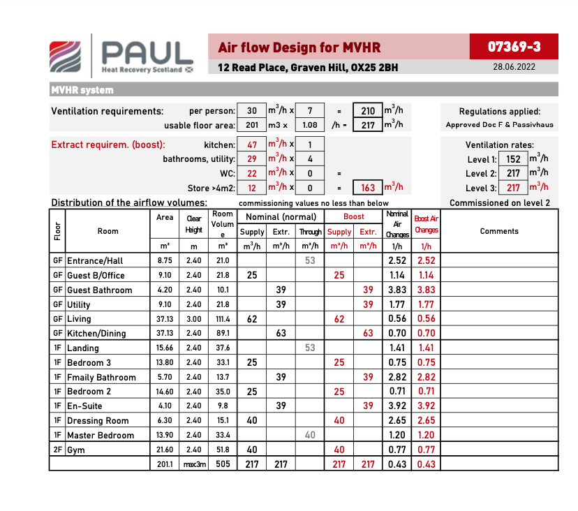

Dan F Posted January 5, 2023 Posted January 5, 2023 4 minutes ago, BartW said: Thanks Dan Sounds like you have been there and done that. I will quiz the supplier tomorrow and maybe change that bit on the order or ditch completely… Get you design flow rates and share these. Also, how were you planning to use ComfoPost? - Whole house or just first-floor. - Heating, cooling or both? Will you be cooling UFH too?

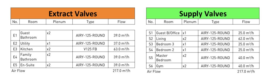

BartW Posted January 5, 2023 Author Posted January 5, 2023 6 hours ago, Dan F said: Get you design flow rates and share these. Also, how were you planning to use ComfoPost? - Whole house or just first-floor. - Heating, cooling or both? Will you be cooling UFH too? Hi, yes ufh for cooling too. Comfopost for the whole system, both heat as well as cool. flows attached.
Dan F Posted January 5, 2023 Posted January 5, 2023 (edited) So ground floor is UFH+ComfoPost and fist-floor is just ComfoPost? Any idea if those value are normal flow rates or boost rates? Did they calculate any heating/cooling power output from Comfopost? Edited January 5, 2023 by Dan F
BartW Posted January 5, 2023 Author Posted January 5, 2023 Hi, This is UFH + Comfopost on all three floors. Flow rates, let's see...

Dan F Posted January 7, 2023 Posted January 7, 2023 On 05/01/2023 at 12:28, BartW said: Hi, This is UFH + Comfopost on all three floors. Flow rates, let's see... Given 217m3/h, the best (theoretical) outputs you can expect are going to be: - Heating 2.3kW (assuming 50% RH, 21 inside temperature, -2C outside temperature, 90% efficient MVHR and 55C ASHP flow rate) - Heating 1.6kW (assuming 50% RH, 21 inside temperature, 7C outside temperature, 90% efficient MVHR and 45C ASHP flow rate) - Cooling 1kW sensible (assuming 50% RH, 21 inside temperature, 35C outside temperature and 90% efficient MVHR, and 7C ASHP flow rate). You'll also get dehumification on top of this. So heating may be somewhat significant, depending on your heat loss, but it's an inefficient way of heating that won't get you same COP vs UFH; with my ASHP it means 2.4 COP (@-2C) vs. 3.6). The (sensible) cooling output is low though. It's impotant to look at these numbers within the context of you heating/cooling load and other emitters you have planned though. It would worth getting CW8 for these flow rates, and not the CW6, so you are at the low end of the recommended flow rates. But, there is no reason to get CW10/CW12 unless you increase these flow rates a fair amount, which would probably mean a larger MVHR unit too. (CW10/CW12 do have slightly reduced pressure loss, but this is minimal)
