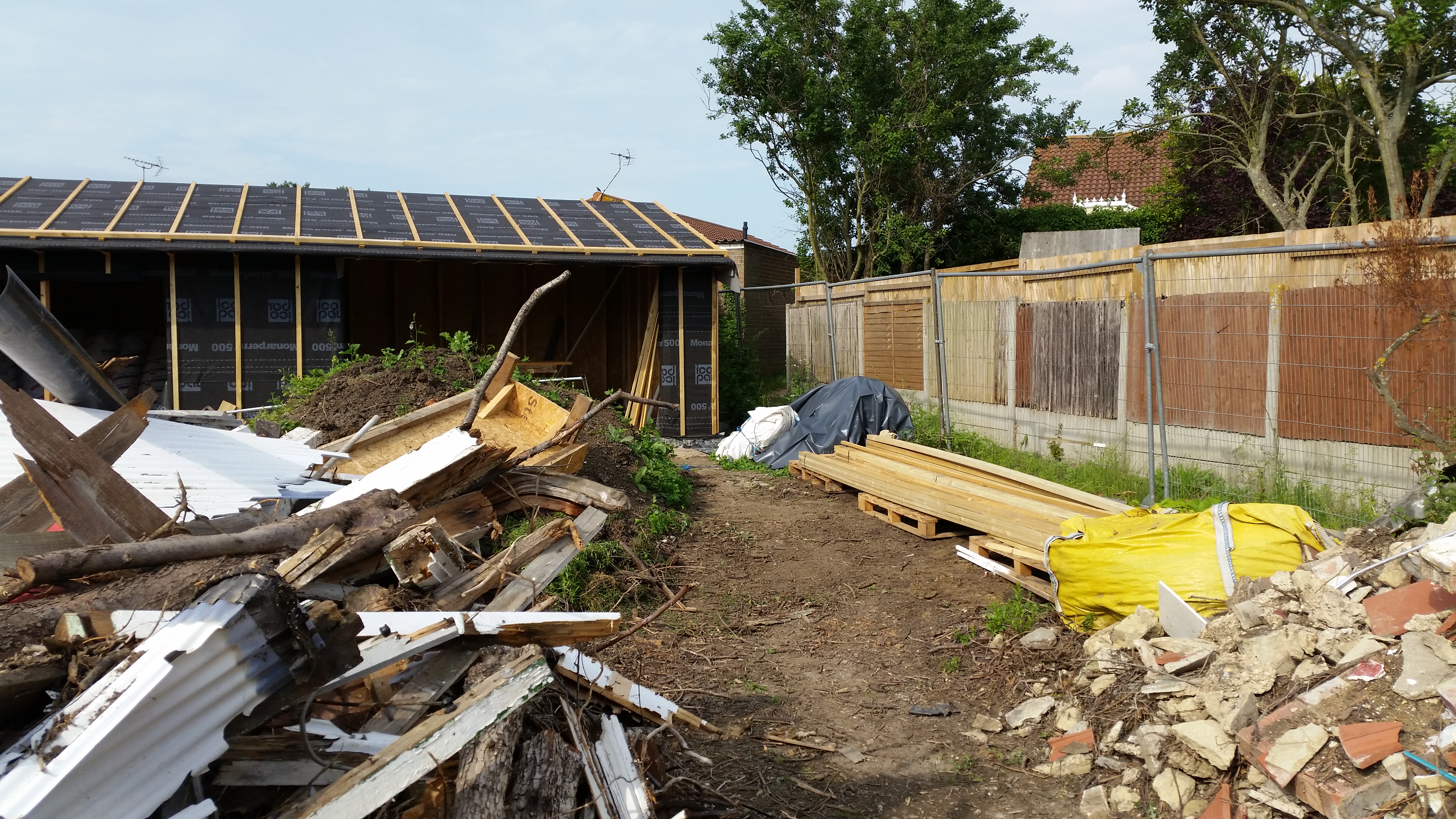

MikeSharp01 Posted July 14, 2017 Posted July 14, 2017 Here is a pic of our garden room with counter battens in place - if it helps, soon putting on the main battens at 90 deg to these. The roof build up is I-joists on 600mm centres, 11mm sarking (OSB), membrane, counter battens (25 x 50), tile battens 25 x 50 and then the tiles. 2
Crofter Posted July 14, 2017 Posted July 14, 2017 That photo should be quite helpful. TRADA recommends a minimum of 12mm counterbatten, but in practise everybody uses 25mm, probably less chance of it splitting or breaking. The battens are fixed right through the counterbatten and sarking, and into the rafters themselves, so the counterbattens are really just acting as a spacer.
