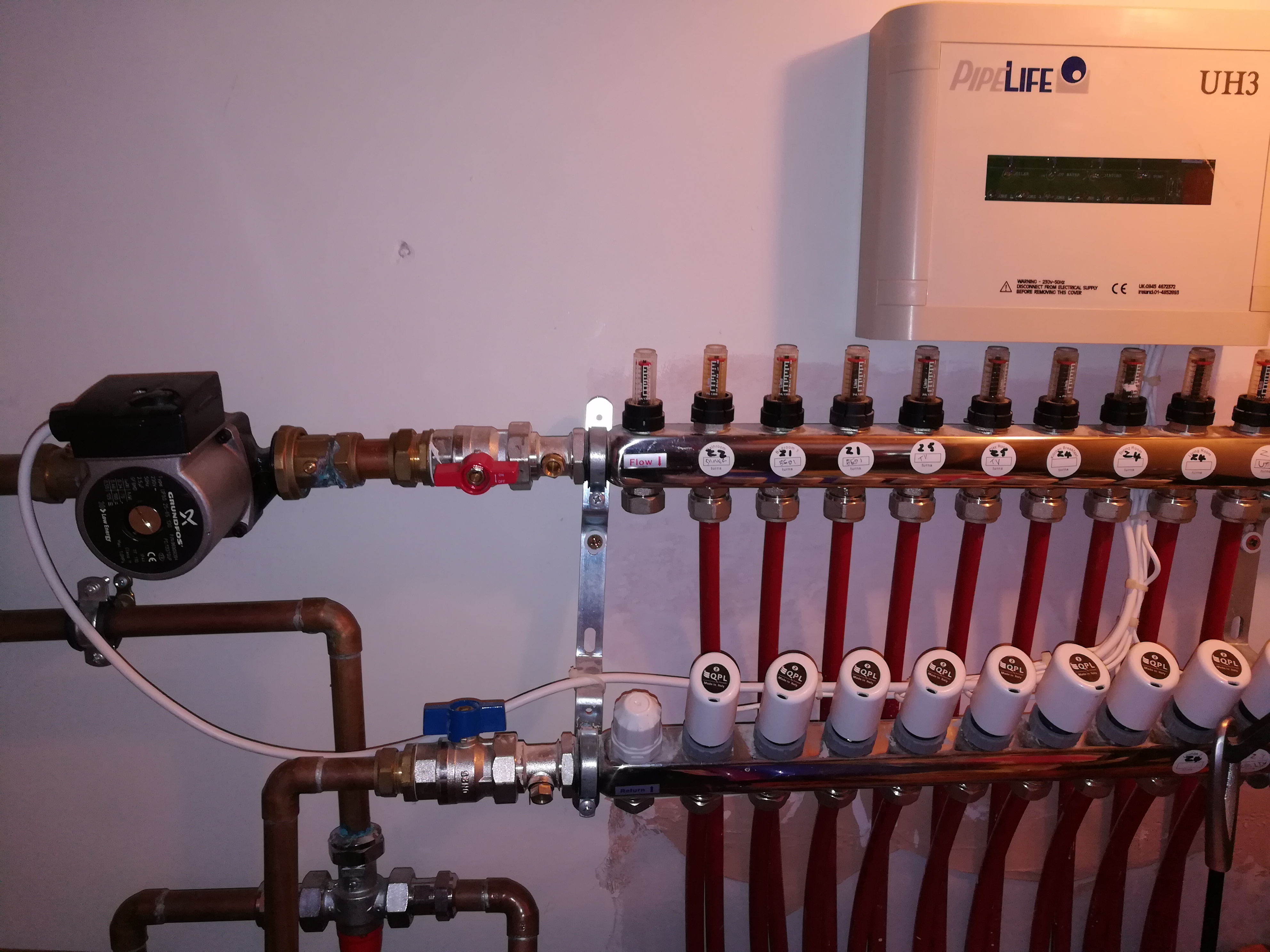

pudding Posted July 10, 2017 Author Share Posted July 10, 2017 Thanks for the quick reply. Here's a pic of my setup. Is the only way (without adding other stats/pumps) to get the water moving around the UFH loops to somehow set all of the room stats to call for 'heating' in order to open all of the room valves and turn the pump on? So I could set all of the room stats to call for a room temp of 30degrees, and with the GSHP and heating off, it will simply pump around the cool water and never meet the demand of 30degs? Link to comment Share on other sites More sharing options...
PeterW Posted July 10, 2017 Share Posted July 10, 2017 You may have to bypass the TMV - it will be set to a specific temperature and will be trying to provide that to the floor. May be worth looking at a zone valve "shunt" that when cooling is called it opens the valve and lets the pump go open circuit. Even with that you may find unless there is a cooler part of the house you will just be moving the heat elsewhere in the house. Link to comment Share on other sites More sharing options...
IanR Posted July 10, 2017 Share Posted July 10, 2017 Could there not be greater benefit from a more significant re-plumb? Ideally, you would get the fluid in your ground loops directly circulating (via a blending valve) around your UFH loops to allow "passive" cooling. You'd need to be able to isolate the GSHP and the Buffer from the UFH and to link the supply and return from the ground loops to the UFH pump, as well as opening all the actuators on the UFH manifold(s). The added benefit is that the energy dumped from your house would help re-charge the ground around your ground loops. Link to comment Share on other sites More sharing options...

le-cerveau Posted July 10, 2017 Share Posted July 10, 2017 @pudding I see the biggest problem that you are using UFH with zones, where @JSHarris has a unified system with only one large zone. Your zone stats will close off the respective loops above the call for heat temperature so you will be unable to circulate the cool water. You will require a wiring re-configure to override the zones to allow a flow of water. So you will need a second stat in any zone you want cooling and when it is activate (call for cooling) it opens the zone valve in the same manned as a call for heat stat. Then you need to isolate the DHW system. Your GSHP may require re-configuring to allow you to access the ground loop (brine), however a quick look at the Valliant web site does not indicate that they have a cooling function (some manufactures provide additional cooling units). It may be easier to directly tap into the brine circuit before/after the GSHP and just insert a heat exchanger to take the cooling from, personally I would keep the 2 circuits hydraulically separated, otherwise it could get messy. I suspect this will require some considerable either plumbing and electrical re-wiring to work as you desire. Link to comment Share on other sites More sharing options...
pudding Posted July 10, 2017 Author Share Posted July 10, 2017 Thanks for the replies all. Yes i think it seems like it not going to work without some quite significant re-wiring/plumbing, and at best all i'll be able to do is re-distribute the heat from the directly solar-heated sections elsewhere without that work. Oh well, next is to see if i can link my recently bought portable air-con into the MVHR without issues. Link to comment Share on other sites More sharing options...
