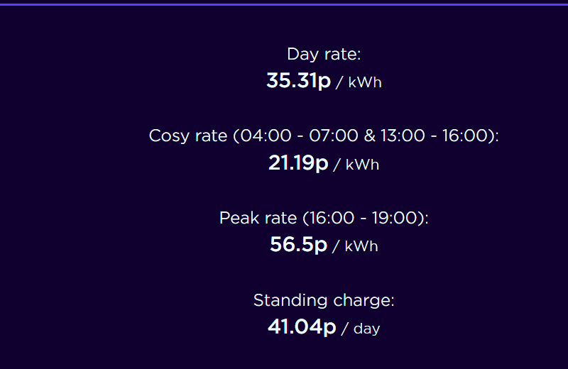

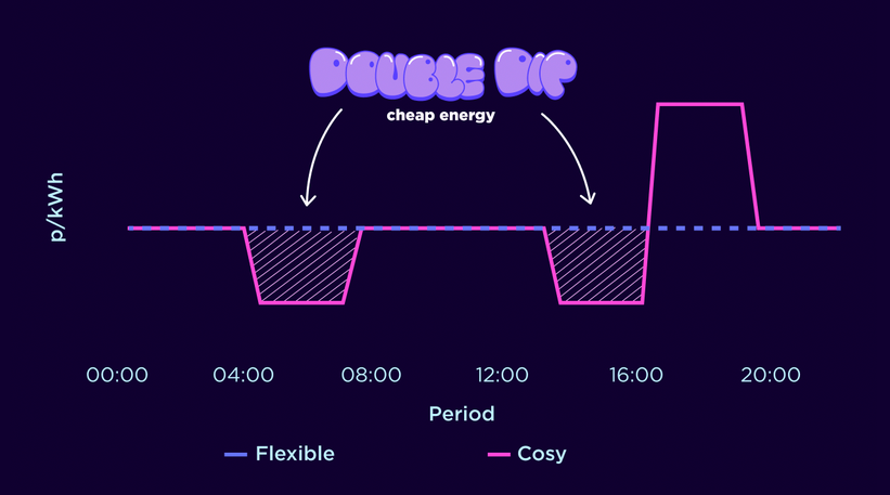

George Posted December 21, 2022 Posted December 21, 2022 Bit of PSA, while it's probably cost neutral for me at the moment, if combined with a battery it'd be a decent cost saving. Although I don't have a smart meter so can't get it Two low/off-peak times and one peak time in the evening: On the website said ~20p off, 50p peak and 33p in-between. https://octopus.energy/cosy/ EV Man's youtube video on it: https://www.youtube.com/watch?v=2XkWWdJ2ga4
ProDave Posted December 21, 2022 Posted December 21, 2022 It's that pesky 4pm to 8pm silly high peak that I don't want.
Luke1 Posted December 21, 2022 Posted December 21, 2022 In my area the peak is quite high. (Note this is a flexible tariff and so it will go up when the price cap changes!) Unfortunately I can't see this working for most people that cook during the peak. Made worse by the fact that for approximately 6 months of the year you won't really be benefiting at all from the 'cosy rate' as you wont need heating. My fix ends at the end of January so I'm trying to find other deals and suppliers that may work better for me. EDF have a E7 flexible tariff which is currently 0.07p/kWh night and 0.055p/kWh day. Which actually works better for me than the Cosy deal. I have also worked out that I could possibly 'save' ~£1000/year if I installed a 9kWh battery based on those rates. ROI approx 6 years at today's rates. However with the market being so unstable it's a big risk to know whether the E7 rates will always be this low in the cheap hours, especially with ever increasing EV charging on the grid.

PhilT Posted December 21, 2022 Posted December 21, 2022 It's got some attractions. The morning period is not far off our current switch on and get up times. The afternoon period is the time of highest daily temps = best heat pump efficiency, and we still use gas for cooking.

Dreadnaught Posted December 21, 2022 Posted December 21, 2022 It struck me when I saw this tariff that the second afternoon cheap window could be a good time to heat the DHW cylinder when the heat pump needs to work at its hardest. Overnight on the other hand would be good for space heating. (I have no PV, nor a battery). 2 hours ago, Dave C said: heat pump just can't modulate low enough I am presently negotiating with the wholesaler supplying my ASHP to swap the 5kW model that I originally ordered for the smaller 3.5 kW model exactly for this reason. 2 hours ago, Dave C said: it's more like 7 months of the year for me, that I don't need any heating This is a good point.
