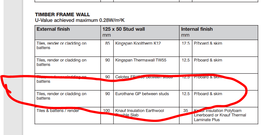

Iceverge Posted December 19, 2022 Share Posted December 19, 2022 @Gus Potter I agree. I hope my use of cheapest didn't imply poor quality. Maybe I should have emphasised the "proper" bit more. The above wall is very buildable while being economical and fast to build. It's possible to ensure a full fill of all the insulation visually and lightly to be much quicker to get a snug fit of mineral wool batts rather than PIR. The continuous vapour control layer and insulated service cavity is a very robust airtightness method. A well detailed external breather membrane will be an excellent wind tightness layer. Running the service cavity battens horizontally will cut repeating thermal bridges through the studs. 15mm sound bloc plasterboard will be ok at 600cc and provide better tear out capacity for picture screws as well as sound protection. Using 3x2s rather than 2x2s for the external ventilated cavity will prevent splitting. Better still use blown cellulose and widen the studs to 170mm or 220mm. Bellissimo! For a thin wall that would lightly not perform anywhere as well in reality and just scrape past the regs some thing like this from the LABC might be a suggestion. Link to comment Share on other sites More sharing options...
