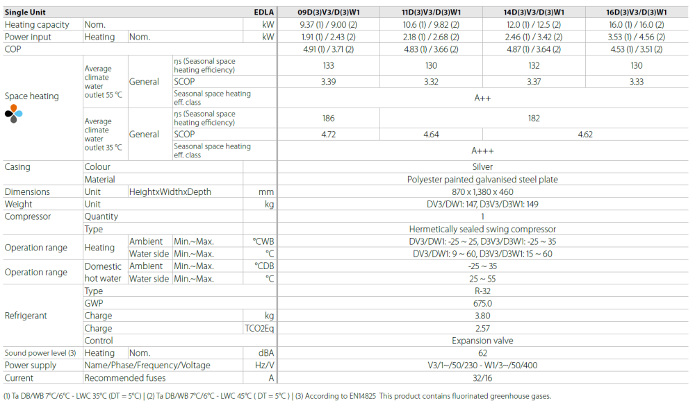

thefoxesmaltings Posted December 18, 2022 Share Posted December 18, 2022 About to pull the trigger on this ASHP. From what I can see, it's about 1 year old and has some pretty good efficiency stats. Wanted to ask if anyone has direct experience with this unit? Are you happy with the performance (particularly in this colder weather!) or wishing you had gone for a different unit? Also it's not clear if it uses an inverter driven compressor. i.e. so that it can run at variable speeds and not just 'off' and 'on'. Daikin state "Hermetically sealed swing compressor". Link to comment Share on other sites More sharing options...

dpmiller Posted December 18, 2022 Share Posted December 18, 2022 I'm having a total failure in the "trying to confirm it's inverter" department. I think it's not. Link to comment Share on other sites More sharing options...
Marvin Posted December 18, 2022 Share Posted December 18, 2022 41 minutes ago, dpmiller said: I'm having a total failure in the "trying to confirm it's inverter" department. I think it's not. And heat only? Link to comment Share on other sites More sharing options...

thefoxesmaltings Posted December 18, 2022 Author Share Posted December 18, 2022 1 hour ago, dpmiller said: I'm having a total failure in the "trying to confirm it's inverter" department. I think it's not. As in you don't think it can run at variable speeds? i.e. It can only run at full power "On", and "Off" Link to comment Share on other sites More sharing options...
Marvin Posted December 18, 2022 Share Posted December 18, 2022 15 minutes ago, thefoxesmaltings said: As in you don't think it can run at variable speeds? i.e. It can only run at full power "On", and "Off" So not good for hot water as well? Link to comment Share on other sites More sharing options...
dpmiller Posted December 18, 2022 Share Posted December 18, 2022 temperature is seperate to speed/ capacity. I can't see any info saying this is variable capacity. Link to comment Share on other sites More sharing options...
PhilT Posted December 18, 2022 Share Posted December 18, 2022 https://saturnsales.co.uk/images/products/editor/Daikin_Altherma_3_Monobloc.pdf says inverter driven, and can do heating, reversable heating and cooling. Looks pretty impressive on paper - certainly the specs are up there with the other leading brands/models Link to comment Share on other sites More sharing options...
thefoxesmaltings Posted December 18, 2022 Author Share Posted December 18, 2022 16 minutes ago, PhilT said: https://saturnsales.co.uk/images/products/editor/Daikin_Altherma_3_Monobloc.pdf says inverter driven, and can do heating, reversable heating and cooling. Looks pretty impressive on paper - certainly the specs are up there with the other leading brands/models For some reason the datasheet on Daikin's website didn't have that information in the datasheet. Great find @PhilT - thank you. Link to comment Share on other sites More sharing options...
dpmiller Posted December 18, 2022 Share Posted December 18, 2022 where does it say inverter? Link to comment Share on other sites More sharing options...
