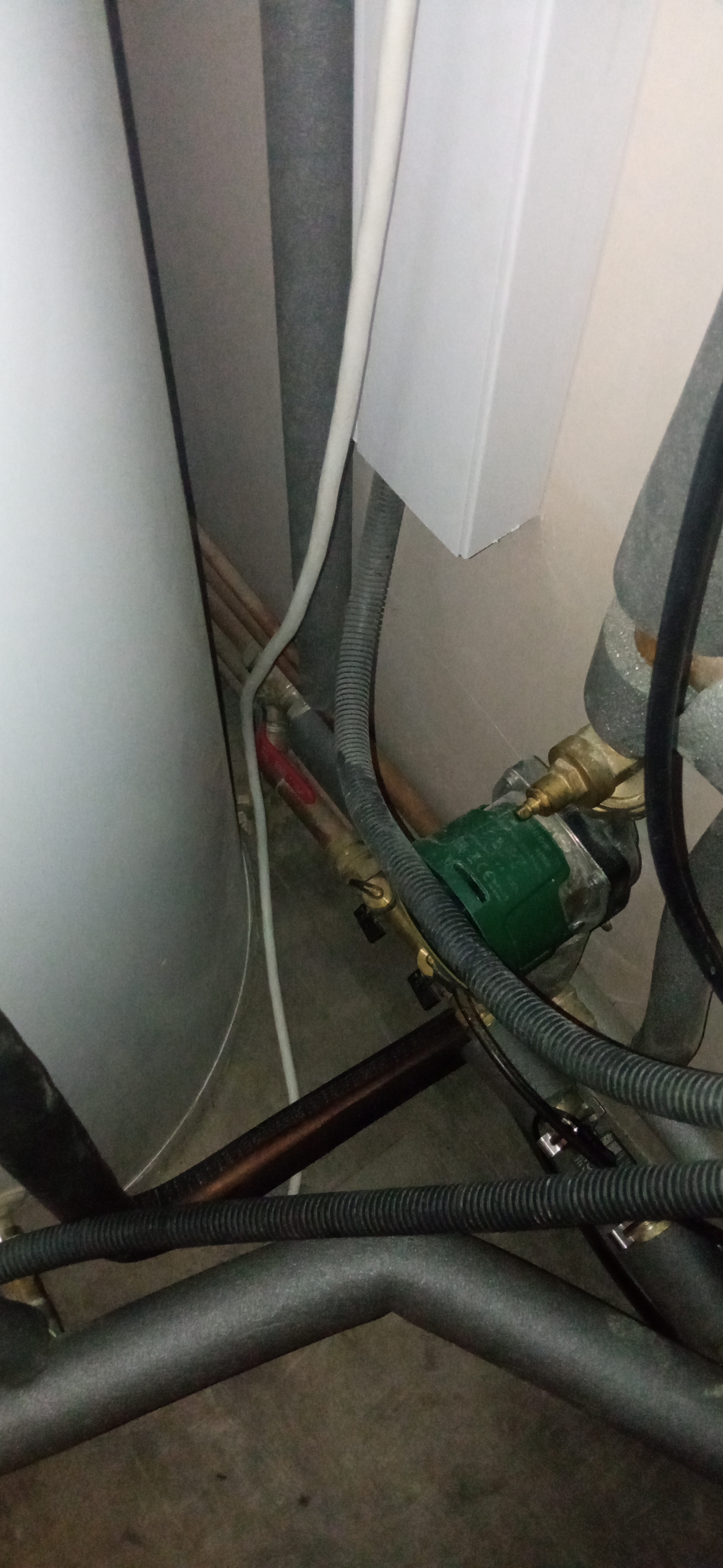

canalsiderenovation Posted December 17, 2022 Author Posted December 17, 2022 Righty we have followed the video and checked and cleaned the filter. No issues there. Turned everything back on and still nothing so it's obviously something more serious.

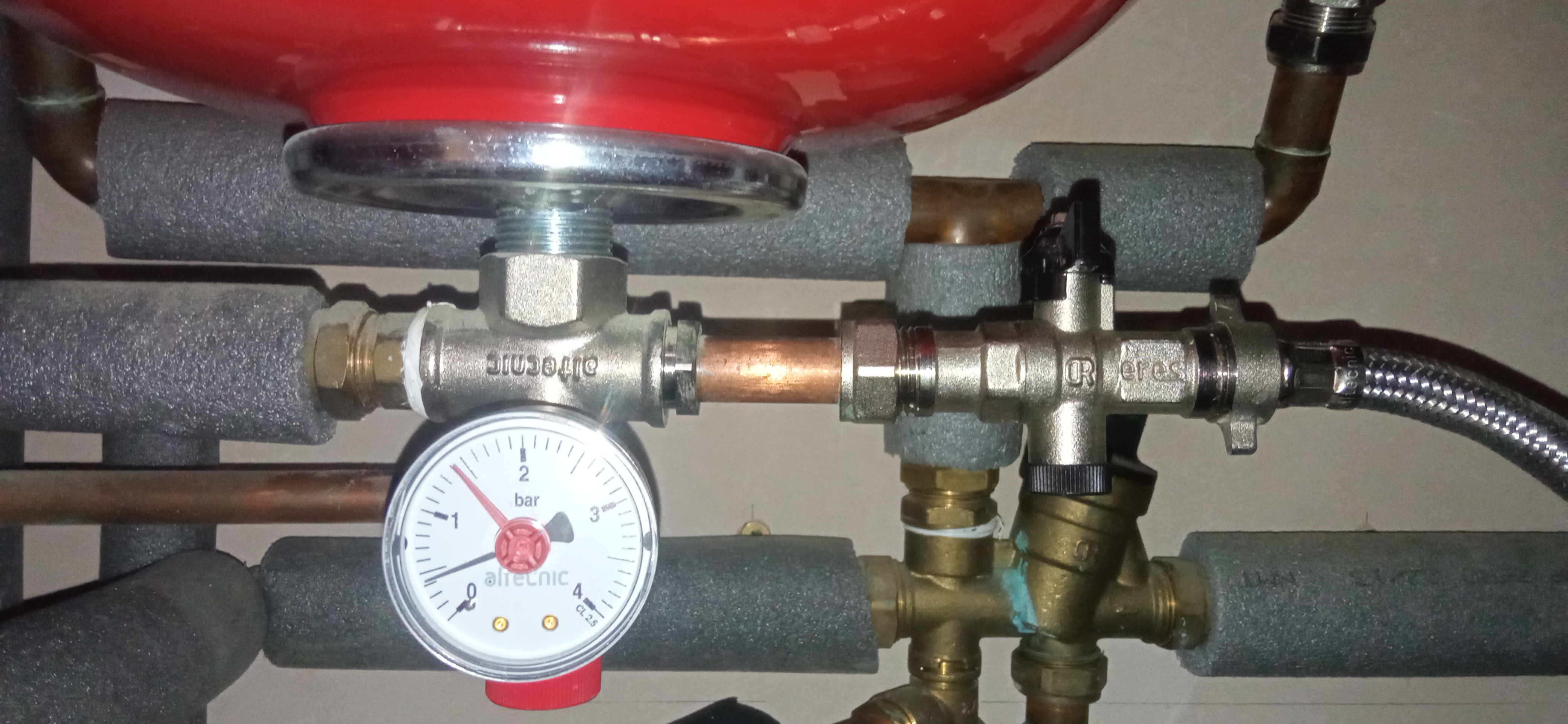

canalsiderenovation Posted December 17, 2022 Author Posted December 17, 2022 (edited) Ok so is it this that needs more water - some googling tells me that the black needle should be higher than the red one? The black tap to the right doesn't do anything though. Edit - done it and increased it to a about 1 bar but it's not that! Edited December 17, 2022 by canalsiderenovation
canalsiderenovation Posted December 17, 2022 Author Posted December 17, 2022 (edited) Solved it!!!! That red handle - turned it for 20 seconds or so then put it back and it worked. Everything back working again. No idea what's it's purpose is or what it did but it worked. Edited December 17, 2022 by canalsiderenovation 1

canalsiderenovation Posted December 17, 2022 Author Posted December 17, 2022 22 minutes ago, Jilly said: Well done! It’s very satisfying to sort stuff out, even if you don’t quite know why… The hot water is fine, it's heated the tank and the actual fan outside worked. I'm not completely convinced the heating is working. The stats are calling for heat but the actual heat pump fan isn't working outside 🤔 I'm waiting with baited breath to see if the floor gets warm and the temperature rises in the rooms but surely if the heating was working the fan should be working on the unit outside. 1
ProDave Posted December 17, 2022 Posted December 17, 2022 21 minutes ago, canalsiderenovation said: The hot water is fine, it's heated the tank and the actual fan outside worked. I'm not completely convinced the heating is working. The stats are calling for heat but the actual heat pump fan isn't working outside 🤔 I'm waiting with baited breath to see if the floor gets warm and the temperature rises in the rooms but surely if the heating was working the fan should be working on the unit outside. Most ASHP's only heat DhW or heating one at a time with priority given to hot water. Once your tank is up to temperature it should then start heating the rooms. Keep us posted.
canalsiderenovation Posted December 17, 2022 Author Posted December 17, 2022 (edited) 37 minutes ago, ProDave said: Most ASHP's only heat DhW or heating one at a time with priority given to hot water. Once your tank is up to temperature it should then start heating the rooms. Keep us posted. I turned the hot water off one I knew it had heated to 48 degrees and then turned the heating on in one room - gradually hoping to make sure things work. That's when the fan outside stopped working. The stats are calling for heat now but so far the outside fan hasn't come on, I'll see what happens and if the kitchen warms up. All very odd this is. Edit - working. Just checked and fan has kicked in. Hooray. Edited December 17, 2022 by canalsiderenovation Edit
