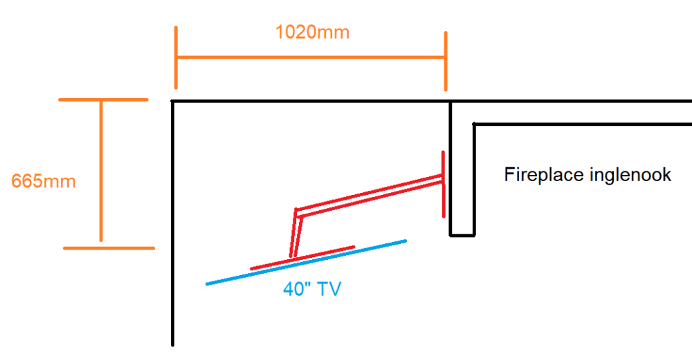

George Posted December 16, 2022 Posted December 16, 2022 Hello, Due to having small children and wanting to tidy up the corner of my living room I'd like to put the TV onto an arm bracket. The plan view is like this: The outer walls (those dimensioned) have internal wall insulation and while I do have the through fixings, it'd be simpler to just hook onto the brick inglenook wall. But I can't work out which swinging arm TV mounts allow rotation beyond 90 degrees. Does anyone know of any which would do this? If not I'll just have to attach to the insulated walls. Thanks.
markc Posted December 16, 2022 Posted December 16, 2022 Haven’t seen anything specifically like that but I mounted similarly using a big adjustable mount that had two folding arms to allow it to pull out and turn either way, if both arms unfolded then it would reach the side. Bear in mind the fixings and cantilever load mounting from one side. These loads on the fixing will be many times that of centrally mounting.

George Posted December 17, 2022 Author Posted December 17, 2022 Thanks all. The bracket finder was a good link - after some searching I can't seem to find anything with enough reach and rotation. I think what i'll do is attach a thick bit of plywood to the outside wall, or a few battens, (painted appropriately) then attach the bracket to that. Trying to get lots of thermal break stand off fixings at close enough centres for a bracket would not be feasible, but plywood/battens will give me much wider tolerance.
