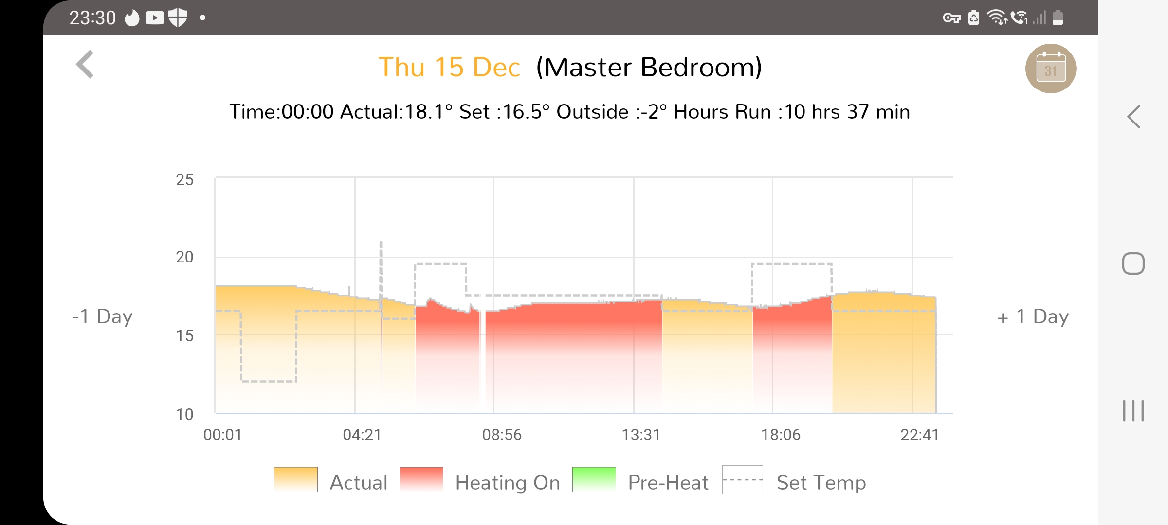

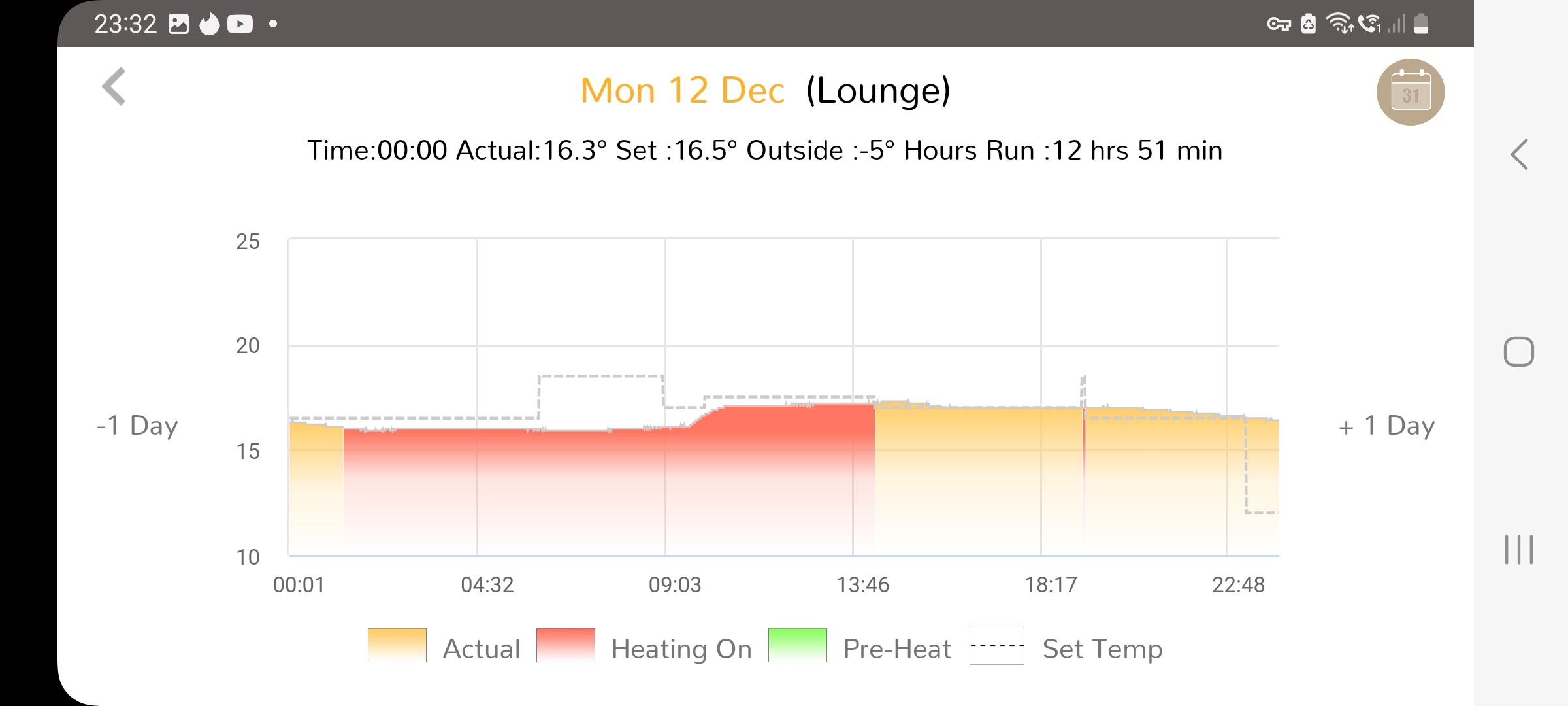

JohnMo Posted December 16, 2022 Posted December 16, 2022 Just looking at the dotted line on your graphs, which looks to be the thermostat set points. And the red part where it states heating is on. A couple of observations based on experience with my house. You have the heating on at various times and various temperature throughout the day. Looking at the red parts of the graphic your room temp is just about getting to temp and you switch it to a lower temp, then a few hours later a higher temp. So with floor inertia you boiler is playing catch up all the time. The other thing that may be happening you have multiple zone all programmed at differing times of the day. This is great, but in practice, you can have periods where you only have the lounge switched on, so the boiler is only being asked to do a couple couple of kWs of work, but the boiler may have a min output of 10kW. In practice this leads to the boiler short cycling. So boiler starts, a few minutes later trips on high return temps or minimum flow. Boiler is locked out for 10 mins, and this repeats until more zones are opened up. So why does this lead to poor heating performance and high consumption of gas. Short cycling, every time your boiler starts, the efficiency is low, it's heating a slug of cold water and lots of metal, once the boiler has been running for a 5 mins the efficiency climbs quickly. Continuous on off cycle means the boiler is in a low efficiency mode, the 10 min lock means no hot water is being pumped around. Timing efficiency, your floor is heating, you can see in the lounge at about 10am a big jump in temperature. So big it look like the flow temp is way too high. My recommendation as a trial, set all your thermostats to manual at say 19 degrees, and the boiler will have the whole UFH system to heat, see what happens. I suspect it will be fine and heat up quite quickly. If the temperature overshoots 19 then your flow temp is too high.

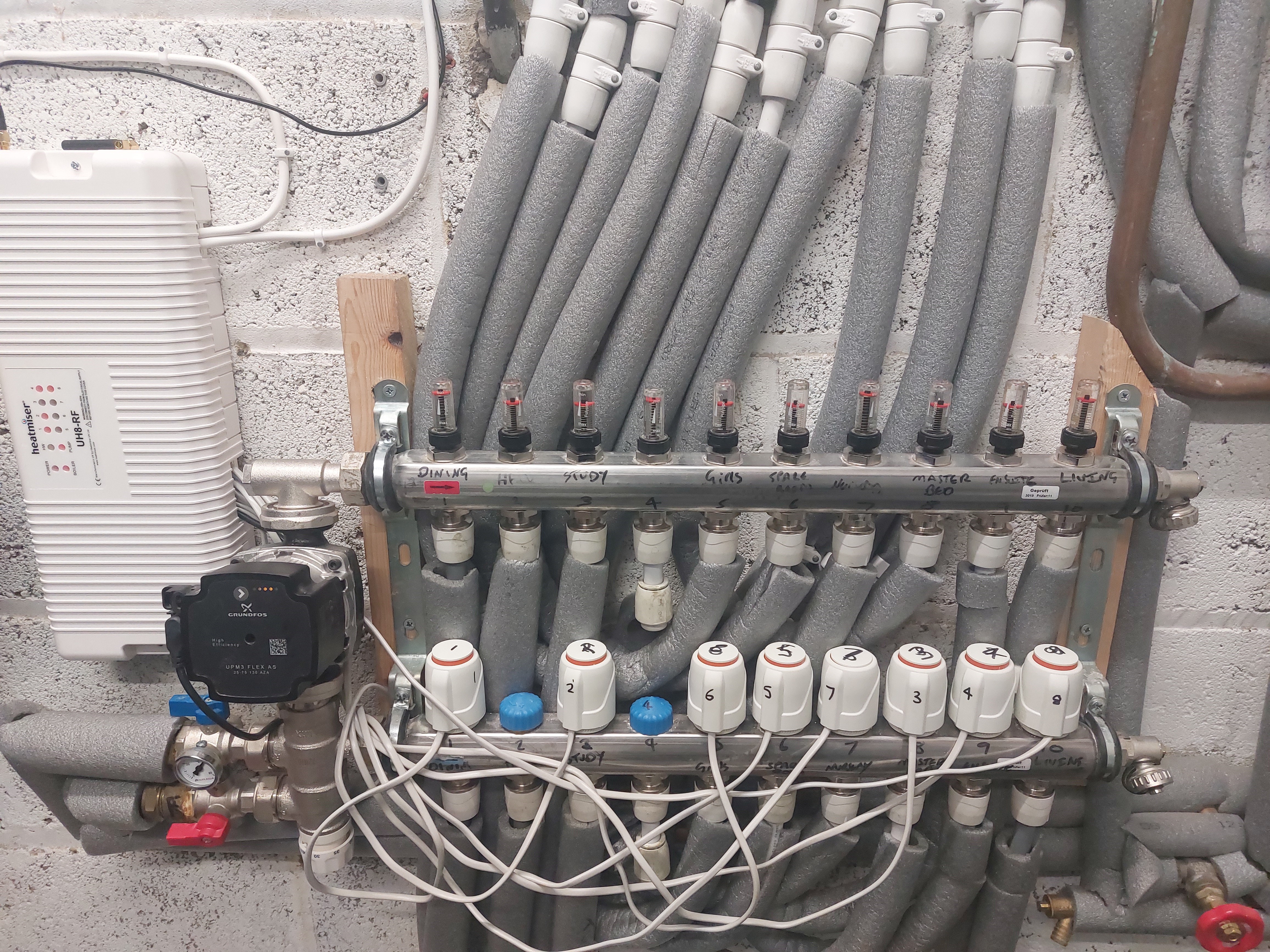

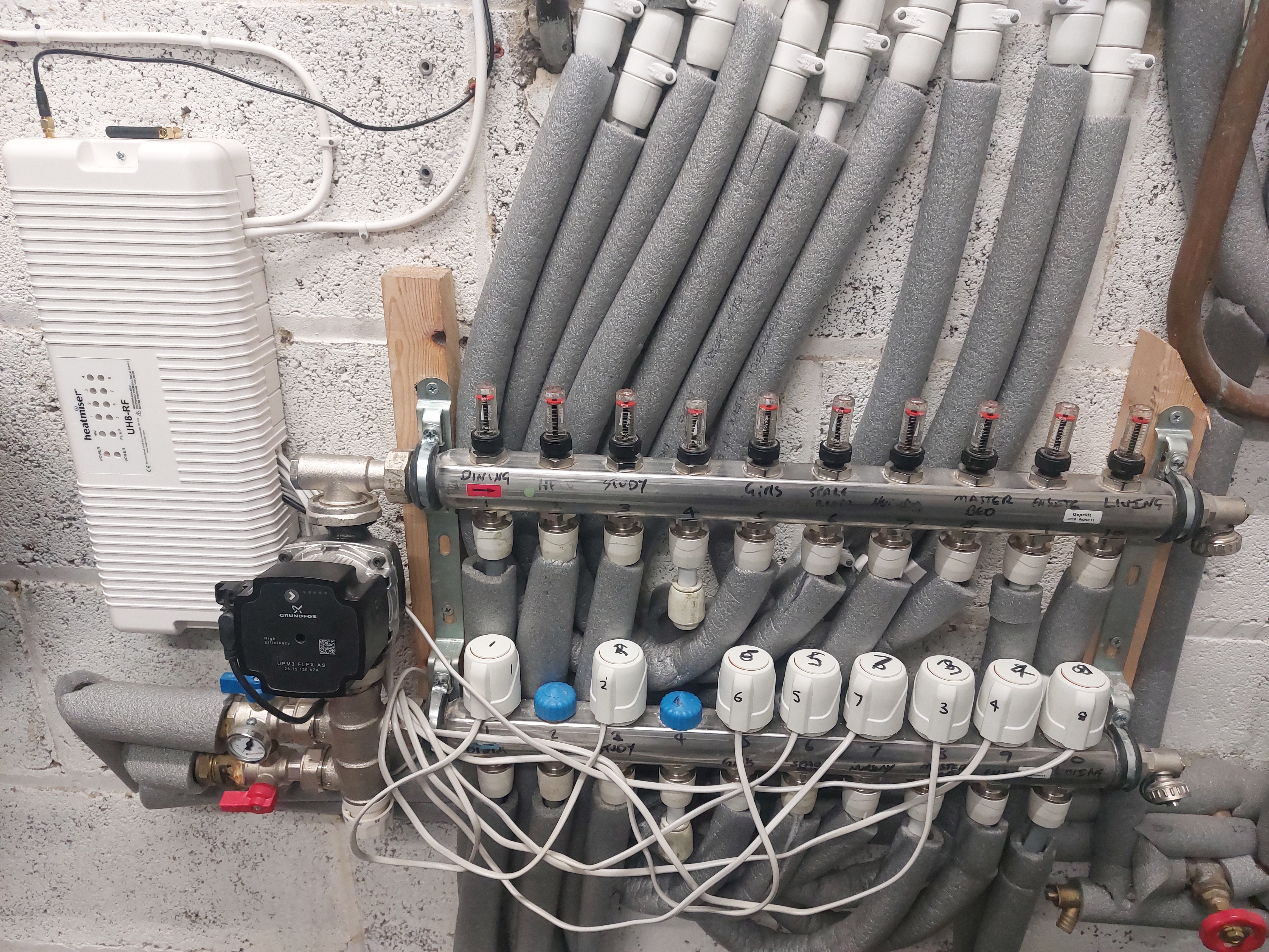

ProDave Posted December 16, 2022 Posted December 16, 2022 8 hours ago, Mark p said: Can you explain the context of this picture? Is it the right way up? If so most of your pipe loops go UP from the manifold. That is not normal. Usually the manifold is on the wall and the pipes come out of the bottom and into the floor. Pipes going up will need provision for bleeding air out of them at the highest point, otherwise air will collect and you might get air locks which could explain some parts of the floor remaining cold. 1
Mark p Posted December 16, 2022 Author Posted December 16, 2022 36 minutes ago, ProDave said: Can you explain the context of this picture? Is it the right way up? If so most of your pipe loops go UP from the manifold. That is not normal. Usually the manifold is on the wall and the pipes come out of the bottom and into the floor. Pipes going up will need provision for bleeding air out of them at the highest point, otherwise air will collect and you might get air locks which could explain some parts of the floor remaining cold. This is a picture of the manifold now. The right way up! Previously the whole thing was the other way up with the flow release valves pointing down. Ports 1, 2, 3 and 10 feed downstairs, whilst upstairs are port is 5 to 9, with 4 not being used. The upstairs ports go up the wall to room above and feed the rest of the house from there. I don't believe that there is anywhere to bleed the air out upstairs. To be honest I don't know where or how we would put some in as i have oak floor everywhere. Part of the problem upstairs is there aren't enough loops. I have though had heat in these rooms so I am guessing there is some heat in the system. Downstairs seems to be better. I think my thermostats may need calibrating as two next each other say a different temperature if I take them off the wall and put them next to each other. I think I need him to flush the system and get the air out. I don't know if it is relevant but when all rooms are on my radiator is only lukewarm but when only one system is nice and hot. It doesn't have its own actuator and will heat up when any system is on.

Mark p Posted December 16, 2022 Author Posted December 16, 2022 1 hour ago, JohnMo said: Just looking at the dotted line on your graphs, which looks to be the thermostat set points. And the red part where it states heating is on. A couple of observations based on experience with my house. You have the heating on at various times and various temperature throughout the day. Looking at the red parts of the graphic your room temp is just about getting to temp and you switch it to a lower temp, then a few hours later a higher temp. So with floor inertia you boiler is playing catch up all the time. The other thing that may be happening you have multiple zone all programmed at differing times of the day. This is great, but in practice, you can have periods where you only have the lounge switched on, so the boiler is only being asked to do a couple couple of kWs of work, but the boiler may have a min output of 10kW. In practice this leads to the boiler short cycling. So boiler starts, a few minutes later trips on high return temps or minimum flow. Boiler is locked out for 10 mins, and this repeats until more zones are opened up. So why does this lead to poor heating performance and high consumption of gas. Short cycling, every time your boiler starts, the efficiency is low, it's heating a slug of cold water and lots of metal, once the boiler has been running for a 5 mins the efficiency climbs quickly. Continuous on off cycle means the boiler is in a low efficiency mode, the 10 min lock means no hot water is being pumped around. Timing efficiency, your floor is heating, you can see in the lounge at about 10am a big jump in temperature. So big it look like the flow temp is way too high. My recommendation as a trial, set all your thermostats to manual at say 19 degrees, and the boiler will have the whole UFH system to heat, see what happens. I suspect it will be fine and heat up quite quickly. If the temperature overshoots 19 then your flow temp is too high. Thank you for you comments. I have now changed to put on at around 19 degrees and 18.5 degrees all day and down to 16 over night to all downstairs and slightly lower upstairs see if this makes a different. Like you say it I may have been asking the boiler to heat to few zones and also on and off too much. When it is short cycling does the boiler have an hour glass sign? I have a Valliant Ecofit pure The jump in temperature is misleading on this graph. I put the fire on in the room to get it up to a reasonable temperature as on previous days it was staying at 16 ish degrees. The room then kept up to temperature

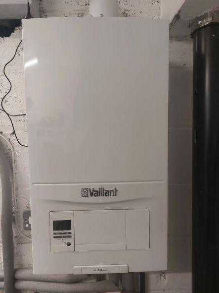

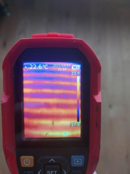

Mark p Posted December 16, 2022 Author Posted December 16, 2022 Pictures of my system now, the boiler and showing the lounge through a thermal imaging camera The flow meter on port 1 appears to be stuck and I have asked the plumber to replace

ProDave Posted December 16, 2022 Posted December 16, 2022 10 minutes ago, Mark p said: Pictures of my system now, the boiler and showing the lounge through a thermal imaging camera The flow meter on port 1 appears to be stuck and I have asked the plumber to replace The immediate thing on that photo of the manifold is the numbers on the actuators are not matching the writing on the manifold You need someone to check that the actuators are really all in the correct place, otherwise you may have the actuator for one room controlled by a different thermostat.

Mark p Posted December 16, 2022 Author Posted December 16, 2022 2 minutes ago, ProDave said: The immediate thing on that photo of the manifold is the numbers on the actuators are not matching the writing on the manifold You need someone to check that the actuators are really all in the correct place, otherwise you may have the actuator for one room controlled by a different thermostat. We realized that they weren't heating the right rooms and cooled the whole system and pumped heat into each zone and sorted the actuators for the relevant room. The plumber used the previous markings and didnt check last year. They were wrong. That is why the current photo labels dont match. I need to relabel. 1
JohnMo Posted December 16, 2022 Posted December 16, 2022 Also from the photo the flow rates look quite low. You may be better with a higher flow rate and slightly small DP across the loops, this would give more energy to the floor, you then reduce flow rate. Option to look at later. On the night set back, only drop it 2 degrees, then the boiler isn't having to work so hard to recover floor temp. But just alter one thing at a time, understand the outputs before changing something else. 1
