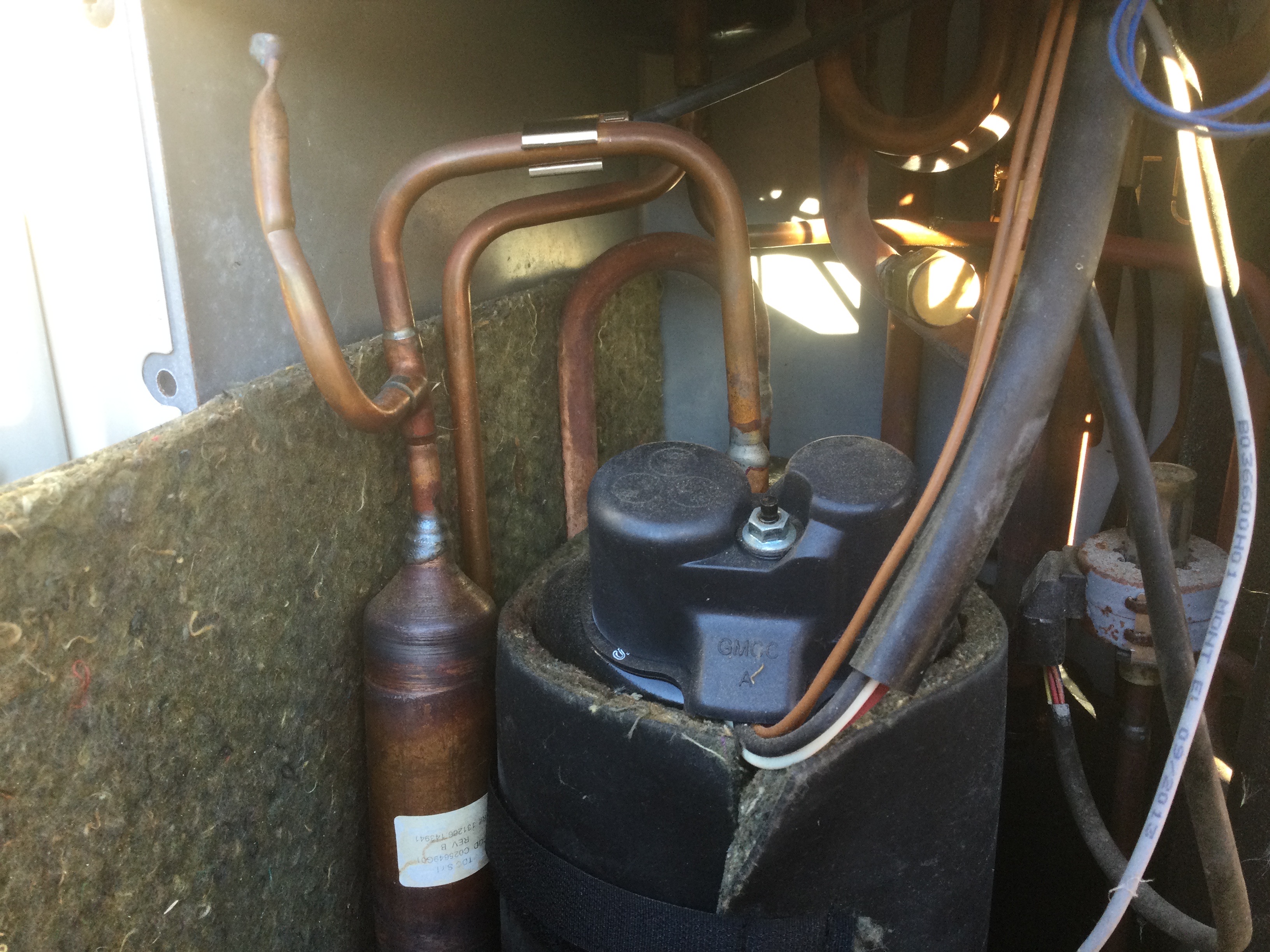

ProDave Posted December 15, 2022 Posted December 15, 2022 Can you post a picture? Do you have an IR thermometer so you can do a non contact temperature reading of a hard to reach part?
joe90 Posted December 15, 2022 Author Posted December 15, 2022 Ooh that’s interesting, turned off DHW (turned down stat and switched on immersion) and running the UFH it appears to run, will give it more time ………
joe90 Posted December 15, 2022 Author Posted December 15, 2022 (edited) I pulled some insulation off….. but spooky it’s running the UFH with no problem 🤷♂️, makes me think it’s not the ASHP (phew). You can’t see it but there is a smaller “cylinder” behind which has some frost on it. Edited December 15, 2022 by joe90
ProDave Posted December 15, 2022 Posted December 15, 2022 How is yours plumbed to switch between hot water and heating? two 2 port valves ore one 3 port valve? Try turning the hot water back on again and see if the fault comes back? I am not seeing anything in that photo that looks like a heat exchanger to me (does not mean it is not)
joe90 Posted December 15, 2022 Author Posted December 15, 2022 2 minutes ago, ProDave said: two 2 port valves ore one 3 port valve? A change over 3 port (I know you don’t like them,!,!) 2 minutes ago, ProDave said: Try turning the hot water back on again and see if the fault comes back? Yes I will do this after I get some heat into the floor and prove it will run fir a few hours at least 3 minutes ago, ProDave said: I am not seeing anything in that photo that looks like a heat exchanger to me That was my thought, without dismantling loads of stuff I can’t get to where a heat exchanger “might” be. However if the UFH continues to work ok I have proved the fault in the DHW cct (and not the ASHP thankfully) 👍
