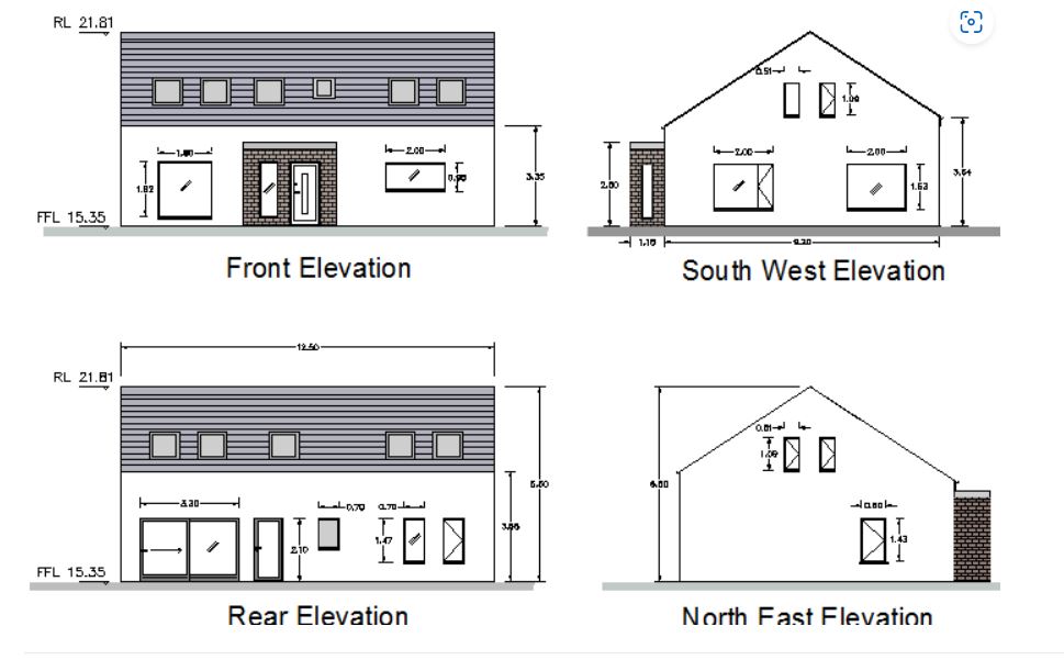

Iceverge Posted December 16, 2022 Share Posted December 16, 2022 21 hours ago, Moggaman said: surface area is 190m2 Sorry, I was wondering what the total outside area of the building was. The total of the ground floor slab, walls and roof and ceiling. This can make a big difference as a bungalow will have more walls and floor and ceiling exposed to the cold than a two or three story of the same floor area. Link to comment Share on other sites More sharing options...

Moggaman Posted December 17, 2022 Author Share Posted December 17, 2022 On 16/12/2022 at 09:18, Iceverge said: Sorry, I was wondering what the total outside area of the building was. The total of the ground floor slab, walls and roof and ceiling. This can make a big difference as a bungalow will have more walls and floor and ceiling exposed to the cold than a two or three story of the same floor area. House is 1.5 storey .. 9 roof lights upstairs…rooms in roof… Total outside area …. That’s ground floor slab …95m2… back wall - approx 12 x 4.5 - 54m2 … front wall— 12x 3.7 — 45m2.. gables — 30m2…ceiling —- 50m2… so approx 285m2… I think that’s what you asked?.. Link to comment Share on other sites More sharing options...

Iceverge Posted December 18, 2022 Share Posted December 18, 2022 Looked back through your posts and found this. Drawing it out I reckon the total outside surface is 429m2. A nice compact shape. Assuming an average envelope U value of 0.25w/m2k and an average night-time outside temperature of -5 deg your steady heat loss should be 429m2*0.25w/m2K *Delta T of 25deg = 2681w. Plus MVHR @ 75% efficiency ventilation losses will be about 200w. Assuming your airtightness is as good as you say 3kw isn't far off the mark. From your first post here you used 20kWh in 9hrs so 2.2kw of power drawn by the heat pump. 3/2.2 = a COP of about 1/4 or 140% efficiency in heat pump salesman language. Link to comment Share on other sites More sharing options...
Iceverge Posted December 18, 2022 Share Posted December 18, 2022 Looked back through your posts and found this. Drawing it out I reckon the total outside surface is 429m2. A nice compact shape. Assuming an average envelope U value of 0.25w/m2k and an average nighttime outside temperature of -5 deg your steady heat loss should be 429m2*0.25w/m2K *Delta T of 25deg = 2681w. Plus MVHR @ 75% efficiency ventilation losses will be about 200w. Add some ventilation losses and 3kw isn't far off the mark. From your first post here you used 20kWh in 9hrs so 2.2kw of power drawn by the heat pump. 3/2.2 = a COP of about 1/4 or 140% efficiency in heat pump salesman language. Link to comment Share on other sites More sharing options...
SteamyTea Posted December 18, 2022 Share Posted December 18, 2022 Just now, Iceverge said: 3/2.2 = a COP of about 1/4 1.4 to save any confusion Link to comment Share on other sites More sharing options...
