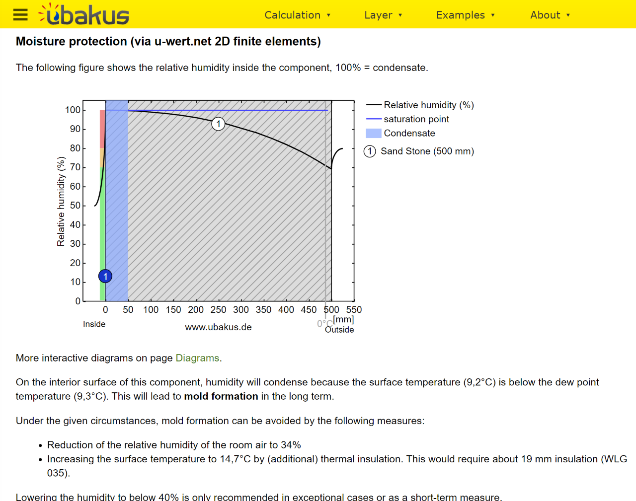

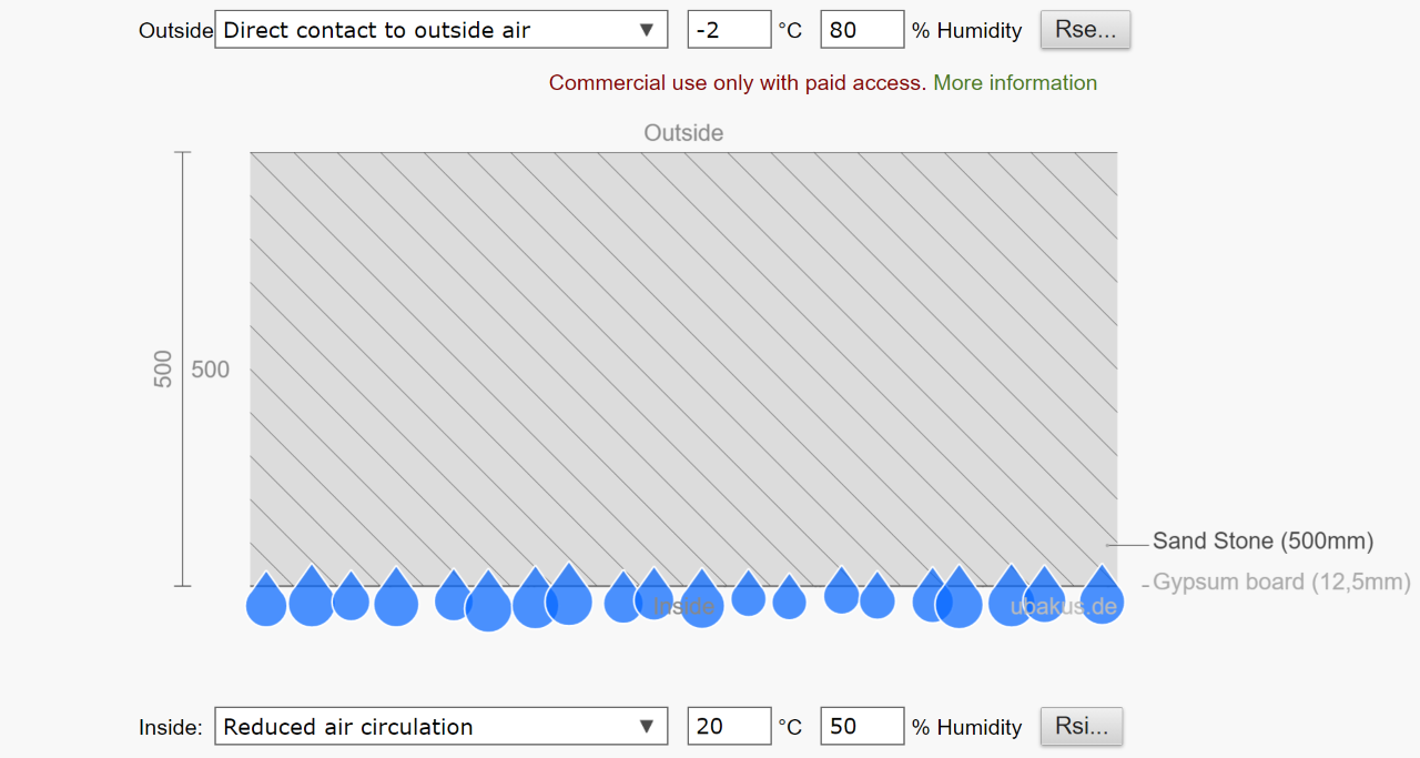

Garald Posted December 12, 2022 Author Posted December 12, 2022 On 12/12/2022 at 17:36, DamonHD said: I have used aerogel to good effect in my own home, in several varieties: https://www.earth.org.uk/note-on-Spacetherm-aerogel-thermal-insulation.html Expand Thanks! It looks like even 2cm total of this (probably all we have to play with, given that there's also 1cm of plasterboard; see the picture) would help, even though they would not bring the wall up to standards. I'll talk to my architect. On 12/12/2022 at 18:32, Radian said: You need to perform a condensation risk on that wall. As a poorly insulated surface amongst better insulated surfaces and other warmed spaces, it will be a surface that acts like an unintentional dehumidifier in you home. Expand Will insulating with space-gel solve that issue as well, or will it create new issues in that direction? On 12/12/2022 at 17:36, DamonHD said: Blinds are unlikely enough IMHO to be air-tight enough to be much good to retain heat. To keep sun/heat it out: https://www.earth.org.uk/towards-a-LZC-home.html#reflblinds Expand Thanks, this is interesting. But surely I want a minimum of light to be reflected back out during the winter? (If only curtains were easily convertible from winter to summer, like duvets...)
Garald Posted December 12, 2022 Author Posted December 12, 2022 On 12/12/2022 at 18:32, Radian said: You need to perform a condensation risk on that wall. Expand How would I do that?

Radian Posted December 13, 2022 Posted December 13, 2022 On 12/12/2022 at 19:51, Garald said: How would I do that? Expand I didn't read anywhere what your wall makeup was. It looks like around 0.5m solid masonry, but what's on the other side? Fresh air or another building? If you can identify these parameters then you can use a simple online calculator like this one to get an idea of condensation risk e.g.

Garald Posted December 13, 2022 Author Posted December 13, 2022 On 13/12/2022 at 10:54, Radian said: I didn't read anywhere what your wall makeup was. It looks like around 0.5m solid masonry, but what's on the other side? Fresh air or another building? Expand There's another window up to a certain height, and then it stops: (Mine is the red-brick building.) At any rate, the architect says (I translate, summarise and paraphrase): *The fact that we have positive-input ventilation (PIV) and [thus] have hot fresh air means that the aerogel proposition is not really suitable for our case; [NB - I didn't quite understand why this is a reason] * Aerogel plaster does not have a good enough R; * Aerogel plaque is too risky for the workers (the resulting dust is very much an irritant and we don't know its toxicity). Its an option only if it comes precut to the exact dimensions. She says she's already thought of all options (displacing the staircase, insulating from outside, from the inside, with different materials...). In the end, she proposes two options: - "feutre de laine tendu" [NB: this is literally "stretched wool felt" - what would the technical term be?], which insulates and perspires, but is also expensive; - simply installing a small portable electric heater in that space in case of great cold.

Radian Posted December 13, 2022 Posted December 13, 2022 On 13/12/2022 at 15:17, Garald said: Is this the sort of thing I should be looking into? It seems meant for industrial use. https://local.armacell.com/fileadmin/cms/corporate/en/onepager_armagel/Downloads/technical-datasheet/ArmaGelHT_Technical_Datasheet_French.pdf Expand Industrial use refers to the very high temperatures it will withstand. You might be paying a premium for something unnecessary I imagine. Have you looked at aerogel insulating plaster This would appear to have a thermal conductivity of 0.03W/(mK) so a 20mm thickness would have a U-value of around 1.5 W/(m²K) I still don't understand your wall makeup. The aerial photo looks like bricks but the plan makes it seem about 500mm deep. Is it two full bricks deep?
Garald Posted December 13, 2022 Author Posted December 13, 2022 On 13/12/2022 at 16:05, Radian said: Have you looked at aerogel insulating plaster This would appear to have a thermal conductivity of 0.03W/(mK) so a 20mm thickness would have a U-value of around 1.5 W/(m²K) Expand Yes, we did (Fixit, in fact). The architect said it does not have a good performance for the tiny space we have to work with, but that may just mean it's not up to norms. We are not going to be up to norms on that wall anyhow - we are just trying to get by. On 13/12/2022 at 16:05, Radian said: The aerial photo looks like bricks but the plan makes it seem about 500mm deep. Is it two full bricks deep? Expand Good question. Let me ask.
