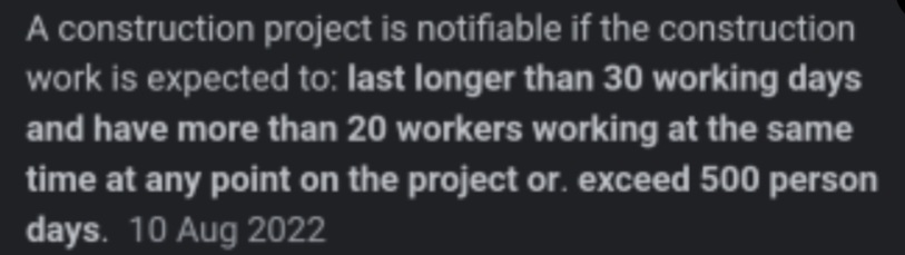

CalvinHobbes Posted December 8, 2022 Posted December 8, 2022 (edited) I have adhd so sometimes things can read a bit strangely to me. So we haven't done any contract for the actual build yet. Meeting qs and architect to get it and other paperwork done including notification for it to properly start in Jan. Asked the builder we think we will use to come in, secure site (a few windows have had stones thrown at them) help me get a security camera up and dig a trench so we can get temporary consumer unit in and also plan for welfare unit etc. I had already myself removed fruit trees,sheds, brambles, hedges, doors, kitchen, skirting etc in frustration at the delays. So asked him to tidy some left over debris from that too. He suggested he could get the roof tiles down. I know the big digger will tumble cottage in Jan and do foundations etc but would taking the tiles now off be counted as demo? Quite a few are loose or fallen already. Thinking if there was a high wind it might be safer to have had them off. (He was a roofer for 20+ years). Also if its just him and 2 others for a few days or a week in this standalone basis is it notifiable now? I want to keep things right. Tbh my main worry was I don't want children in when no one is around over Christmas holidays. I needed it secure. I just don't know if the wording refers to a stage or the whole thing. Edited December 8, 2022 by CalvinHobbes

Conor Posted December 8, 2022 Posted December 8, 2022 You're not a notifiable project. Re demolition, ensure the contractor has demolition cover as I can guarantee you your own self build won't. 1
nod Posted December 8, 2022 Posted December 8, 2022 2 hours ago, Conor said: You're not a notifiable project. Re demolition, ensure the contractor has demolition cover as I can guarantee you your own self build won't. Plus 1 Lots of the bumf out there doesn’t apply to single private builds Securing the site is a must 1
ToughButterCup Posted December 8, 2022 Posted December 8, 2022 Provided you are a Domestic Client (thats really important) your project is NOT notifiable. Here's the definitive guidance. (HSE). For further reassurance you can also read this thread on this board (about CDM 2015) @nod's point about keeping the site secure is the key issue for you, I would think. 2
