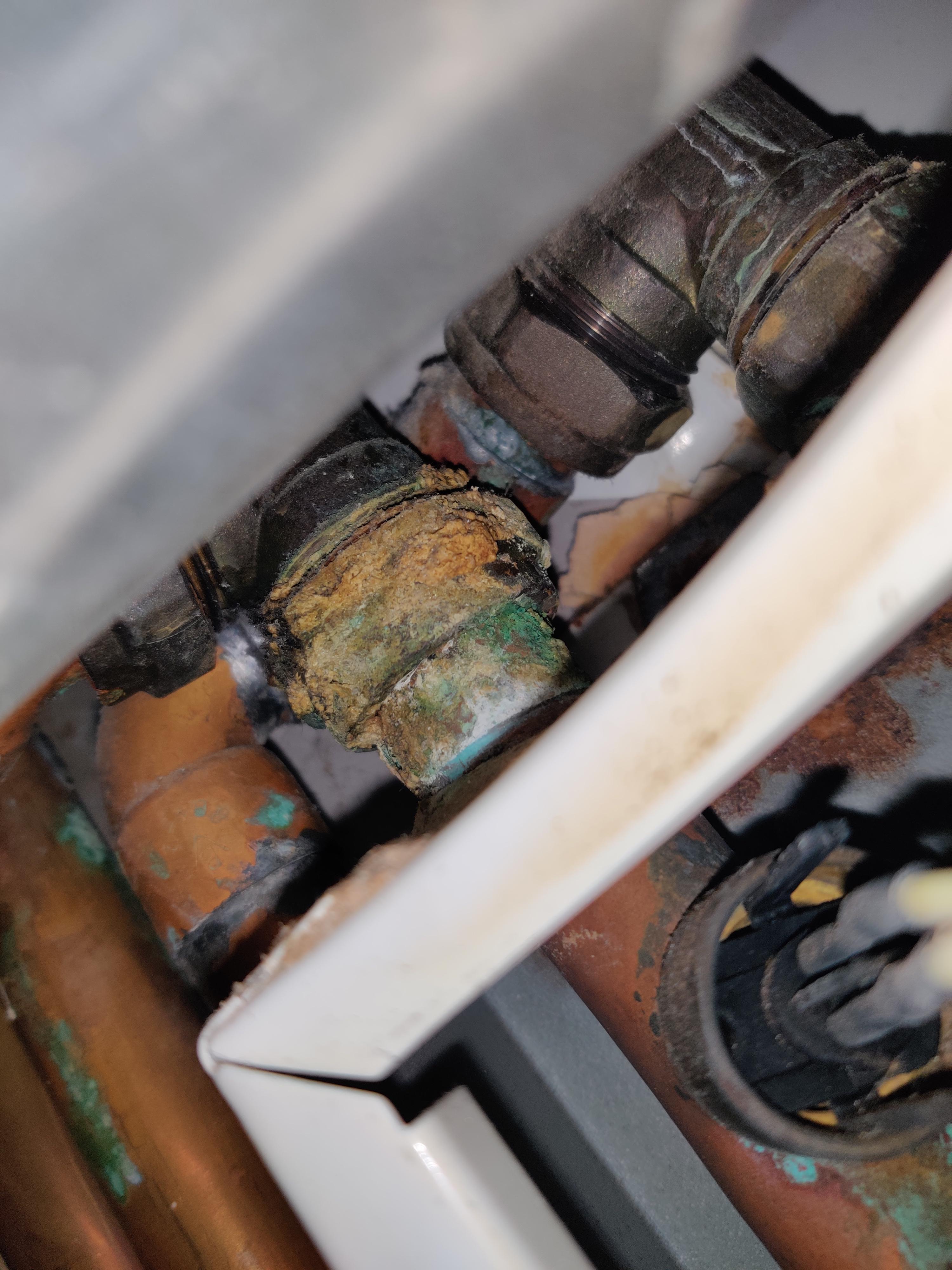

Goodremy Posted December 6, 2022 Author Share Posted December 6, 2022 On 05/12/2022 at 14:57, ProDave said: This sounds like a case of "it wasn't broke why did you mess with it" What part of the casing? Is it really a serious fault (gas or combustion products leaking) or just an outer case? I would seriously look at getting it welded to patch it up if it does not have to last long. Thanks everyone for replying to the post. I have been busy chasing quotes the whole day. This condemned boiler, here's the story: so, we have had British gas (BG)Homecare contract for over 4 years which includes among other things, central heating and boiler service. On 2/11/22, the BG engineer came to service the boiler which was working perfectly ( 22 rads, loads of hot water). About 3 mins into the service, he called out alarmed, asking if the boiler had ever been serviced. I was confused. I told him it's been serviced annually by BG! He showed me a hole in the casing and pointed to a horrible looking yellowish crusty weepy joint on top of the boiler; apparently it had been leaking over a long time and it had caused corrosion on the case. On close examination, the whole area behind the flue is rusted. This is a room sealed boiler and so it's an integral part of the boiler. The leaky joint is clearly visible when the front cover is off - it appears prior BG engineers couldn't be bothered to fix it while certifying the boiler as safe. Might I add that the carbon monoxide alarm present has never detected any gases. British gas denied responsibility for negligence and say that the boiler was old anyway but as a Matter of "goodwill" they've offered to refund 2 years worth of boiler service fees we paid and also one central heating cover totalling - which is still somewhere in the post. Now we've got about 5 local plumbers in but all of them say it's unsafe and only quote for a new boiler. I think we are now tending towards a system boiler as the hot water was so slow to get to the tap and we have two showers with 2 pumps - like I said we have 2 separate plumbing systems (original house and extension. Well get it combined. We'll be renovating but with high prices we'll wait So perhaps in 2 years time. For now we'll upgrade the mains - we'd thought we'd do it with the renovation but it is what it is. Link to comment Share on other sites More sharing options...

SimonD Posted December 6, 2022 Share Posted December 6, 2022 1 hour ago, Goodremy said: He showed me a hole in the casing and pointed to a horrible looking yellowish crusty weepy joint on top of the boiler; apparently it had been leaking over a long time and it had caused corrosion on the case. On close examination, the whole area behind the flue is rusted. 1 hour ago, Goodremy said: British gas denied responsibility for negligence I would tell them that you're going to put in a call to Gas Safe and ask an inspector to come out and have a look. Link to comment Share on other sites More sharing options...
Goodremy Posted December 6, 2022 Author Share Posted December 6, 2022 Yeah, I'll try to that; the problem is they all say BG knows what it's doing. Here's a pic. Again it wasn't the gas pipe leaking; I think it's probably central heating water. Link to comment Share on other sites More sharing options...

PeterW Posted December 6, 2022 Share Posted December 6, 2022 2 hours ago, Goodremy said: This condemned boiler, here's the story: so, we have had British gas (BG)Homecare contract for over 4 years which includes among other things, central heating and boiler service. On 2/11/22, the BG engineer came to service the boiler which was working perfectly ( 22 rads, loads of hot water). About 3 mins into the service, he called out alarmed, asking if the boiler had ever been serviced. I was confused. I told him it's been serviced annually by BG! Standard BG sales ploy - sorry but save your money in future and get an independent to service it 2 hours ago, Goodremy said: On close examination, the whole area behind the flue is rusted. This is a room sealed boiler and so it's an integral part of the boiler. Thats bollocks - room sealed means the intake and exhaust are both from the outside air. Does it have a concentric flue or an old cage flue..? Most will happily run with no external casing so that needs properly checking. Are the indies also saying it’s not ok ..? Or are they just reading the BG condemned notice ..? 2 hours ago, Goodremy said: think we are now tending towards a system boiler as the hot water was so slow to get to the tap and we have two showers with 2 pumps - like I said we have 2 separate plumbing systems (original house and extension. This makes no sense - if you have to go system then you need an unvented or mains pressure tank to get better pressure. This isn’t that difficult .! You can put a system boiler on a standard tank but the pressure and flow will be lower. Link to comment Share on other sites More sharing options...
ProDave Posted December 7, 2022 Share Posted December 7, 2022 10 hours ago, Goodremy said: Yeah, I'll try to that; the problem is they all say BG knows what it's doing. Here's a pic. Again it wasn't the gas pipe leaking; I think it's probably central heating water. So that is the outer layer of the flue rusted. Post a picture of the flue from the outside. But usually the outside bit the air intake and the flue gasses are a separate pipe inside that. If that is the case, that will also be running cold at the point it has rusted (run the boiler for half an hour, then get up there and see.) Again not advice, but if it were me and I knew this was only short term, having confirmed it is the intake part of the flue that has corroded and confirmed it runs cold at that point, I would patch it up with car body filler for now. Link to comment Share on other sites More sharing options...
