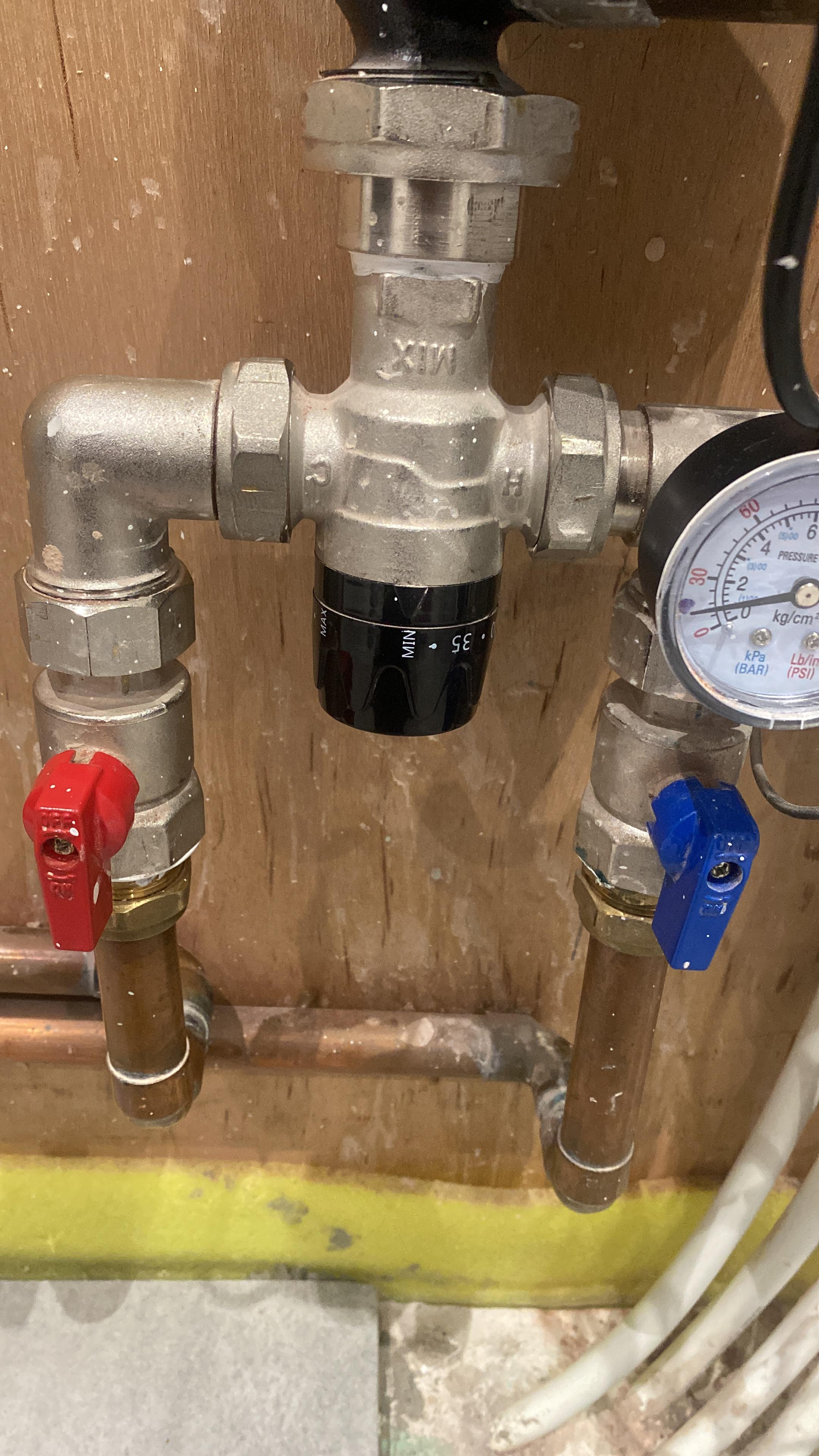

Jamieh1987 Posted December 14, 2022 Share Posted December 14, 2022 Very similar symptoms to my system before I realised the blending valve was the wrong way around (note the H and C on the pic). Worked fine for months surprisingly and then suddenly started locking the boiler out and just circulating water already in the system until I opened the valve fully. Probably isn’t your cause if you’re sure it’s been installed correctly but worth double checking. I swapped the valve around and it’s been fine since, although it’s annoying the temperature marking on the valve now faces the wall 😄. Link to comment Share on other sites More sharing options...
dpmiller Posted December 15, 2022 Share Posted December 15, 2022 you can turn the knob and index round- note the setting, then remove the screw from the centre of the knob. It and the index ring should then pull off, so you can then reposition and re-assemble to suit. 1 Link to comment Share on other sites More sharing options...
