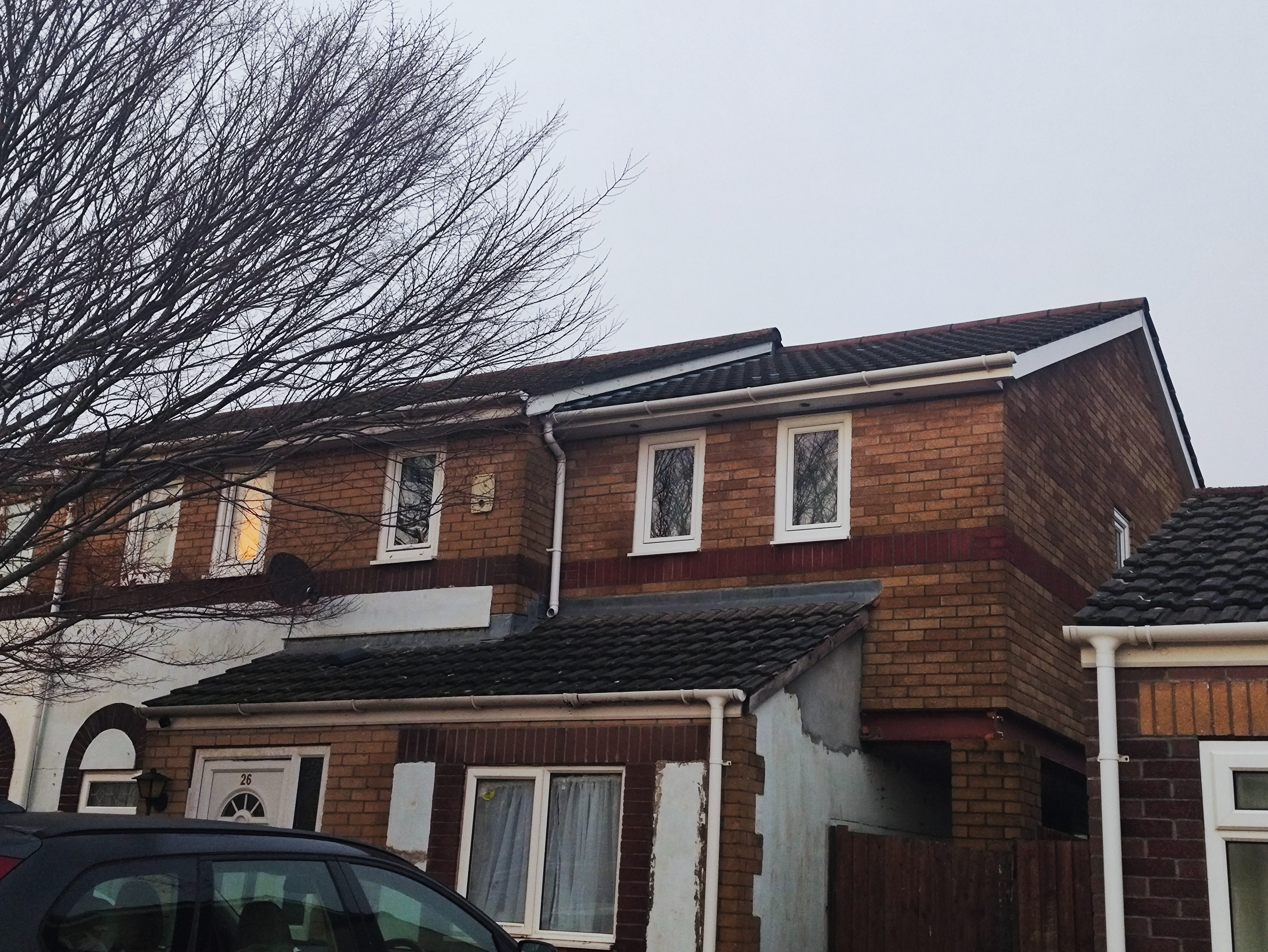

umer Posted November 27, 2022 Posted November 27, 2022 hi everyone, i am new on this forum and still looking for information on diy solar install i have a survey done of my house by a solar installer and they said that i can have 14 panels installed in two rows max. but the estimate they gave me is almost 100 percent more than what i can buy myself even after paying vat from online stores like ITS. So naturally i got confused because even after getting hardware without vat these companies are quoting prices like that. i am off work now and have lot of free time and diy experience . if i can get some help from experienced folks here than i can take it on with the help of a local electrician. My yearly electric usage is 5000 kwh aprox and i plan to remove gas totally and have air to air heat pump /air conditioner for heating and immersion heating for hot water. also, we are planning to get an ev later. So i wanted the maximum energy generation from the solar. i am looking at ja solar 545 half cell panels with a gsl battery all in one system or any other setup you can advise. please advise me for a setup including all the mounting, cables, isolators etc and the costs involved please. the quote i got from the solar company is 10,300 for 14 ja solar 545 half cell perc panels and 6 kw solis hybrid inverter. 3400 extra for an ac battery. please advise me kind regards umer

Dillsue Posted November 28, 2022 Posted November 28, 2022 14 hours ago, umer said: Let's try want to justify the 10000 plus quote .I can buy the panels and inverter from ITS FOR 5000. What else I need. How much scafolding will cost for this house. It's a semi detached with extension on side. And how much should I add for cabling,isolaters, mounts etc. If your panels are going on the front of the house, how much shading is that tree casting over your roof?

umer Posted November 28, 2022 Author Posted November 28, 2022 2 hours ago, Dillsue said: If your panels are going on the front of the house, how much shading is that tree casting over your roof? None at all. But I will trim it from top if it did.

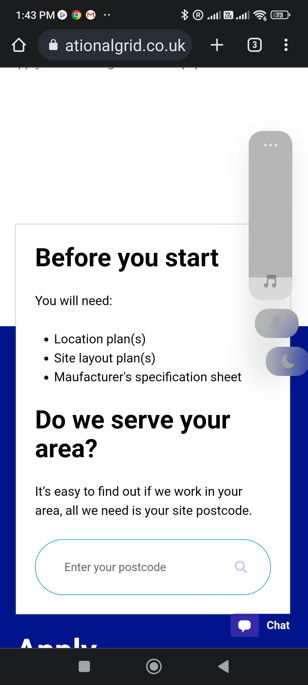

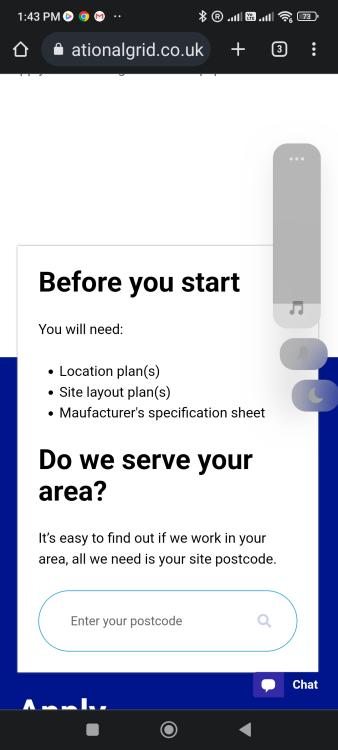

umer Posted November 28, 2022 Author Posted November 28, 2022 I spoke to my dno and they asked me to fill online form .also it says online that Upto 5 kw approvals will be given with out visit. Also they are asking for following docs for application. see the screen capture please. What's are these documents. does location plan means the house plans?
Marvin Posted November 28, 2022 Posted November 28, 2022 1 Street plan showing location of property and full postal address. 2 plan of your property. 3 technical specification of the inverter you are proposing to install.
Marvin Posted November 28, 2022 Posted November 28, 2022 (edited) Hi @umer They want to know where you are and what your connecting is limited to what your asking for. My rough plan showed the outside of the house and boundaries, where the panels were to be on the roof, where my consumer unit was and where the inverter was going to be. With brief description eg: panels here on front roof. Mains supply to here in the garage Inverter here in loft. With arrows. Edited November 28, 2022 by Marvin Add info
Dillsue Posted November 28, 2022 Posted November 28, 2022 I think you maybe looking at the wrong form! It's G99 A1-1 that you want. Certainly for my application there was no site or location plan needed. To go with the form youll need a single line drawing of the house electrics and a type test certificate for the inverter which youll get from the ENA inverter database 2
Marvin Posted November 28, 2022 Posted November 28, 2022 Just now, Dillsue said: I think you maybe looking at the wrong form! It's G99 A1-1 that you want. Certainly for my application there was no site or location plan needed. To go with the form youll need a single line drawing of the house electrics and a type test certificate for the inverter which youll get from the ENA inverter database From discussions here, I think different DNO's want different things so I would double check.
Marvin Posted November 28, 2022 Posted November 28, 2022 (edited) Hi @umer My DNO's response June 2021: Good Afternoon Thank you for getting in touch. The below is the criteria required to apply. If you would like a formal connection offer and are applying for a generation connection of 50kW or less then this will be dealt with through our Microgeneration Team. You would be required to submit a Completed G99 A1-1 form, which I have attached for you. You will also need to provide the following supporting documents; Site Plan – Please show the site boundary and proposed new supply location. Schematic – Please show the name & size of inverters being used, a clear demarcation between the DNO and customer equipment and the generation itself. G99 Type Test Certificate LOA – Please provide a signed letter of authority dated within the last 12 months (if the landowner is applying please state this in the application/email). Some of this information you will be best to get from your appointed installer. Once you have everything you need, you can email north.Microgen@sse.com or south.microgen@sse.com where your application will be reviewed and registered. If you have everything required to make your application competent then it will be passed onto our Network Designer for quotation. You will receive this within 65 working days . Please be aware that Connection Offer Expenses, where applicable, will be due to be paid for the provision of this Connection Offer. Where applicable this will be payable even if you do not wish to accept your Connection Offer. If you cancel your applications within 14 days you will not be liable for any Connection Offer Expenses. However where applicable, if you cancel after this point you will be required to pay the full amount. For further information on Connection Offer Expenses, including where charges are applicable, you can find our Connection Offer Expenses user guide here. (https://www.ssen.co.uk/connections/usefuldocuments/) If you are applying on behalf of an ICP or IDNO please let us know. Please do not hesitate to contact us at mcc@sse.com or on the telephone number below if you have any problems or queries. Many Thanks Edited November 28, 2022 by Marvin Clarification
Dillsue Posted November 28, 2022 Posted November 28, 2022 24 minutes ago, Marvin said: From discussions here, I think different DNO's want different things so I would double check. Id not picked up on people being asked for a site layout so definitely worth checking
