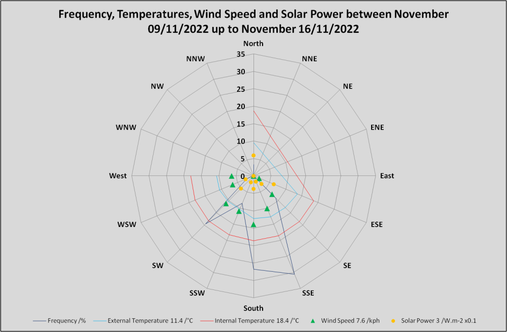

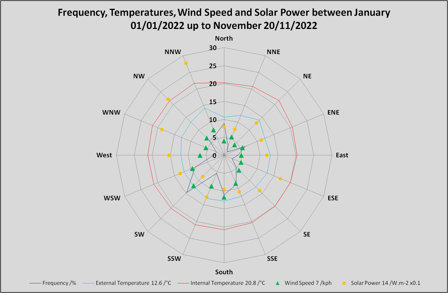

SteamyTea Posted November 23, 2022 Share Posted November 23, 2022 Here is what I measure and chart. Frequency is the wind direction, so when from the North, and the house and outside is coldest, it is about 8% of the time. West wind is when the house is warmest, but that is about 2% of the time. North wind is very slow, SW is very fast, Generally sunniest when the wind comes from between the West and NNW, SW winds are dreadful for sunshine, it is raining then. It rains a lot, except this year. Link to comment Share on other sites More sharing options...

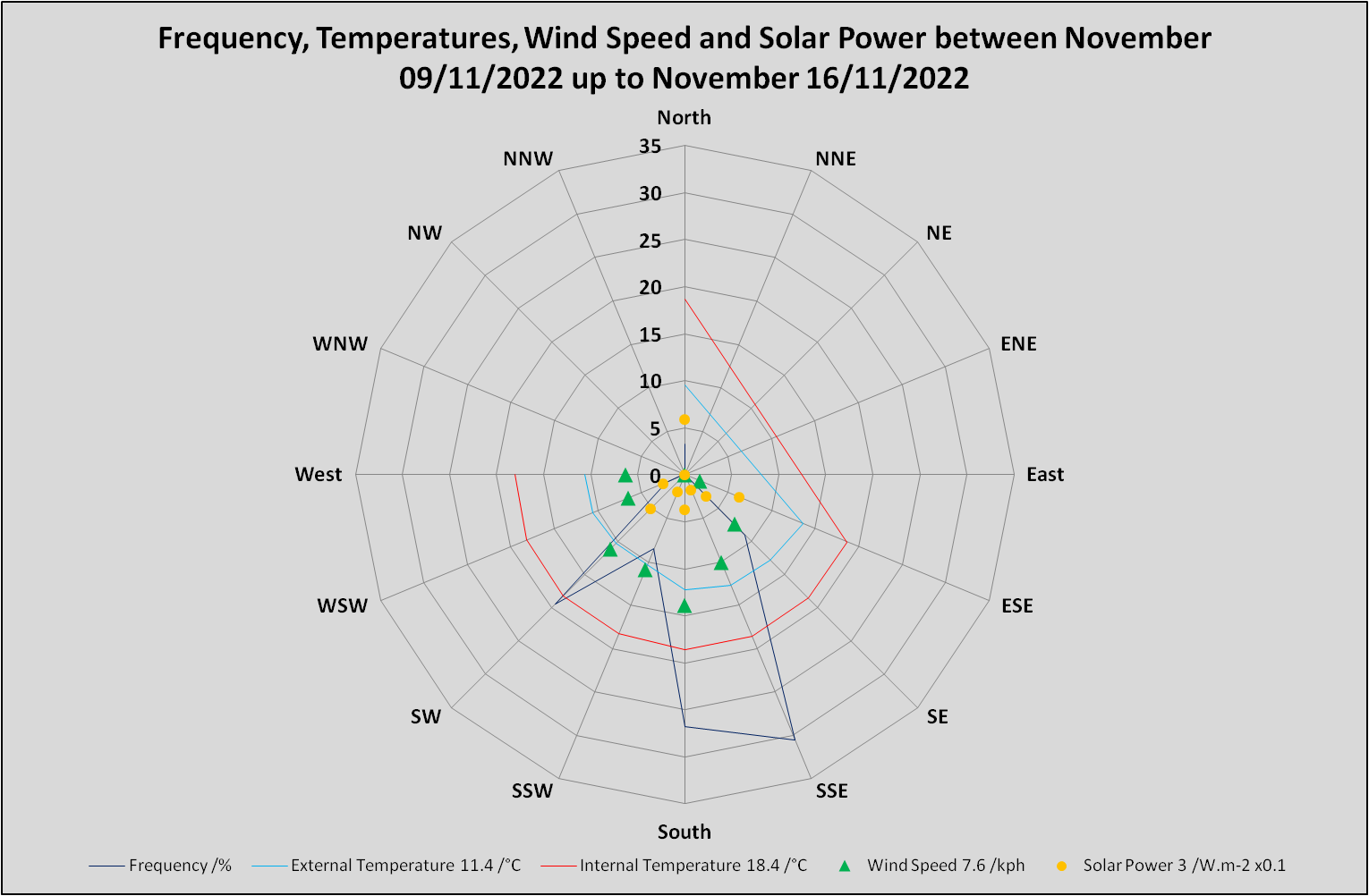

SteamyTea Posted November 23, 2022 Share Posted November 23, 2022 And this is what made me turn my heating on. Link to comment Share on other sites More sharing options...
