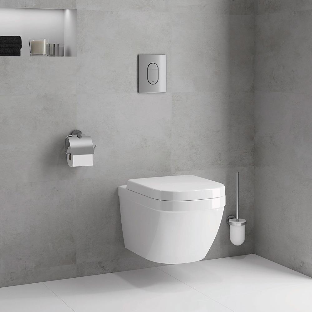

servicing hidden cisterns
looking around at ideas for toilets and something like below may be an option, though how difficult are these to service is something goes wrong in the cistern / pipe connections leak.
If you have tiled over the cistern do tiles have to start coming off?
Access from behind, or if not possible then a boxed out area to mount on with a removable lid.
They are serviced through the button panel
have a look on you tube
We have 4x Geberit concealed cisterns as per the video, and we had one for 10+ years in the last house.  And you can service them through the hole.
My choice was made based on the fact we have the same ones in the office I work in and they lasted around 4 years without showing signs of needing repair, this would equate to about 40 years of domestic use.
Also noted on you photo it shows a full height tiled wall, which whilst looking better, takes away 6" of valuable space, A shelved wall is useful, especially in a small room.

We had them in a previous house. Out of 5 loos 3 failed (same fault) within 5 years.  I had real trouble finding replacement parts and eventually got a box of 5 units from a building company liquidation. Replacing them wasn’t terribly easy either as the space through hole was just big enough for the part and my hand.
who was the manufacturer?
I couldn’t sort mine through the hole and neither could plumber so I ended up pulling the top off
