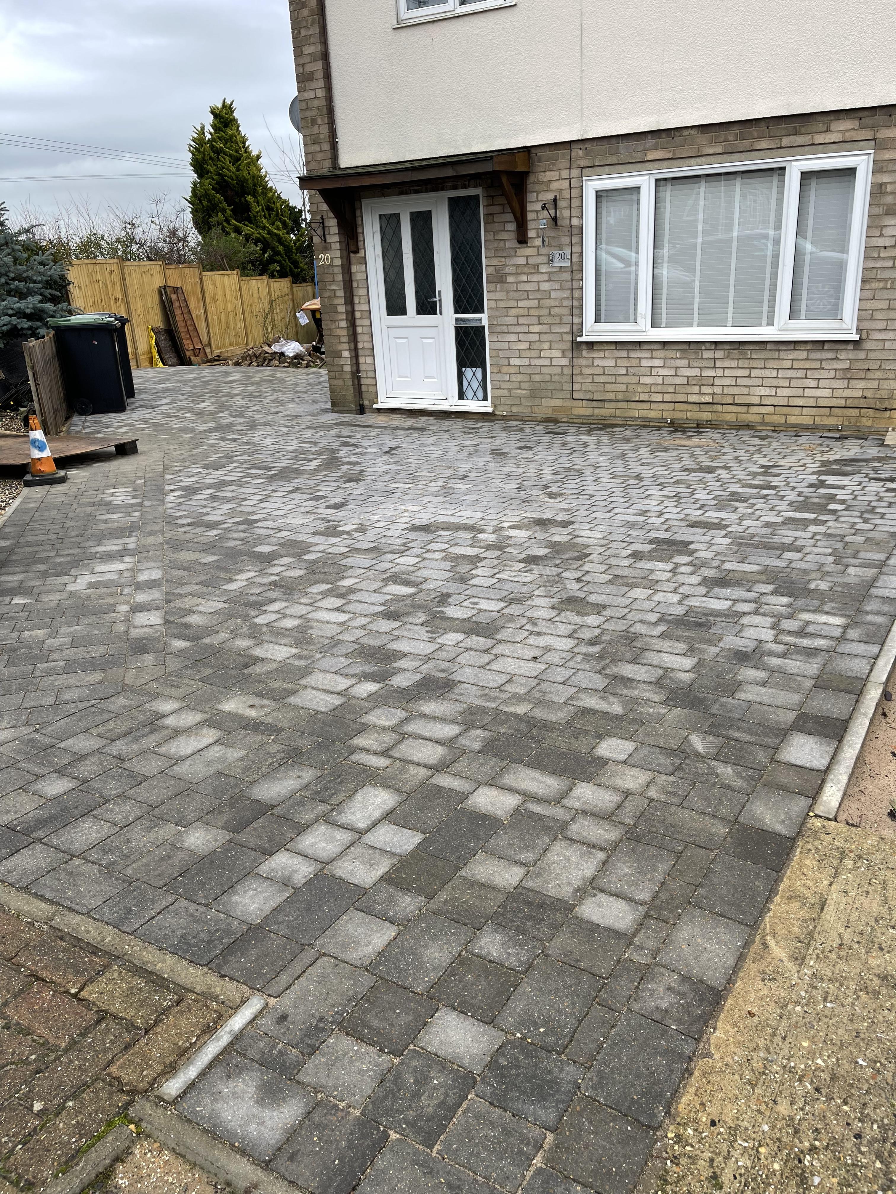

Woody5 Posted November 21, 2022 Share Posted November 21, 2022 Hi, can you please advice on the best placement for drainage on this driveway. It completely floods In heavy rain under the window. We have only had this driveway for roughly 2 months and we are getting bad damp and mould around the skirting boards on the inside. The pavers are already sinking under the window. Is this caused by the pooling of water during heavy rain? original plan was to have drainage under the window but contractor said it wasn’t needed and put it round the side of the house. I’ve also been made aware that it could also be bridging DPC. any help and advice is greatly appreciated. Link to comment Share on other sites More sharing options...

Mr Punter Posted November 21, 2022 Share Posted November 21, 2022 The drive slopes towards the house and there is not the required 150mm between the paving and the DPC. Could you take up the pavers nearest the house, dig down and install a drainage channel along the front wall so it empties into the gulley to the left of the front door? Link to comment Share on other sites More sharing options...
Radian Posted November 21, 2022 Share Posted November 21, 2022 29 minutes ago, twice round the block said: All paving and driveways around a property should have a gap of 6 inches Not if the surface is 150mm or more below DPC. But this isn't. it's 75mm or less which is criminal. In this case the only affordable remedy might be to create a drainage strip along the entire front elevation See this article on pavingexpert.com for details. Link to comment Share on other sites More sharing options...

saveasteading Posted November 21, 2022 Share Posted November 21, 2022 The gravel perimeter is a good detail as standard , and you will need a kerb to retain the blocks, but it won't get rid of the standing water. Does it all drain to there, or is there another low point? You will need a soakaway or drain: what options do you have? (It is not allowed to run onto the road., and legally is not allowed to go into the mains drains) Link to comment Share on other sites More sharing options...
PeterW Posted November 21, 2022 Share Posted November 21, 2022 2 hours ago, Mr Punter said: The drive slopes towards the house and there is not the required 150mm between the paving and the DPC. Could you take up the pavers nearest the house, dig down and install a drainage channel along the front wall so it empties into the gulley to the left of the front door? +1 to this - easy job to remove some of the blocks but would suggest you also haunch the channel and leave a gravel gap too Link to comment Share on other sites More sharing options...
Woody5 Posted November 22, 2022 Author Share Posted November 22, 2022 20 hours ago, ProDave said: What has the contractor said when you told them to come back and rectify the problem? In law you must first give the original contractor chance to rectify the problem. The contractor has acknowledged that he has got it wrong on the the drainage side. They have agreed to put some aco drains along the front window but one course away from the first blocks. Would you say it’s best to put the aco drain flush to the wall or leave the first row of blocks in? Im also concerned about the the dpc being breached. Link to comment Share on other sites More sharing options...
Woody5 Posted November 22, 2022 Author Share Posted November 22, 2022 19 hours ago, saveasteading said: The gravel perimeter is a good detail as standard , and you will need a kerb to retain the blocks, but it won't get rid of the standing water. Does it all drain to there, or is there another low point? You will need a soakaway or drain: what options do you have? (It is not allowed to run onto the road., and legally is not allowed to go into the mains drains) Most of the standing water is under the window and front door. How the contractor didn’t foresee this problem is mind boggling. I even expressed my concerns when they said they didn’t see the need for drains along the front. can standing water cause blocks to sink or should I be concerned that something else was done wrong? Link to comment Share on other sites More sharing options...
PeterW Posted November 22, 2022 Share Posted November 22, 2022 1 hour ago, Woody5 said: They have agreed to put some aco drains along the front window but one course away from the first blocks. Would you say it’s best to put the aco drain flush to the wall or leave the first row of blocks in? Lose the first row, haunch the aco drain with concrete and leave a gap to the wall then fill the lot with 20mm gravel. It will protect the DPC and also provide localised drainage 1 Link to comment Share on other sites More sharing options...
saveasteading Posted November 22, 2022 Share Posted November 22, 2022 The gravel also kills splashing onto the wall, esp if left a little lower. You are right to worry about blocks moving. If there is an area that I'd always wetter, there can be differential movement. Drains are no use without an outlet. You are not permitted to connect to a main drain. Many driveway contractors, no let's say layers, either don't know this or pretend they don't. It is to reduce flooding, and very sensible, and also is policed I have heard. This poss doesn't apply if your drive was already impermeable. Link to comment Share on other sites More sharing options...
