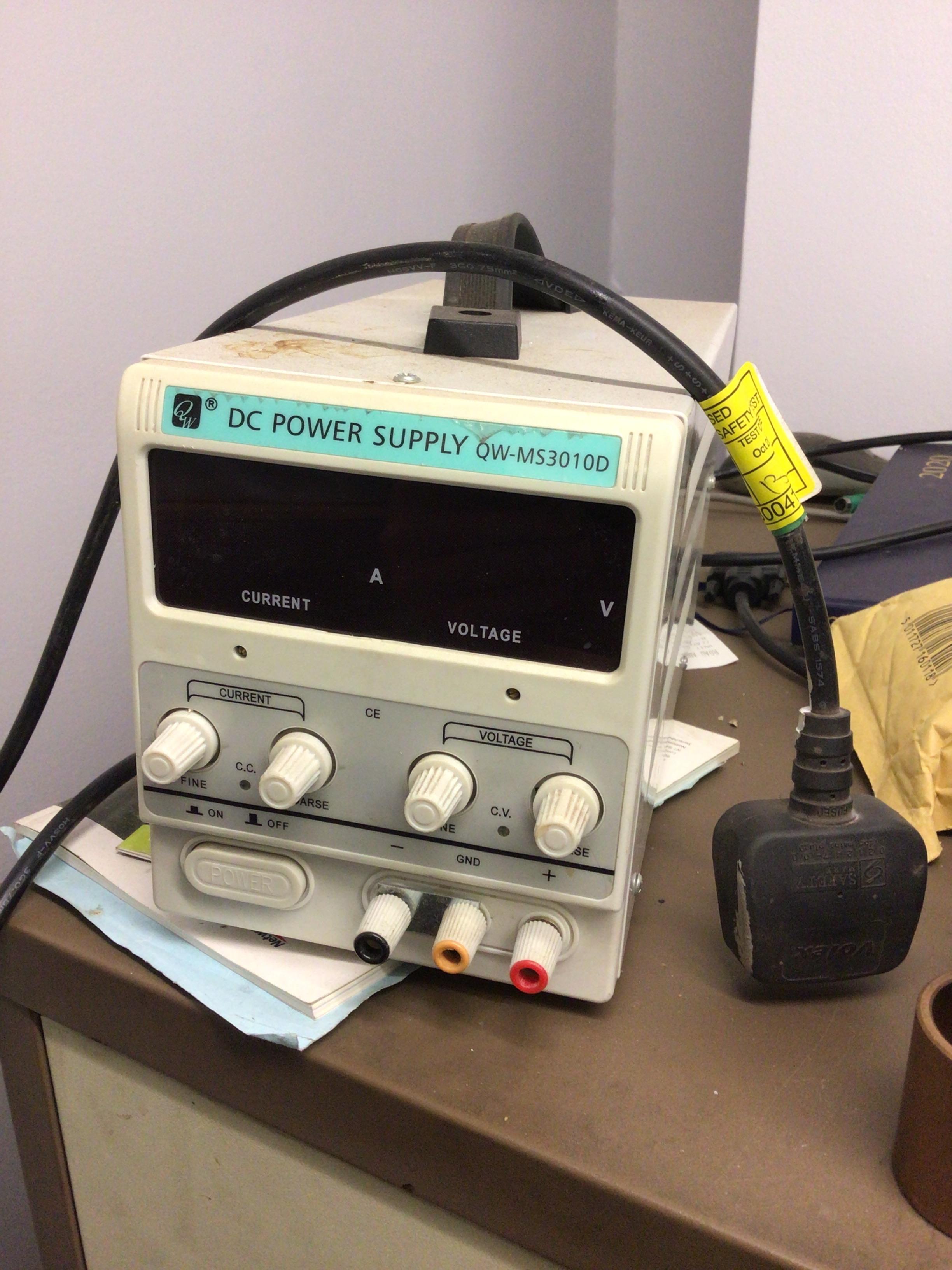

markc Posted November 15, 2022 Posted November 15, 2022 As above, and if not damaged they can be brought back up slowly with a variable power supply. Our customers often ‘forget’ to charge their machines for extended periods and we can usually recover the Cells over a few days getting the voltage up to where the charger will recognise the cell and kick in. 1
lakelandfolk Posted November 15, 2022 Author Posted November 15, 2022 Many thanks Bill & Mark, I believe the voltage of the proposed additional battery needs to be similar to the one it is going to be connected to. What equipment would I need to charge the additional one if it is lower and does not match? Could I just wait for the existing batteries to drop down to a similar voltage?
lakelandfolk Posted November 15, 2022 Author Posted November 15, 2022 Wow, that looks like an expensive bit of kit
SteamyTea Posted November 15, 2022 Posted November 15, 2022 18 minutes ago, lakelandfolk said: Wow, that looks like an expensive bit of kit Not really. One at random. https://www.amazon.co.uk/Adjustable-Switching-Precision-Charging-Interface/dp/B09C8LWV9W/ref=mp_s_a_1_3
lakelandfolk Posted November 15, 2022 Author Posted November 15, 2022 Thanks that's not as expensive as I thought but still too much for a one off job. Perhaps I could hire one for a day
SteamyTea Posted November 15, 2022 Posted November 15, 2022 23 minutes ago, lakelandfolk said: Thanks that's not as expensive as I thought but still too much for a one off job. Perhaps I could hire one for a day Probably get a cheaper one. If you know the required voltage and the maximum amperage to restore the batteries, then you will know what to look for. Maybe this one at 40 quid https://www.ebay.co.uk/itm/195324806068 Can always flog it after, or send it back. 1

Radian Posted November 15, 2022 Posted November 15, 2022 Lithium Battery Electrical Characteristics Nominal Voltage 100.8 Nominal Capacity 6.3kWh If this is a SOLAX TRIPLE POWER HV 6.3KWH BATTERY then it looks like 100V which won't be found in a benchtop PSU like the ones showing up in this thread so far. 1
markc Posted November 15, 2022 Posted November 15, 2022 6 minutes ago, Radian said: Lithium Battery Electrical Characteristics Nominal Voltage 100.8 Nominal Capacity 6.3kWh If this is a SOLAX TRIPLE POWER HV 6.3KWH BATTERY then it looks like 100V which won't be found in a benchtop PSU like the ones showing up in this thread so far. True, thing is, if you can’t get to each cell then you have little chance of recovering a pack 1
Radian Posted November 16, 2022 Posted November 16, 2022 9 hours ago, markc said: True, thing is, if you can’t get to each cell then you have little chance of recovering a pack Still, if it were mine, I'd be sticking three or four Solar PV modules in series directly on the main terminals and monitor the V and I to see what gives. 1
dpmiller Posted November 16, 2022 Posted November 16, 2022 All depends what embedded BMS (if any) there is. 1
Radian Posted November 16, 2022 Posted November 16, 2022 53 minutes ago, dpmiller said: All depends what embedded BMS (if any) there is. Inbuilt cell under-voltage cut-out protection doesn't usually prevent charging, whereas when implemented in the external CMS, it may well be a preventative measure. Helps the OEM flog more batteries. Although I must admit my experience is mostly with smaller BMS. 1
