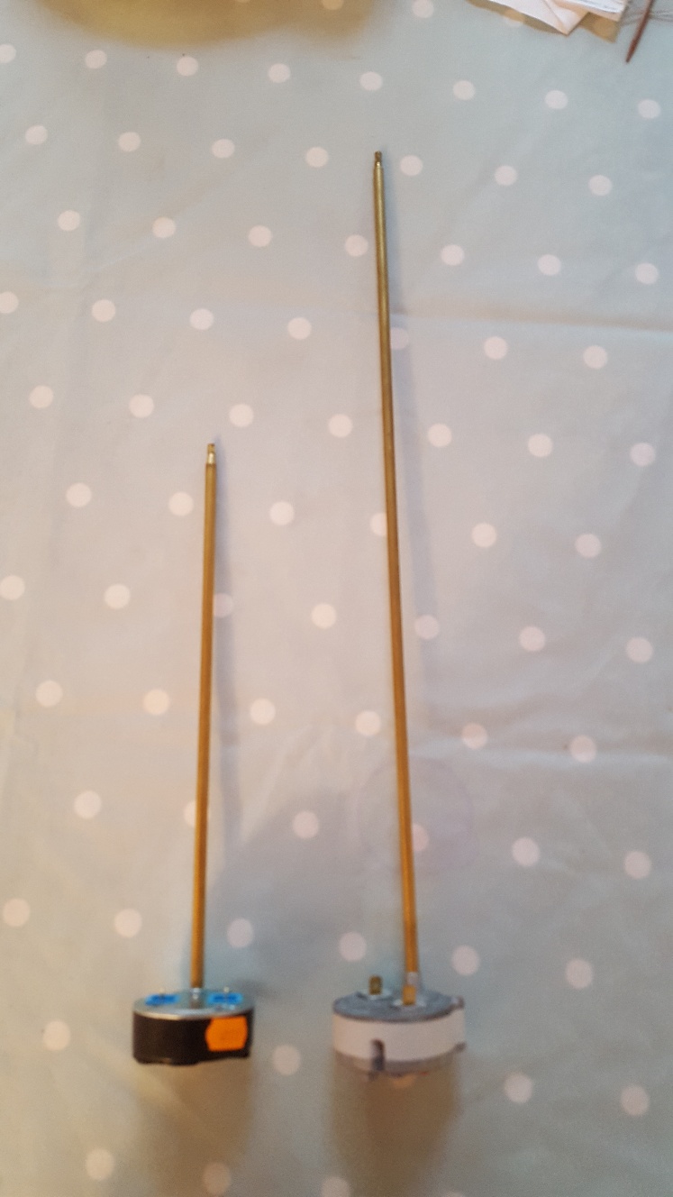

vivienz Posted September 2, 2017 Author Share Posted September 2, 2017 I'm bumping this thread as we're back in France and hoping to get our immersion heater fixed this weekend. We ordered all the bits that arrived just before we left last time and have now taken out the old stat from the tank. Please excuse me for what is a really thick question for the brains on this forum, but we've never done this before. The old thermostat is 450mm and the new one is 270mm - does this matter? I'm guessing that there is a reason for the difference otherwise all thermostats would be the same length, but is it one that means we need to get a 450mm version. Thanks, all. Link to comment Share on other sites More sharing options...
Onoff Posted September 3, 2017 Share Posted September 3, 2017 When you say thermostat I'm guessing you mean the immersion heater elelement length? They do vary in length as I said previously. Can you post a picture? Wasn't the one I thought it might be 470mm long? (So longer than the new one you've got and the same as the old one). Link to comment Share on other sites More sharing options...
Jeremy Harris Posted September 3, 2017 Share Posted September 3, 2017 IIRC, the last immersion thermostat I replaced was around half the length of the immersion heater element, so 270mm sounds about right. That was a long time ago, though, probably well over 20 years ago now. Link to comment Share on other sites More sharing options...
A_L Posted September 3, 2017 Share Posted September 3, 2017 21 hours ago, vivienz said: The old thermostat is 450mm and the new one is 270mm - does this matter? I'm guessing that there is a reason for the difference otherwise all thermostats would be the same length, but is it one that means we need to get a 450mm version. Thanks, all. If the immersion heater is side-entry low down in the tank then no. I however it is a top-entry then there are some complications. If you actually mean the heating element of the immersion heater then they do not heat the water below their lowest point well and obviously the volume heated will be less with a shorter one. If you really do mean the thermostat then the shorter one will switch off when the water higher up reaches the set point leaving the water below it less warm due to stratification, although this effect may be small if the water heated is turbulent and mixes to some extent. Link to comment Share on other sites More sharing options...

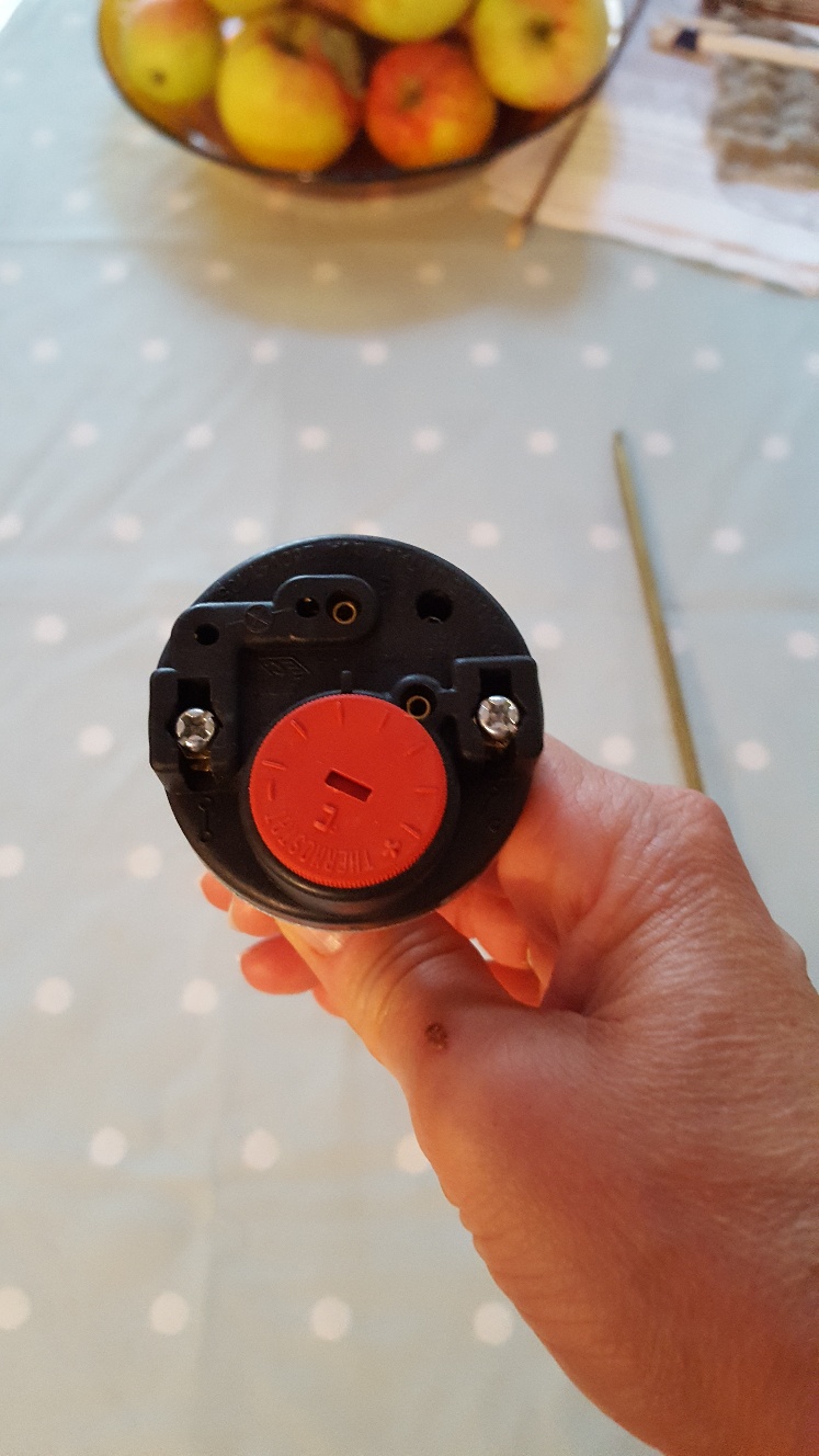

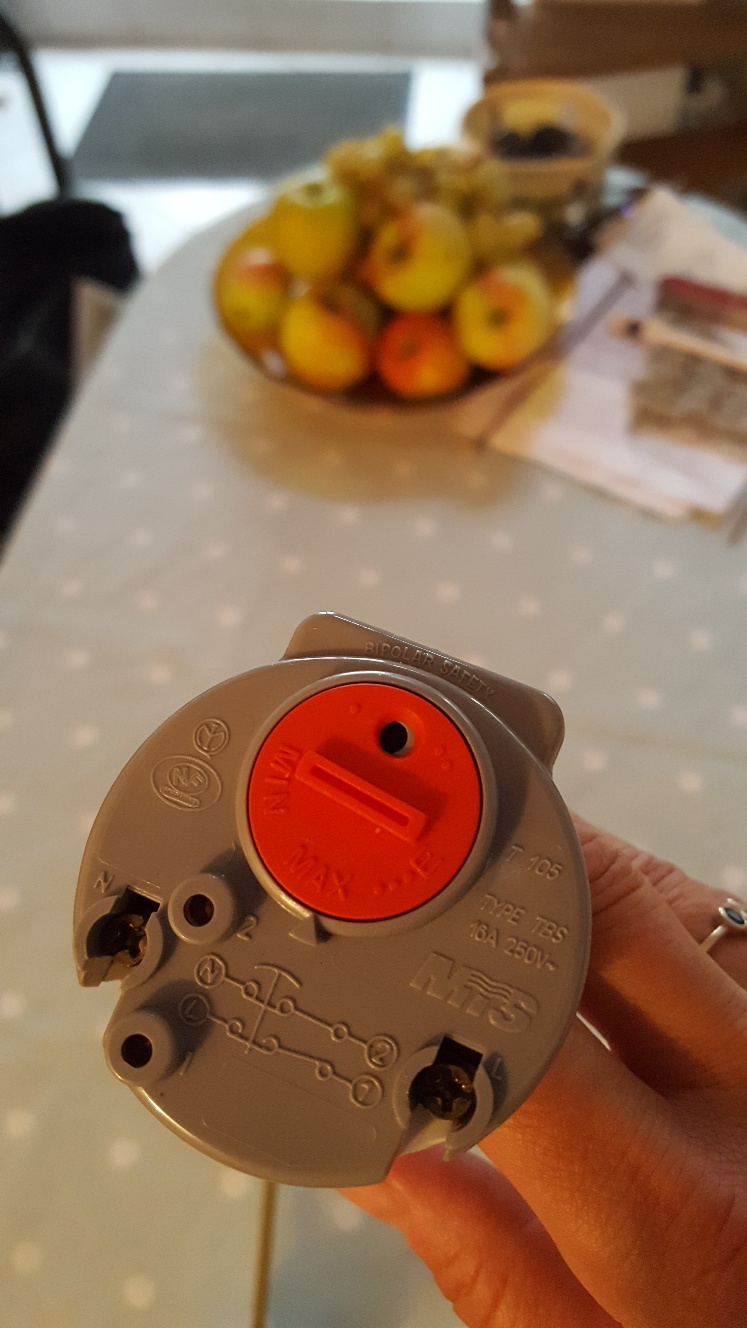

Nickfromwales Posted September 3, 2017 Share Posted September 3, 2017 Can we have a pic of what you have already got and what you've bought . A lot of uncertainty here at the moment of thermostat vs element. An immersion is made up from both. Link to comment Share on other sites More sharing options...
vivienz Posted September 4, 2017 Author Share Posted September 4, 2017 Morning all Here are the photos of what's there now and what we've bought. All the working end/access to the boiler controls are at the bottom of the tank; our access panel is located in the ceiling of the ground floor and the heater itself is in a panelled corner of the upstairs, directly behind the shower. I've looked again at the French plumbing spares site and it does say that the 450mm can be replaced by the 270mm version. Link to comment Share on other sites More sharing options...
Jeremy Harris Posted September 4, 2017 Share Posted September 4, 2017 (edited) If it's at the bottom of the tank then it will make no difference if the thermostat is 450mm or 270mm, it will still be measuring pretty much the same temperature. For those unfamiliar with French tanks, they are often configured very differently to UK ones. I had to repair one at a friends place we used to stay at, and found that the French ones are more like the US ones than UK ones. The one I fixed was enamelled steel, for example, and was horizontal, rather than vertical, and bolted to the inside wall of the garage. Edited September 4, 2017 by JSHarris Link to comment Share on other sites More sharing options...
vivienz Posted September 4, 2017 Author Share Posted September 4, 2017 We've taken the plunge and Mr Vivienz has put the replacement thermostat in and, voila, it's working! Fingers crossed that this means no more cold showers for the time being. Thanks again for all the help and guidance, all. 1 Link to comment Share on other sites More sharing options...
