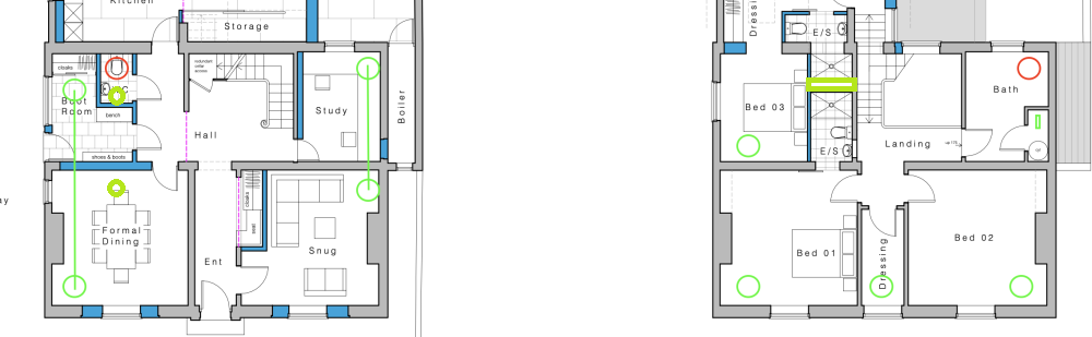

jayc89 Posted November 17, 2022 Author Share Posted November 17, 2022 Having a look at this evening this evening, if I were to install MVHR (the unit would be in the loft), the first floor is simple as all ducting would just drop down from the ceiling. Ground floor, right hand side is also simple, as the ducting can come through the airing cupboard above to service the Study and Snug, but it's the left hand side of the ground floor which is troubling me; I need an extract duct for the W/C and a supply duct for the Boot Room and Dining Room. One solution might be to drop the ducting down the wardrobe in the dressing room above Bedroom 3, but given I need to supply 2x rooms and an extract, it would be quite bulky. Can anyone see any other solution that I'm missing? Link to comment Share on other sites More sharing options...
Radian Posted November 17, 2022 Share Posted November 17, 2022 Could you create a small space between your back to back showers and drop down into the WC, Boot room and formal dining on that line below? Link to comment Share on other sites More sharing options...
Iceverge Posted November 17, 2022 Share Posted November 17, 2022 @Radian beat me to it. Just hide them in the stud walls. Link to comment Share on other sites More sharing options...
Radian Posted November 17, 2022 Share Posted November 17, 2022 1 minute ago, Iceverge said: @Radian beat me to it. Just hide them in the stud walls. To make the idea a bit clearer, here it is shown in thicker green bits: 1 Link to comment Share on other sites More sharing options...
jayc89 Posted November 19, 2022 Author Share Posted November 19, 2022 That could work. We're not putting in the 2x new showers until the extension is up, but we are fitting IWI to the existing rooms prior to that so I could fit the ducting in the floor void just leaving an up-stand to join beneath where that stud wall will eventually be fitted. Link to comment Share on other sites More sharing options...
Radian Posted November 19, 2022 Share Posted November 19, 2022 17 minutes ago, jayc89 said: That could work. We're not putting in the 2x new showers until the extension is up, but we are fitting IWI to the existing rooms prior to that so I could fit the ducting in the floor void just leaving an up-stand to join beneath where that stud wall will eventually be fitted. I forgot to put a vent position in the boot room - on the run between WC and Dining room, but I'm sure you already spotted that. 1 Link to comment Share on other sites More sharing options...
