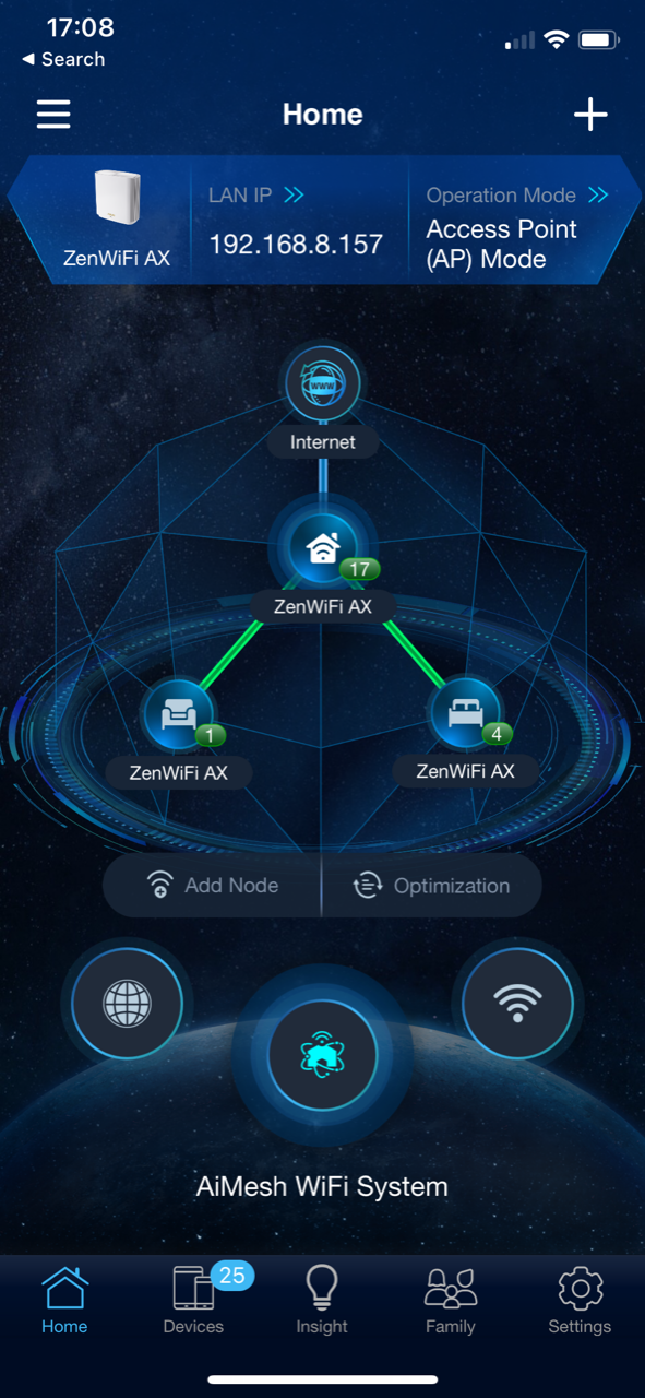

Pocster Posted November 15, 2022 Posted November 15, 2022 Tried ubiquiti , then orbi - no joy . ASUS though - perfect !

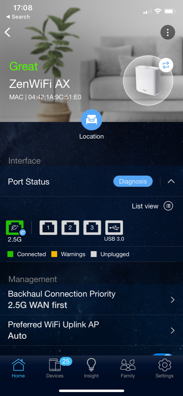

Pocster Posted November 15, 2022 Posted November 15, 2022 (edited) 21 minutes ago, Triassic said: I have the wiring in place but no idea how to set up access points. Ir's easy. With Asus for example you just run a cat5 to each hub - then back to the central hub ( not through a switch ) then into your router. You've then got a wired wifi access point. You then change the mode of Asus to access point - that's pretty much it. So in Asus futuristic looking app - you can see what's connected (wired or wifi ) and you can see that the backhaul is also wired. Depending on your house though you may need numerous hubs - I manage well with 3. Edited November 15, 2022 by pocster
