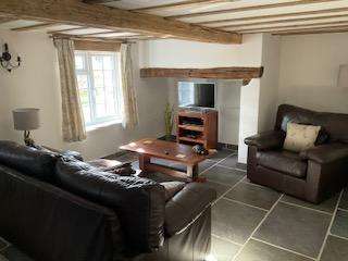

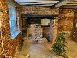

After more than 6 months since the floor went down, ive finally got it connected. Not me, a nice plumber chap.
Why have i never done this before. Bloody fantastic.
Everyone should have it!
Gratuitous before and after shots.

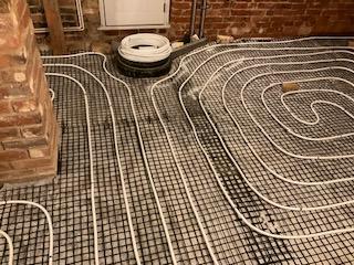

what is the mesh system ..? Not seen that before ..?

Because its old, ie 9 inch walls, no dpc etc, under that is a geocell/foamed glass bed. The chaps doing the limecrete that went over it put it there. Part of their system. I then laid the water pipes before they came back and laid the floor.
Compared to most of what goes on here, its a thermal catastrophe, but options were limited given the construction and the possibility of flooding.

Yes that  new to me too.
It looks similar to a small grid geotextile fabric.
Now we put polypropylene firbres (usually non structural) in slabs to stop shrinkage. @saveasteading et al have posted lots about this. Plastic fibres in concrete slabs with UFH above.
Can see how this could work but would love to know more about this and see some data / calcs / design rational.

The issue before i started was concrete slab over DPM creating wet walls with gypsum plaster over. Creating the same again wasnt happening. The arrangement is basically the same as this: https://www.lime.org.uk/products/sylfaenr-foundation-system.html
The walls are lime plastered both to allow the wall to breate, and also to allow it to dry if it gets wet in a flood.
I know there are wildly differing opinions on this, but removing the concrete/dpm and gypsum plater fixed all the damp issues in my house. quickly. I know what i see. But ultimately, keeping things damp free, and not not having to strip off plaster post flood meant that the thermal performance came a poor second.
No idea what the power loss is. Didnt worry about it as theres nothing i can do about it. Just concentrated on the detaling to make as  draught free as poss. For reference its a 9 inch wall with lime plaster on the inside and unknown render on the outside.
