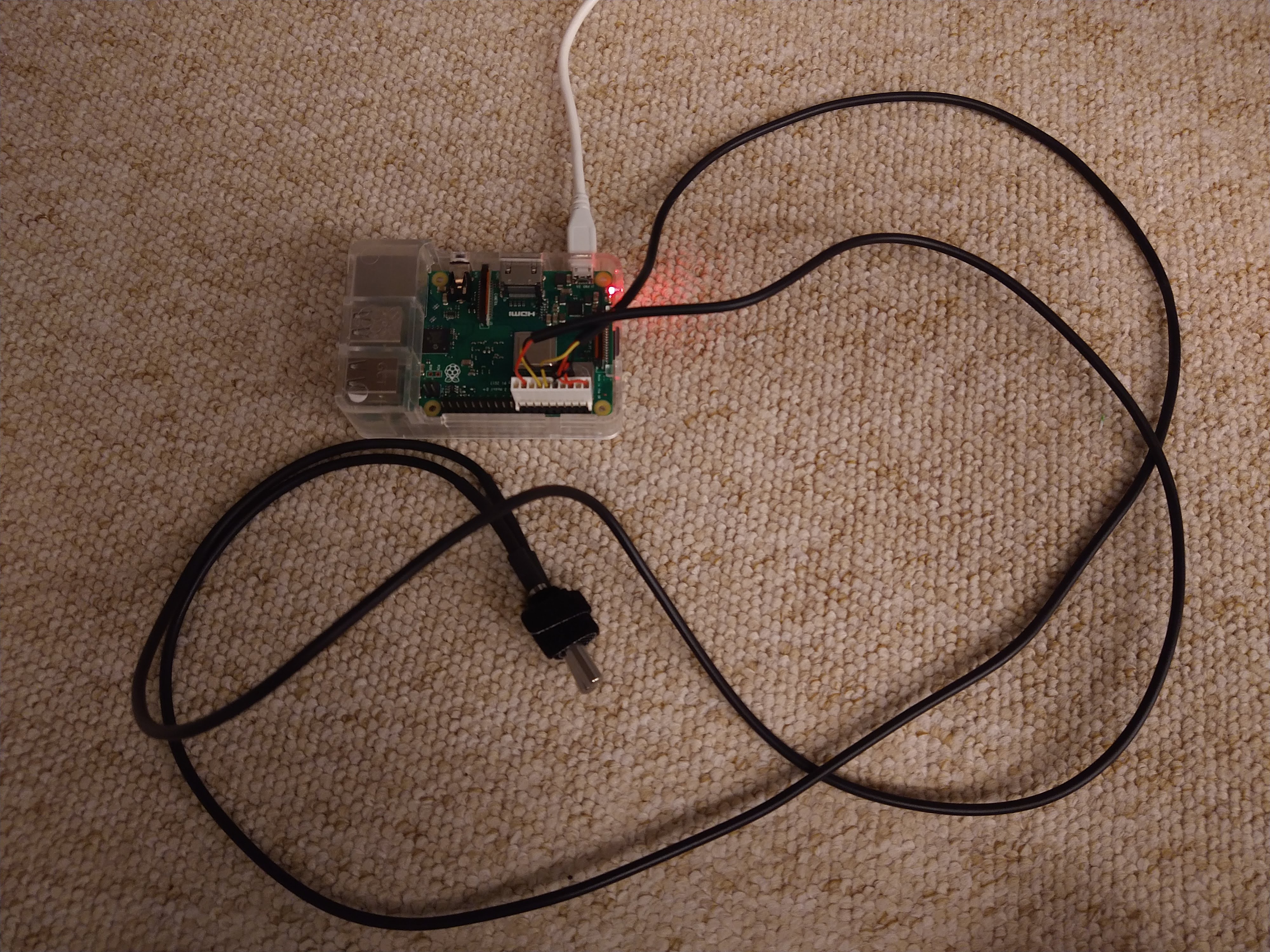

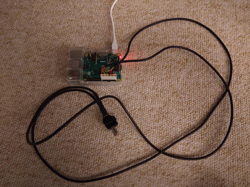

Radian Posted February 4, 2023 Share Posted February 4, 2023 43 minutes ago, IanR said: They've a new version which can take an SD card for simpler data transfer. It also appears to include the Bluetooth module. Works out around £75 incl. VAT and delivery for an 8Ch temp logger. Funny coincidence, today I hooked up a Raspberry Pi with a pair of 1-wire sensors to make a radiator balancing kit. 8 sensors would be equally do-able: This one is wirelessly sending the readings over MQTT to a client app on my phone for the display. Will be strapping the Pi to a USB battery bank for moving it from rad to rad. Link to comment Share on other sites More sharing options...

TerryE Posted February 7, 2023 Share Posted February 7, 2023 On 04/02/2023 at 22:24, Radian said: Funny coincidence, today I hooked up a Raspberry Pi with a pair of 1-wire sensors to make a radiator balancing kit. 8 sensors would be equally do-able: You can daisy chain up to around 20 DS18B20s quite happily, though you may want to use overlayFS and Log2RAM if you are using an SD card as your system device. A battery backup hat (PiHut has few) might also be useful as well as a strip board hat if you want to bring all of your OW devices back to a central connection board Link to comment Share on other sites More sharing options...
