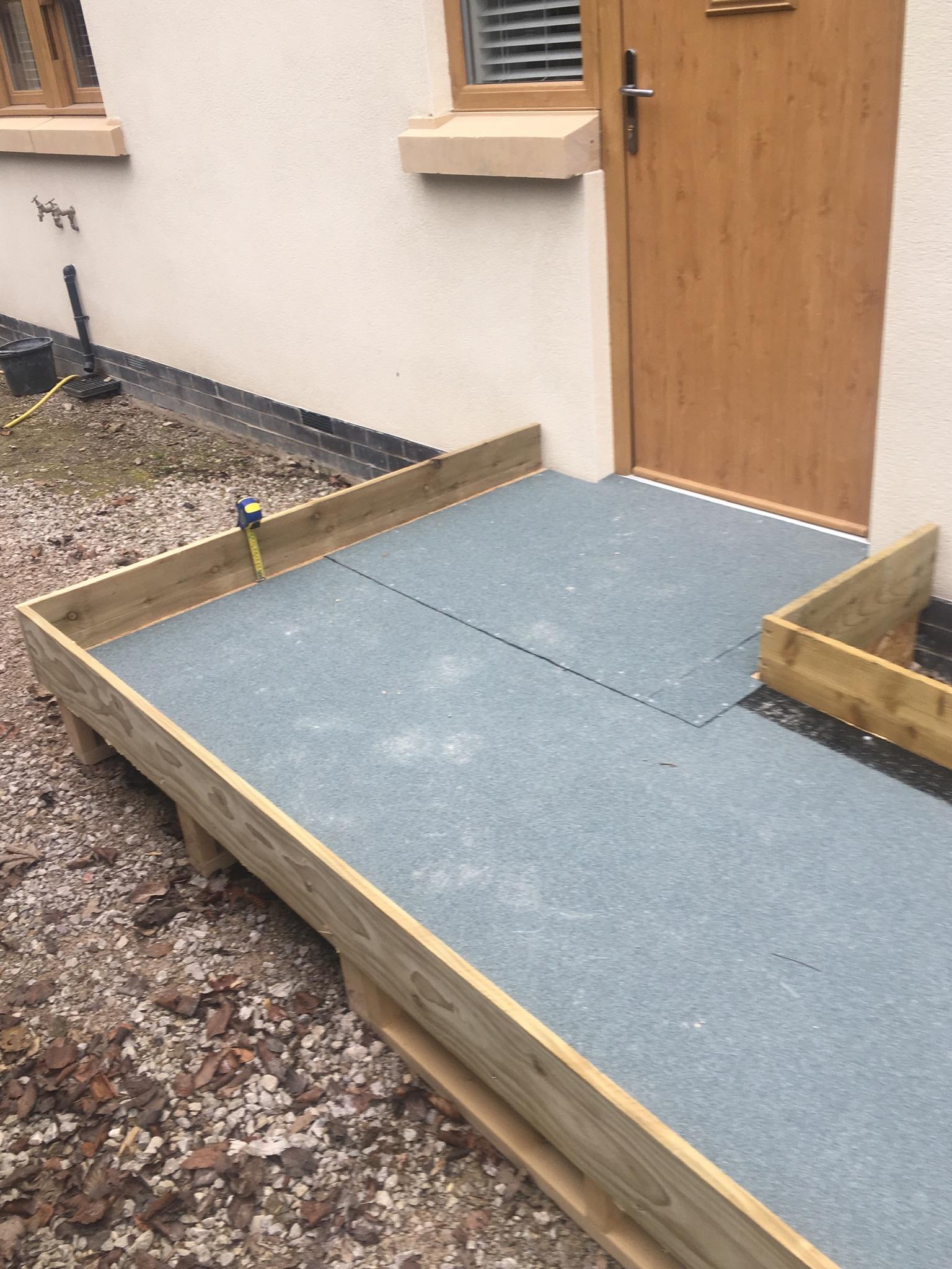

Happy Valley Posted November 3, 2022 Posted November 3, 2022 Building Control are asking how we are going to deal with this as the tarmac will be approx 150mm from the inside finished floor level. Does the "Level Approach" allow for a 150mm step? Don't fancy having to tarmac over the DPC level to build a ramp. What are my options please (house is in England)
ProDave Posted November 3, 2022 Posted November 3, 2022 Some BC's will accept a wooden ramp on top of the tarmac as long as it is fixed in place. Ask him. Ours in Scotland did, which some say never happens. 1
nod Posted November 3, 2022 Posted November 3, 2022 We did a wooden ramp on our last one and moved after he had gone 2
