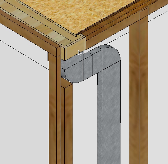

Barney12 Posted June 28, 2017 Author Posted June 28, 2017 (edited) Resorted to bit of quick Sketchup Edited June 28, 2017 by Barney12
Nickfromwales Posted June 28, 2017 Posted June 28, 2017 If that's the chosen method then I'd form the letterbox outlet from grp ( formed with a with an off cut of that rectangular section ) rather than a round former. Looks like it'll work fine TBH. ? Edit : Don't use silicone on any of this stuff as it has a very short life . CT1 or Sikaflex ?
Barney12 Posted June 28, 2017 Author Posted June 28, 2017 1 minute ago, Nickfromwales said: If that's the chosen method then I'd form the letterbox outlet from grp ( formed with a with an off cut of that rectangular section ) rather than a round former. Looks like it'll work fine TBH. ? Yep that was my plan and a grp 'male' connection that will sit down into the 'female' of first bend. I'll then bond it using the Sicoflex you mentioned before. The other joints will be solvent welded.

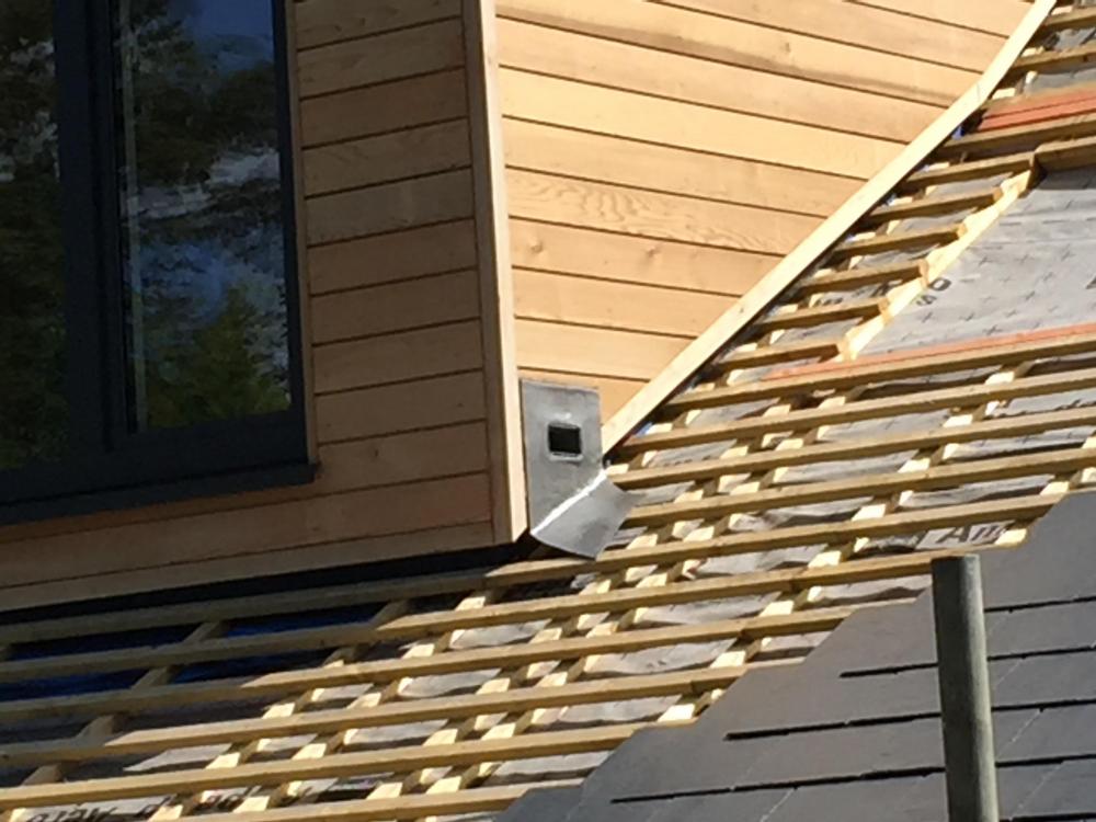

Ferdinand Posted June 28, 2017 Posted June 28, 2017 (edited) Why the right angle kink? That looks like an excellent hidden trip point for blockages. I think you want something you can get drainage rods through from both ends if necessary. Or perhaps a chimney brush. Rodding or jetting points? Minimum radius to follow that of drains? I think I would argue for a longer grp section with a suitable kink to join a little lower, or moving the letterbox section to make say 30-45 degree the maximum angle. I would also consider making that section if cladding relatively removable just in case. It is up in the air so people may not look too closely. Vertical scarf joint and coach screws on that particular batten (or us it counterbatten!), and stainless screws for the cladding? Or mount the whole vertical slice of cladding and batten on a hook or two? Even a plastic batten if lighter? F Edited June 28, 2017 by Ferdinand
Barney12 Posted June 28, 2017 Author Posted June 28, 2017 27 minutes ago, Ferdinand said: Why the right angle kink? No choice as it has to move away from the corner cladding detail. Can't move the letterbox "up" the slope, that wont work! Its still easily rodded with a flexi wire. I might see if two 45 degrees and a short join works better though.
PeterW Posted June 28, 2017 Posted June 28, 2017 Pair of 45 bends is the way to go .... one at each end too ..??
Ferdinand Posted June 28, 2017 Posted June 28, 2017 1 hour ago, Nickfromwales said: If that's the chosen method then I'd form the letterbox outlet from grp ( formed with a with an off cut of that rectangular section ) rather than a round former. Looks like it'll work fine TBH. ? Edit : Don't use silicone on any of this stuff as it has a very short life . CT1 or Sikaflex ? You could GRP the join.
Nickfromwales Posted June 28, 2017 Posted June 28, 2017 2 hours ago, Ferdinand said: You could GRP the join. A bit brittle for one, and you'll need to do a bonded join somewhere as they're ( the roof and the down'pipe' ) dissimilar materials.
Barney12 Posted June 28, 2017 Author Posted June 28, 2017 (edited) 2 hours ago, Nickfromwales said: A bit brittle for one, and you'll need to do a bonded join somewhere as they're ( the roof and the down'pipe' ) dissimilar materials. Agreed. There is nothing better than a 'male' to 'female' union as long as you've got a bit of flex Edited June 28, 2017 by Barney12
Barney12 Posted June 28, 2017 Author Posted June 28, 2017 10 minutes ago, Nickfromwales said: That ship has sailed Sailed? Mines bloody lost at sea! 1
Onoff Posted June 29, 2017 Posted June 29, 2017 I see and get peripherally involved in "guttering" on commercial buildings. You need to be bloody careful that where you have hidden, male into female joints that they're watertight. I repeatedly see blockages further down the line, backing up, and there's no second line of defense. It overflows the joint and water enters the building! Regular rodding / maintenance is essential.
PeterW Posted June 29, 2017 Posted June 29, 2017 I think in this case the gutter and pipe is on the outside of the building but behind the cladding however I agree it does need careful design to stop any opportunity for blockages to cause issues. I would put one either end just to be on the safe side.

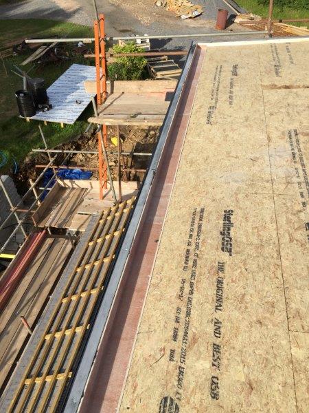

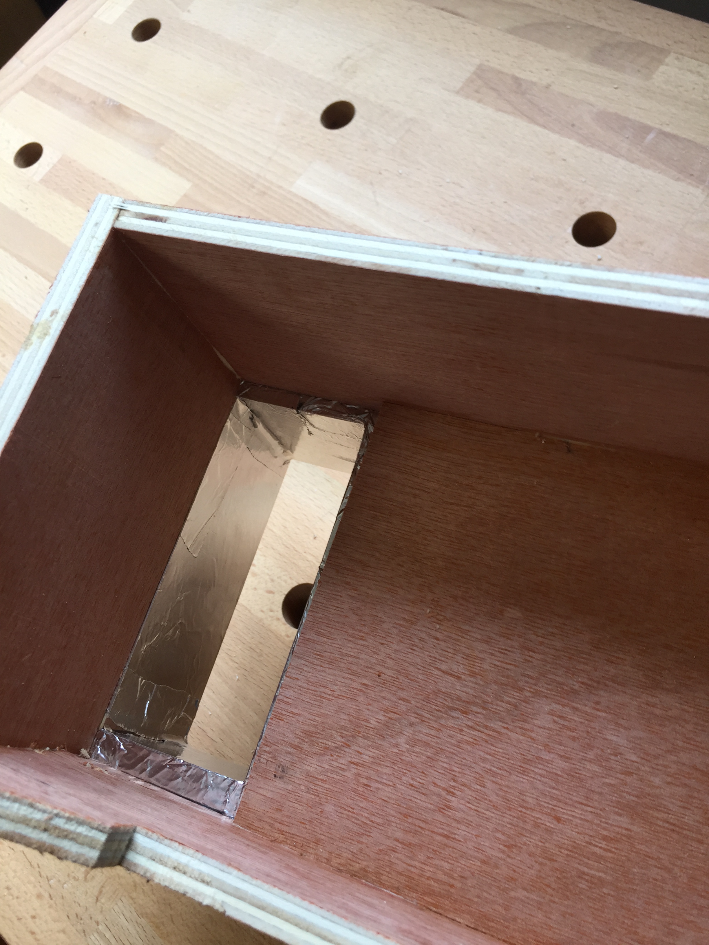

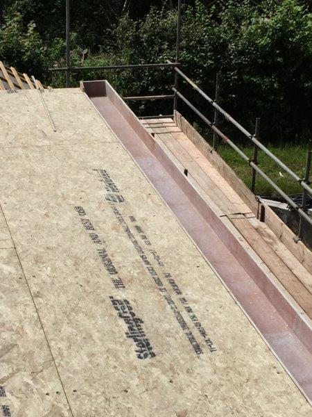

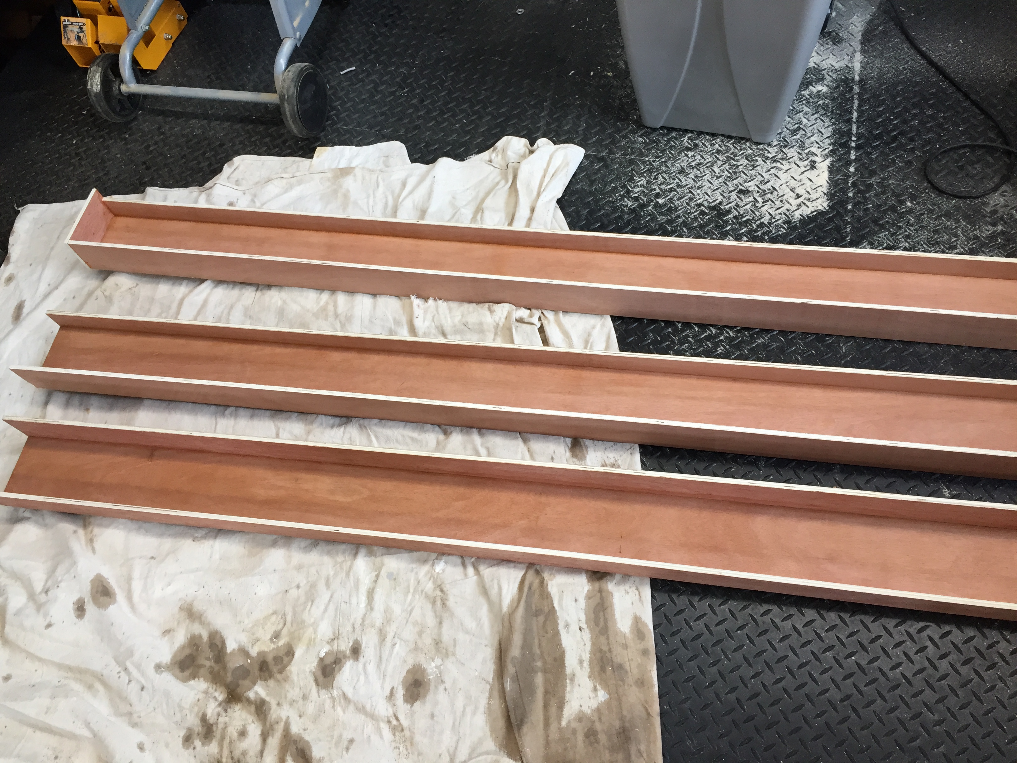

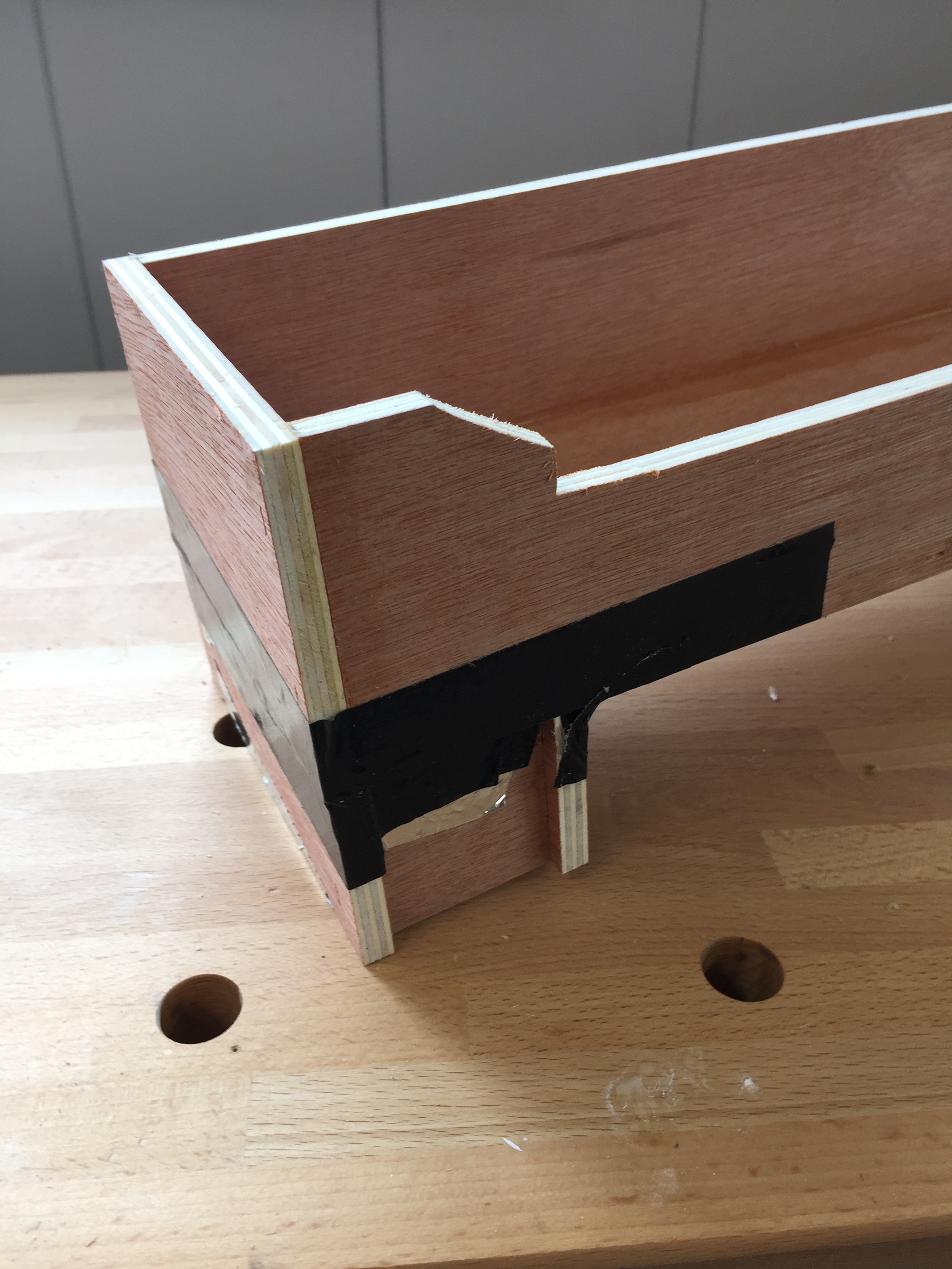

Barney12 Posted June 29, 2017 Author Posted June 29, 2017 Pre-made the gutter sections today in the workshop. The bottom section to make the 'male' is just a former that will be removed (hence the foil and the duct tape).

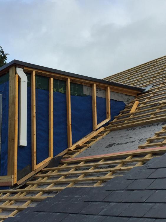

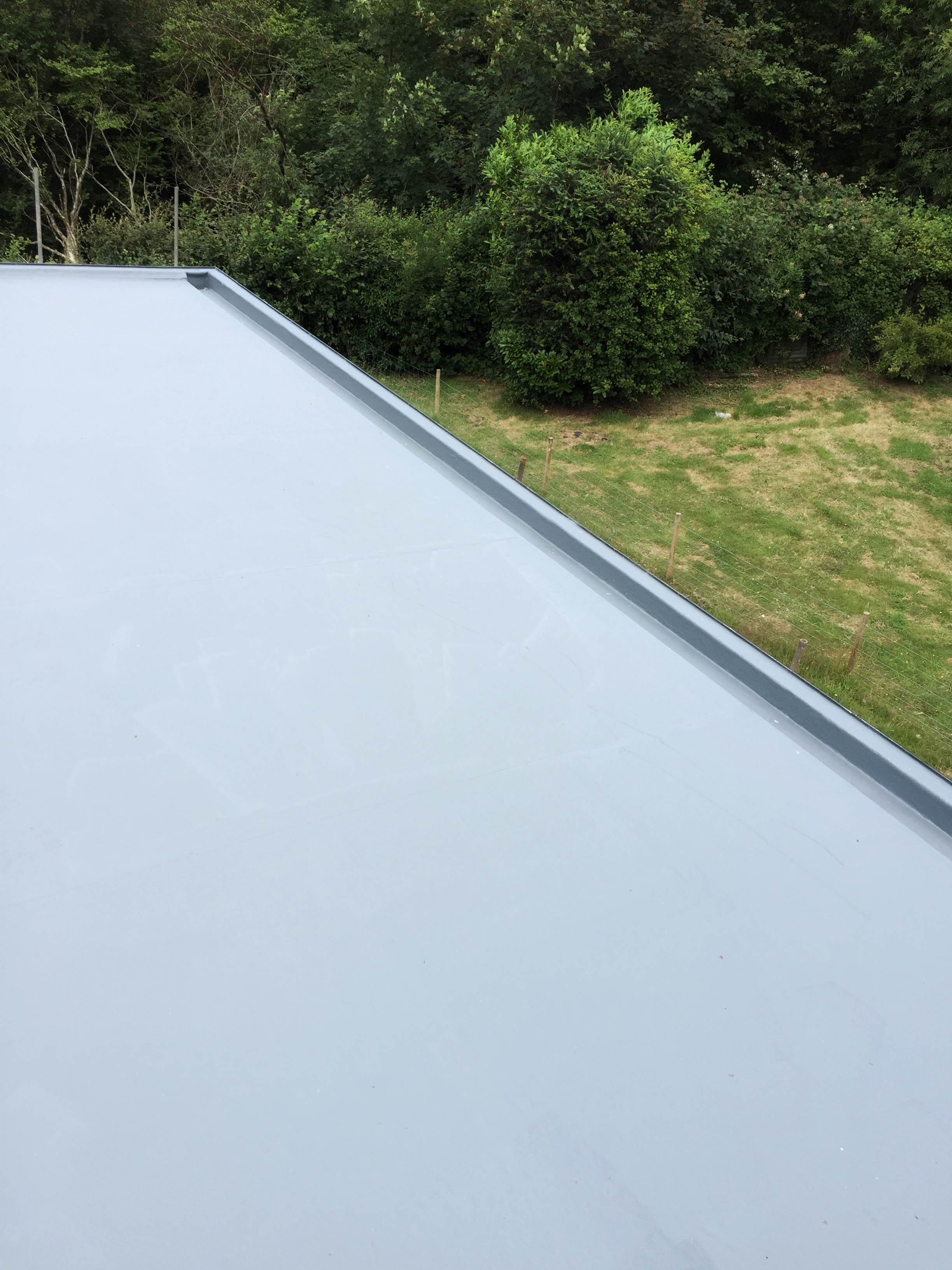

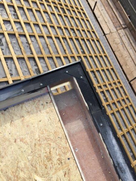

Barney12 Posted July 16, 2017 Author Posted July 16, 2017 5 minutes ago, PeterW said: Very neat ..! Use a kit ..? I made all the formers and upstands by hand from machined timber. The GRP roof materials are Metrodeck from CFS Fibreglass. Im told it will last 50 years, which is handy as I won't live anything like that long
