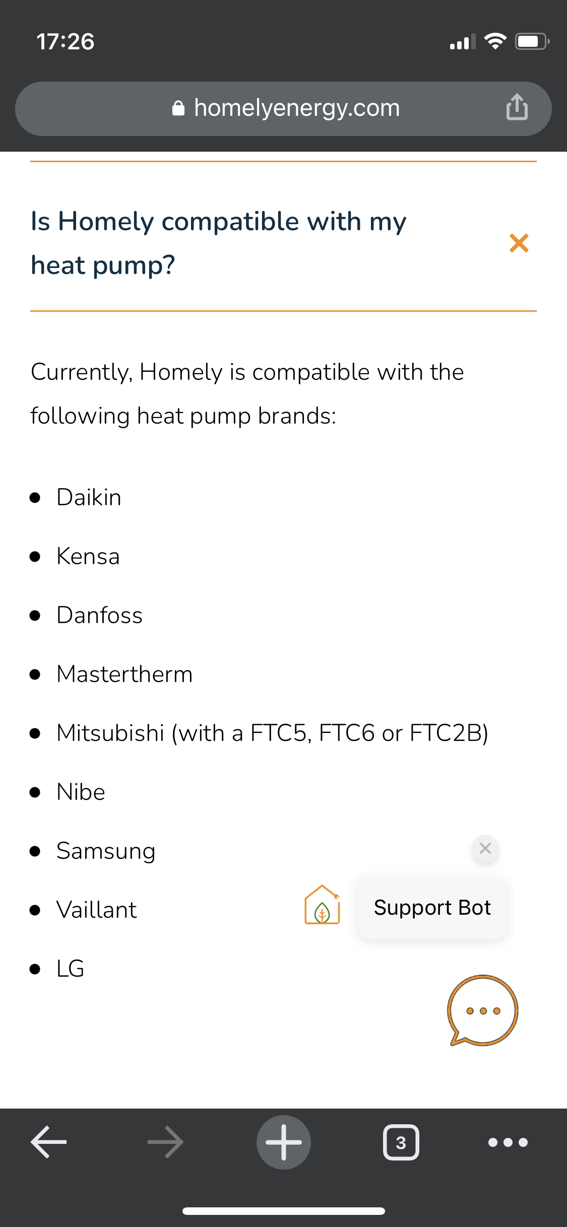

Dreadnaught Posted October 28, 2022 Posted October 28, 2022 18 hours ago, HughF said: Throw the timeclock and room stats in the bin, install Homely, set your room temperature... Is Homely compatible with my heat pump? Currently, Homely is compatible with the following heat pump brands: Samsung (model number beginning with AE, manufactured post 2015) Midea We are always looking to expand the list of compatible heat pumps so please do check back if yours is not currently showing. https://help.homelyenergy.com/knowledge/is-homely-compatible-with-my-heat-pump

HughF Posted October 28, 2022 Posted October 28, 2022 7 hours ago, Dreadnaught said: Is Homely compatible with my heat pump? Currently, Homely is compatible with the following heat pump brands: Samsung (model number beginning with AE, manufactured post 2015) Midea We are always looking to expand the list of compatible heat pumps so please do check back if yours is not currently showing. https://help.homelyenergy.com/knowledge/is-homely-compatible-with-my-heat-pump

Kevm Posted October 29, 2022 Posted October 29, 2022 13 hours ago, HughF said: Hmmm, the conflicting information on the Homely site puts me off right away. I think the key word here is 'compatible'. My £90 wireless stat is 'compatible' with my Ecodan in that it can connect to the controller and switch it on and off. Homely can work like a standard room stat too and I suspect that's what the long list of compatible manufacturers refers to. I think the clever integration is currently only Samsung and Midea. 1
HughF Posted October 29, 2022 Posted October 29, 2022 12 minutes ago, Kevm said: Hmmm, the conflicting information on the Homely site puts me off right away. I think the key word here is 'compatible'. My £90 wireless stat is 'compatible' with my Ecodan in that it can connect to the controller and switch it on and off. Homely can work like a standard room stat too and I suspect that's what the long list of compatible manufacturers refers to. I think the clever integration is currently only Samsung and Midea. Yeah it’s not ideal… I’ll get onto them and ask what’s going on.
