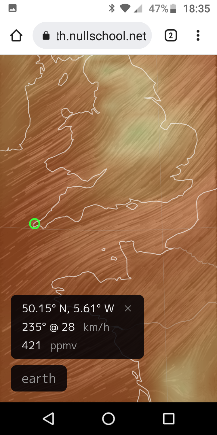

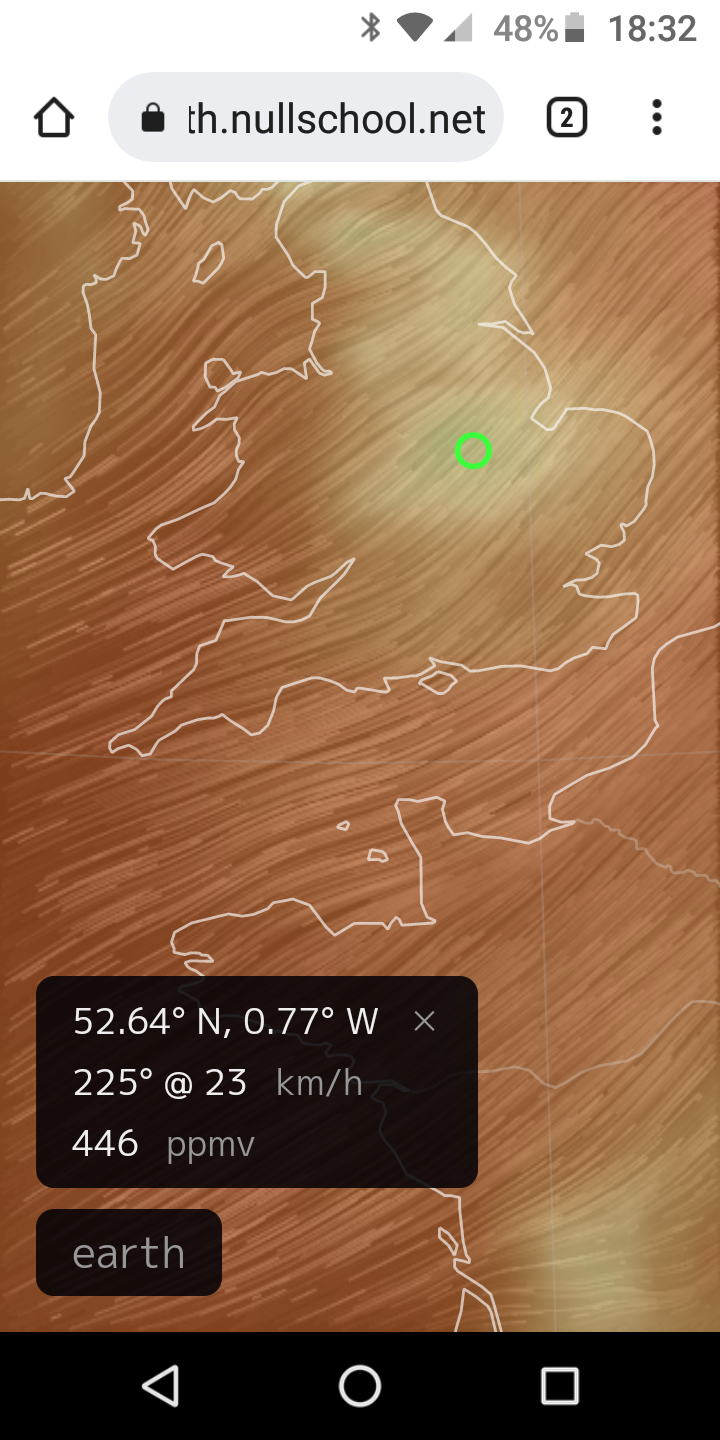

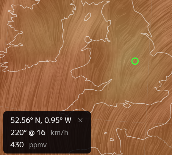

SteamyTea Posted October 24, 2022 Posted October 24, 2022 Are you talking about dMVRH? Why do you think the CO2 levels are too high, and why are they talking a long time to reduce. What is the humidity like in the troublesome places? Have you calibrated the CO2 meter? Stick it outside and it should read about 420ppm, though you are in a dirty part of the country, so maybe a little higher.
SteamyTea Posted October 24, 2022 Posted October 24, 2022 And just for a laugh 421ppm here. No dirty Welsh air.
Ferdinand Posted October 25, 2022 Author Posted October 25, 2022 14 hours ago, Radian said: Do you have a central hallway that has an open stairway to the first floor rooms? Yes - but it's not one with the hall and landing stacked in the same space. Staircase runs off at right angles to the hall.
Ferdinand Posted October 25, 2022 Author Posted October 25, 2022 13 hours ago, SteamyTea said: Why do you think the CO2 levels are too high, and why are they talking a long time to reduce. Via a not very expensive CO2 meter, which is reporting values up to the 000s in the kitchen. Reduction is slow ie hours - but quicker when ventilation applied, such as an open window or a cooker hood on max. 13 hours ago, SteamyTea said: What is the humidity like in the troublesome places? Humidity has been normal. I have RH meters in the room as routine. 13 hours ago, SteamyTea said: Have you calibrated the CO2 meter? Stick it outside and it should read about 420ppm, though you are in a dirty part of the country, so maybe a little higher. It reads roughly that - 440. Will try it outside. It is one of these, which is cheap so I mogjht be inclined to get a better one before I commit to spending money. However, ventilation is arguably inadequate anyway - there is no kitchen extractor other than the cooker hood: https://www.amazon.co.uk/gp/product/B09MJ8KPZK F
SteamyTea Posted October 25, 2022 Posted October 25, 2022 35 minutes ago, Ferdinand said: It reads roughly that - 440. Will try it outside. About right then.
