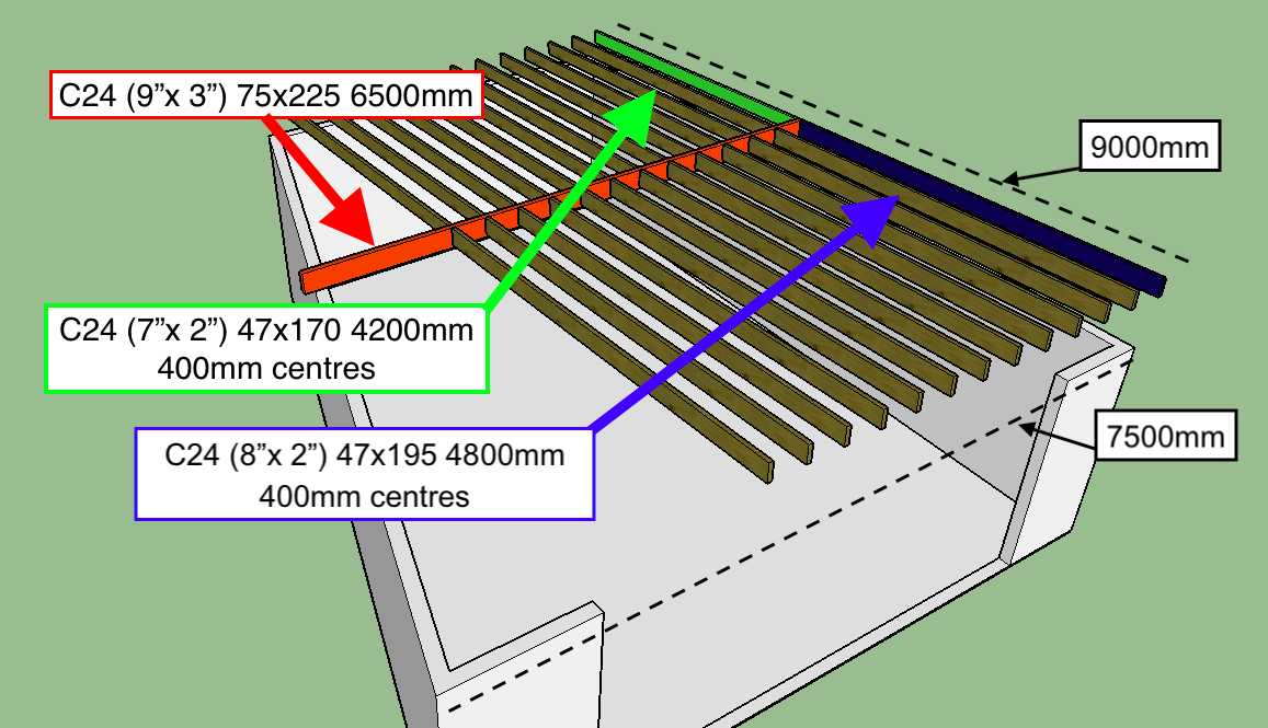

Russdl Posted October 24, 2022 Posted October 24, 2022 The plan is to build a garage sometime next year. Irregular shape to fit the tapering plot and low height to comply with Permitted Development. I want it about 9m deep. About 5m wide at the back (narrow end) and about 7.5m wide at the front. The first question that I have is how do I construct the flat-ish roof? Can I do it all in C24 as per the image below? Or does the red C24 in the image have to be a steel or something else? TIA.
markc Posted October 24, 2022 Posted October 24, 2022 At 6.5m a 9x3 will struggle to hold itself up and definitely not the rest of the roof plus a big snow load (flat roof and presumably insulated) 1
joe90 Posted October 24, 2022 Posted October 24, 2022 I think an SE would need to give advise on this, yes snow loading is a real thing (till we get some decent global warming 🤣). 1

Temp Posted October 24, 2022 Posted October 24, 2022 Even running the rafters the other direction would give a 7.5m span. Think that's much bigger than the standard Trada span tables cover.
Conor Posted October 24, 2022 Posted October 24, 2022 I think you'll need to swap the central 7x2 with a steel, something like a 203x102.
Russdl Posted October 24, 2022 Author Posted October 24, 2022 So, if the red joist becomes an RSJ am I on the right track? Or could I use an LVL I joist? Or a pultruded GRP 'I' beam?

Russdl Posted October 24, 2022 Author Posted October 24, 2022 3 minutes ago, Conor said: I think you'll need to swap the central 7x2 with a steel, something like a 203x102. I'm trying to steer clear of the steel, difficult access etc, but it may come to it.

Russdl Posted October 24, 2022 Author Posted October 24, 2022 I like glulam for the reasons @joe90 mentioned but I think for what I’ll need it would be big and heavy. I’ve just been informed that a GRP ‘I’ beam at 6.5m would be “difficult and expensive” (the standard size is 6m). I guess I’m looking at an RSJ, just don’t want one.
Temp Posted October 24, 2022 Posted October 24, 2022 If we assume a steel across the middle the rafters end up about 4.5m span. The old Trada table I have suggest rafters would be something like 47 x 220 C16 on 400mm spacing. 1
joe90 Posted October 24, 2022 Posted October 24, 2022 9 minutes ago, Russdl said: I like glulam for the reasons @joe90 mentioned but I think for what I’ll need it would be big and heavy. I guess it depends on what the SE decides, large glulams can be beautiful (IMO). Not sure about being heavier than a steel 🤔. I put 8 of them in a loft conversion once and just the two of us, no sweat. 1
Mr Punter Posted October 24, 2022 Posted October 24, 2022 You could consider a flitch beam, using 10mm steel plate sandwiched between two timbers, bolted every 400mm. A fair bit lighter than an equivalent steel beam or column section and you can fit joist hangers easily. 1
Russdl Posted October 24, 2022 Author Posted October 24, 2022 1 hour ago, Mr Punter said: You could consider a flitch beam Can you enlighten me? Is that exactly as you describe, sounds good to me if so. 2 hours ago, Temp said: If we assume a steel across the middle the rafters end up about 4.5m span My drawing shows slightly off centre so that the joists (rafters) at the narrow end of the garage wouldn't be so deep, but actually its only 1" so a bit of a pointless exercise from me.
Russdl Posted October 24, 2022 Author Posted October 24, 2022 Google enlightened me about flitch beams. Would I be right in thinking I would have to attach timber to an RSJ anyway if I used one, to hang the rest of the roof off - or is there another way? If that would be required, then the flitch beam has moved to the top of the pile.
joe90 Posted October 24, 2022 Posted October 24, 2022 (edited) 15 minutes ago, Russdl said: Would I be right in thinking I would have to attach timber to an RSJ anyway Not necessarily, you could fit the timbers into the web. Saves having joist hangers. Edited October 24, 2022 by joe90 1
markc Posted October 24, 2022 Posted October 24, 2022 No specific need to attach timber into a UB or UC steel, depending on steel section size and joists being fitted it can be easier to fit into the web and sit on bottom flange. Flitch beams look great if on show and are easy to put together but need to be deeper than a UB or UC for given span and deflection 1
